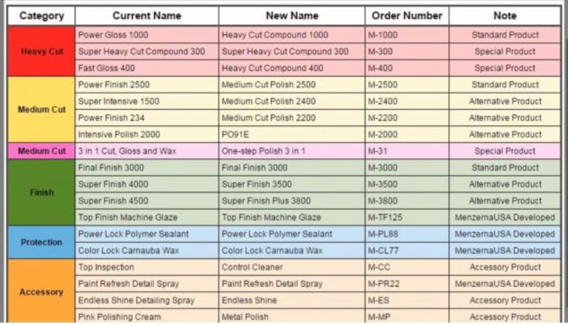

    You might find this Menzerna chart helpful. I've been researching Menzerna for about 4 hours tonight. You prob know more than I do, but if you have any questions, I might be able to direct you to an AG thread. I've read a lot of them in the last week and bookmarked several to go back to. I might have some questions for you, too.
