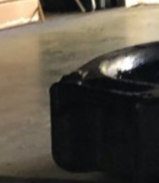

    Yep. I made that mistake once. Made one hell of a mess. I immediately took out my Spyderco and cut the top off of it and turned it into a proper pan lol.

    Oh wow, what a mess in this OP. But I can’t say it’s never happened to me. It only takes one, just one slip and you’re in for a long day lol!
    A good large pan as suggested will help mitigate spills, I use a large plastic tarp under an old flat cardboard piece for extra protection too.
