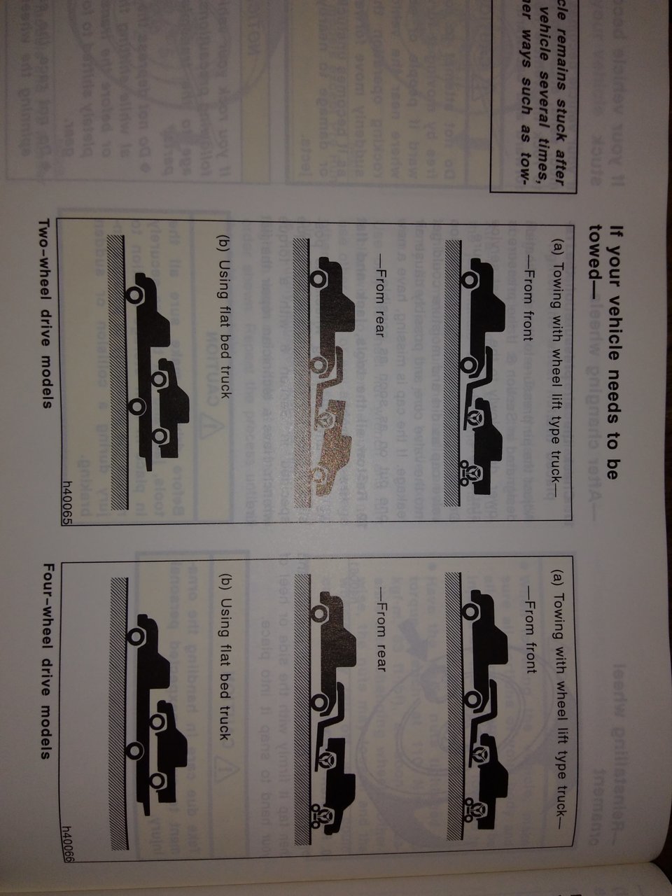

    Check owners manual if you have it. Photo is from 03 4WD Tacoma owners manual Emergency Towing.IMG_20191010_152125225.jpg

    Originally Posted by Marlin Crawler
    On all auto chain driven and manual gear driven t/cases, if it is towed in two wheel drive, the output shaft will turn, but there will be no way for the oil at the bottom of the case to get to the top where the output shaft is. On the chain driven cases, the input shaft turns the planetary housing which drives the oil pump. Gear driven cases use the input gear and low range gears to throw oil on the inside of the housing that collects the oil via gutters and directs it to the rear of the case by gravity. Both style of cases, must have the input shaft spinning to lube the output shaft, speedo gears, and rear seal of the t/case. The rear driveshaft must be removed.Marlin

    Stock. EZ pass.Dump pass.Inspection sticker.Convict printed lic.plates.FG cap.
    Toyota motor co. Says none of their trucks can be towed flat. But what do they know ?

    Tacoma TRD double cab 4x4, Barcelona Red
    Here’s what I think, it appears none of us (including me) really absolutely definitively knows the answer to your question. I think the best you can do is go by what the owners manual says. Unless it states it’s ok to flat tow your truck then you shouldn’t flat tow it.

    I see the bad "Tow it flat transfer case in neutral" advice has been deleted by numerous previous posters.

    The vehicle in question is an '84.
    Not a 2020, not a '14, not an '04, not even a '94.
    It was made before the birth of 98% of the people who use this forum.
    NEUTRAL AND FLAT IS FINE.
