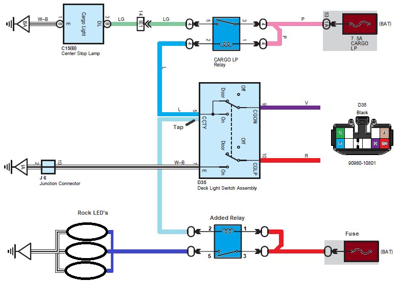

    No need for a DSIM gadget if you connect the added LED to the Cargo Lamp switch. You'll need an additional relay for the added Rock LED's. Attach the relay same as the relay to the Cargo Lamp. Whatever position you leave the Cargo switch the added LED will do the same.

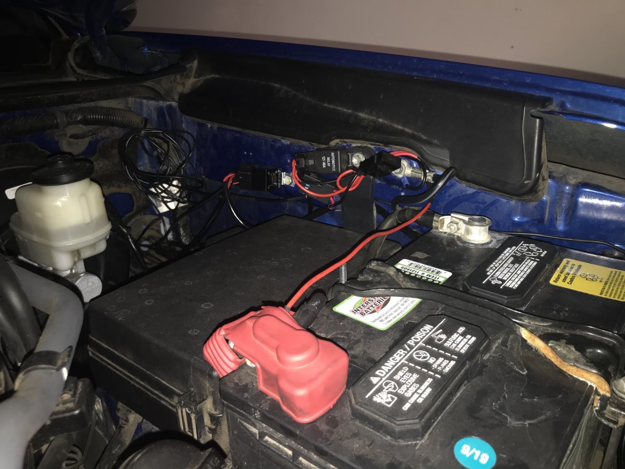

    Anyways, I would use a wire harness like this, in the post above, 15 bucks on Amazon. I have two of them now. I use them with the Cali Offroad switches. I ran one power wire, off the battery, to both harness. Probably a cleaner way to do it. If I run any more harnesses I will have to look into it. ...hang on I will get a photo of the harnesses, probably get some chuckles.

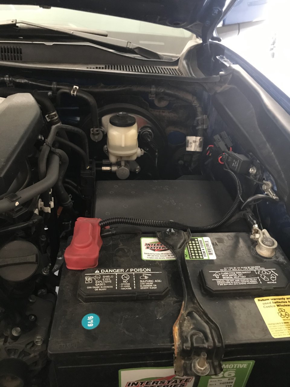

    Not fancy but it works. I guess, looking at the photo, I could at least clean up some of that excess wire.

    A little better, I am gonna have to install an auxiliary fuse box fairly soon.
