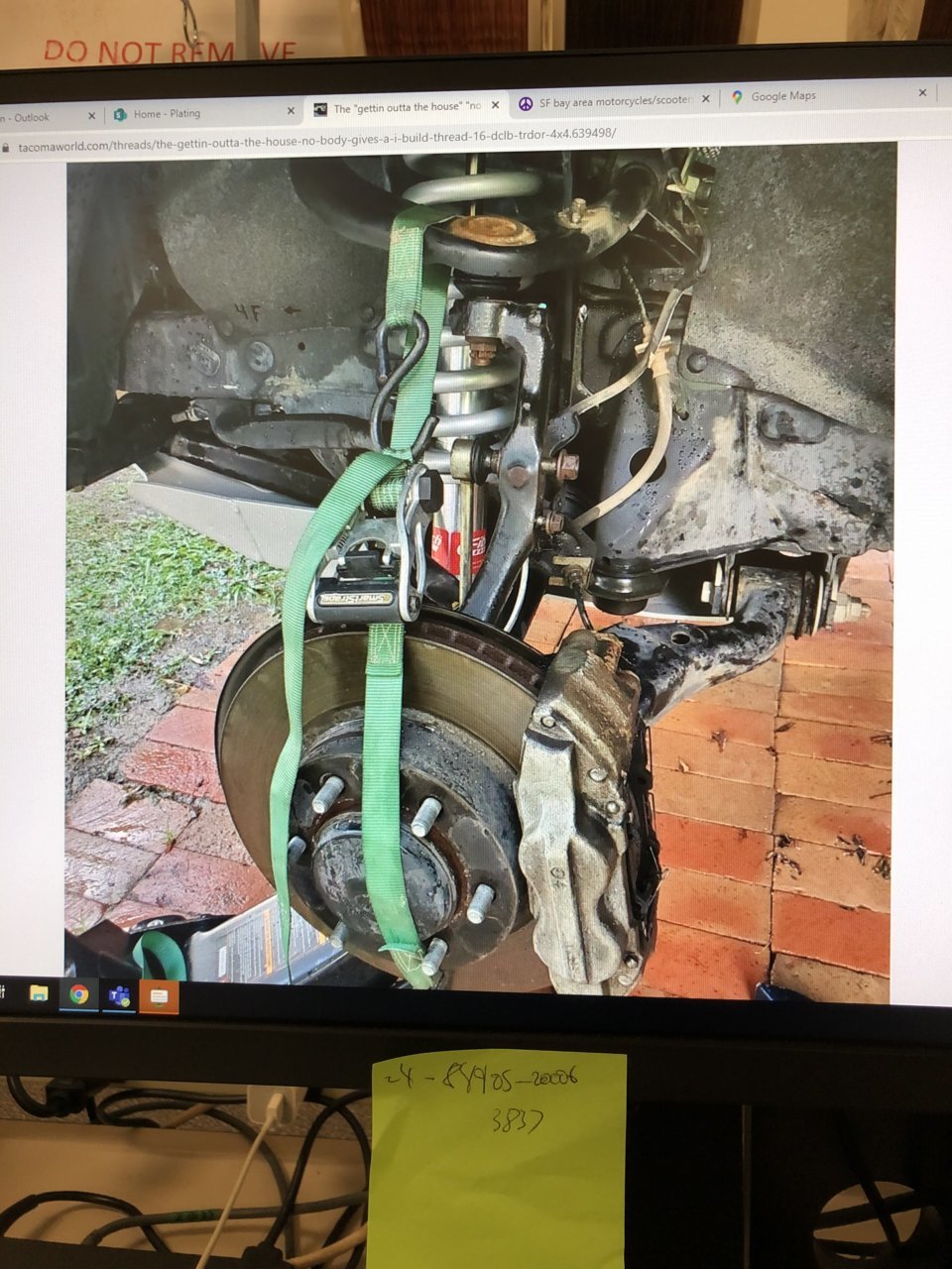

    Bird nest engine bay.
    The first side always takes 3x longer hahah!!! Took me 2 days to fully install my lift.
    I didn’t use ratchet straps. I just took a flat bar place it between the coils and press down (coil and uca). That’s if you have trouble connecting the two bottom bolts
    also torque wrench!!
