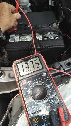

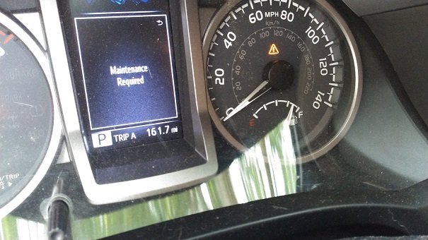

    Here's my truck's problem: last week the orange "triangle !" light came on when I started the engine but I thought it meant Door Ajar or something like that. I opened and closed the driver door and the light went out.
    I bought my new-to-me 2019 Toyota Tacoma TRD Offroad 2WD V6-3.5L back in January at 121k miles - now it's at 127.5k. Love the truck!
    I'll never buy another Ford again - 89 Bronco II, 2000 F-250 Lariat 7.3L, Aught 3 F150 Lariat 5.4L - every one of em was eventually Found On Road Dead. The F150 in particular was real uppity last year - ate $6500 in parts & labor before I threw in the towel.
    But this monday June 2 I noticed my Taco's Triangle light wasn't turning off. Hmmm. Then the dash message gave me "Maintenance Required" (oh cr*p). So when I got home, I plugged in my code reader and zero codes came up. So then I got the bright idea to see if it's a batt or alternator. I got my multimeter and put the black & red needles onto the batt posts with the engine off. I got 12.8v. Engine on at low idle - nothing on, no headlights, no AC - I got 13.75v.
    I am not familiar enough with my truck yet to know if the alternator is 100A or the high output 130A.
    Y'all are the experts. What are my next steps here? From several YouTube videos I can see a new alternator is going to be real fun for access, compared to an F250 alternator.
    One last thing - I've heard where some newer cars will have a Maintenance Required message come on, but it's only indicating a recommended service be performed by the dealership (and only the dealership can turn the dang light off after dinging you $5 Hundy for an oil & filter change, and lube the zerk fittings.)
    p.s. I'm a gringo who married into a Tex-Mex family and they nicknamed me Ben Decko - they tell me it's a term of respect and endearment!

    That's your reminder to change the oil. It comes on 5k miles after being reset. At 4.5k, it comes on and can be turned off with the back arrow on the steering wheel.
    edit: Not sure why it's on at 6.5k, unless you got an oil change right after you bought it.

    You can reset. When you aren't driving, use the right arrow on the steering wheel to access the maintenance (or is it setup?) screen of the center info panel. There's an option there to reset the maintenance light.
    edit: Too late...

    Change all the fluids is my overall suggestion. You don't know what is there and if it has even been done; a good way to become intimate with your vehicle. There are lots of threads on each of the fluids.
    I would change the -20 to -30 weight, not the lower from 0- to 5- regarding the engine oil, or both to 5-30. Nothing wrong with the Toyota oil filters either. No need to go with something else, and they are cheap too; $4 to $5 on the internet in quantity; even Walmart has them.
    As far as your alternator - what is the value of the Alternator Fuse in the Engine fuse box? That will be a good indicator of what you have.

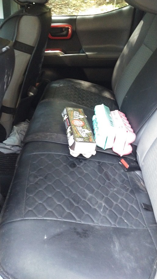

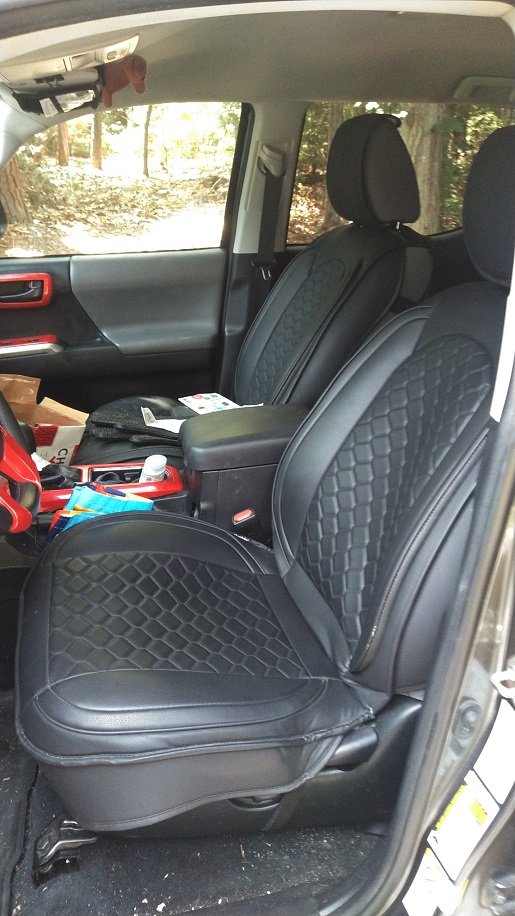

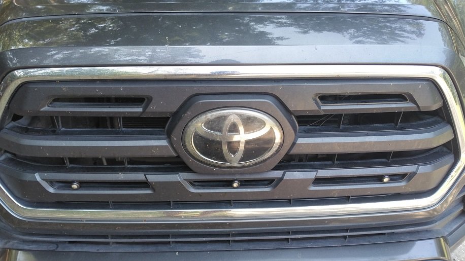

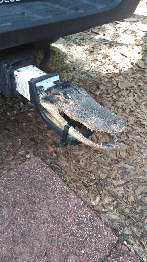

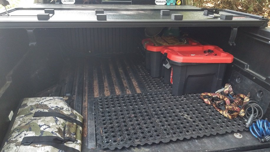

    Well I did the oil & filter change. Happy to report it went well. First, NO SKID PLATE! I don't know if it's cuz my year & model Taco didn't come with a skid plate or if the previous owner removed it :notsure: I removed the plastic oil filter cap and replaced the filter with a NAPA Gold and an aftermarket housing from ROVIKE. The oil filter cap wrench from MotivX worked great. One of the nice things is that El Taco is high enough off the ground I didn't need to get out my jackstands and trolleyjack. My fat ass was skinny enough to wriggle under there.
    Six quarts of 5W-20 full synthetic Castrol and a little Lagniappe and I was done.
    I know y'all want Taco Porn so I took a few pics of the few minimal mods I have done. NOTE: none of these pics were "staged" as I am not an influencer seeking clicks. Rather, I'm under the influence.
    VEVOR Tri-Folding Metal Tonneau ($250?). Also rubber nonskid mat from Home Despot. Totes are from Home Despot too.
    Orange accent LEDs - 19 bucks WalMart

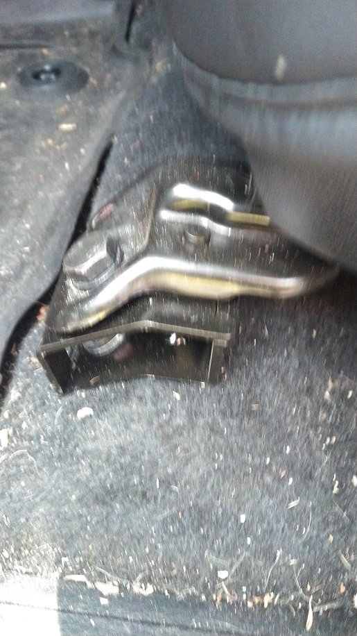

    Rough Country Front Seat Riser Kit - $95 Amazon - NOTE : I do not recco using the spacers for the rear of the front seats. It lifts the seat too darn high.
    Back Seat Covers - they're dirty cuz our Belgian Malinois rides back there.
    Front Seat Covers - the front covers went on much easier than the back covers. Same brand covers I had in my F150. They're okay but not great.
    Real Alligator head I got from the Taxidermy Man. Makes the hitch look nice and it goes with the assorted alligators I have on the dashboard as a FU to the Jeep Duck cucks.
    El Taco needs a bath & wax real bad otherwise I would have posted pic of the whole truck.
    Does anyone know of a site that sells aftermarket billet differential covers? Thanks!
