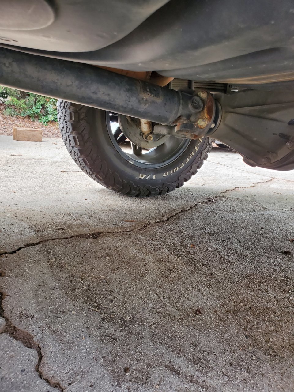

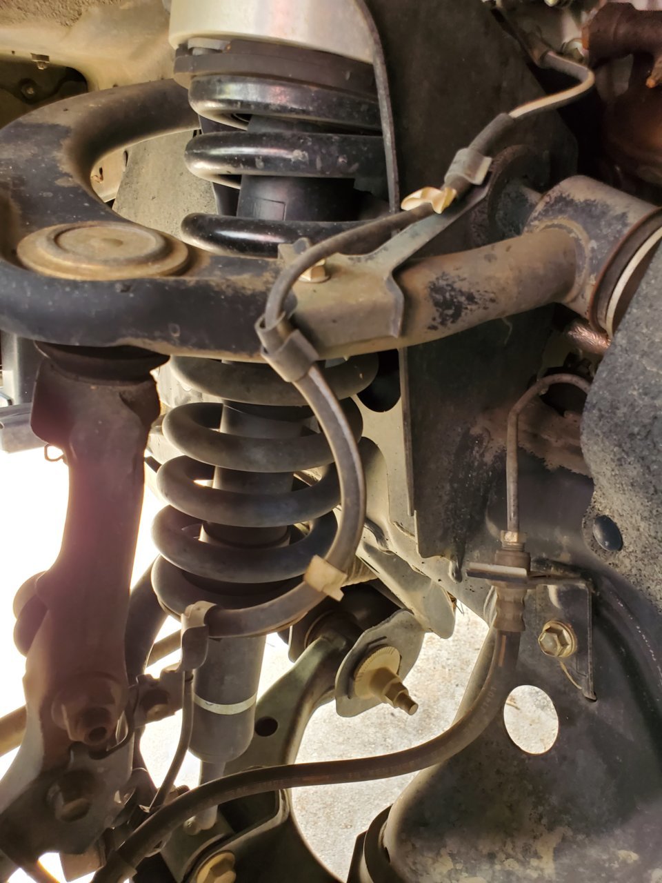

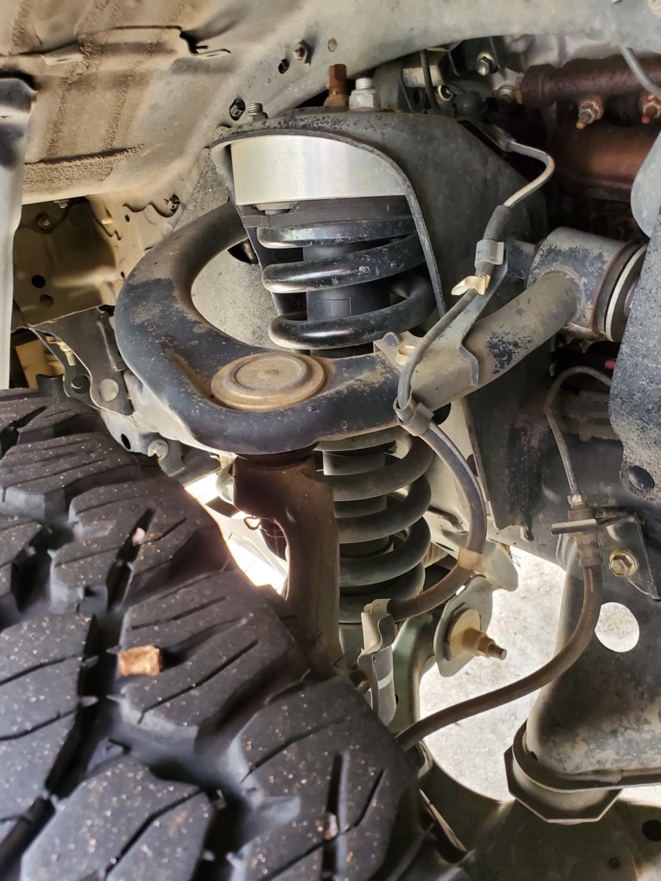

    First time Tacoma owner. Was wondering if anyone could tell me what type of lift this is? Spacer lift?? Were longer shocks included?? (Pics for reference included). Any insight would be greatly appreciated. Thanks!

    The front is a top spacer. You'll get double the thickness of the spacer, for lift. If it's a 1 1/2" spacer, you'll get approximately 3" of lift in the front. Need to see some additional pictures of the rear. Can you snap a pic of where the rear diff/axle housing meets the leaf springs?
    Most here are not fans of spacer lifts. I've had one on my truck for a few years now with no problems. If you wheel it hard, you might have some durability issues but for the majority of us that only occasionally go off road, they do fine in my opinion.

    Stock shocks and springs with a spacer. As said above you’ll catch some hell for them but I ran em on my work trucks for a while in the oil field. If your ok with the ride and hight and your alignment is in spec, leave it. If there’s blocks on the rear you’ll be ok for a while but the stock yota springs are weak and could break so some lift springs might be in order down the line.
