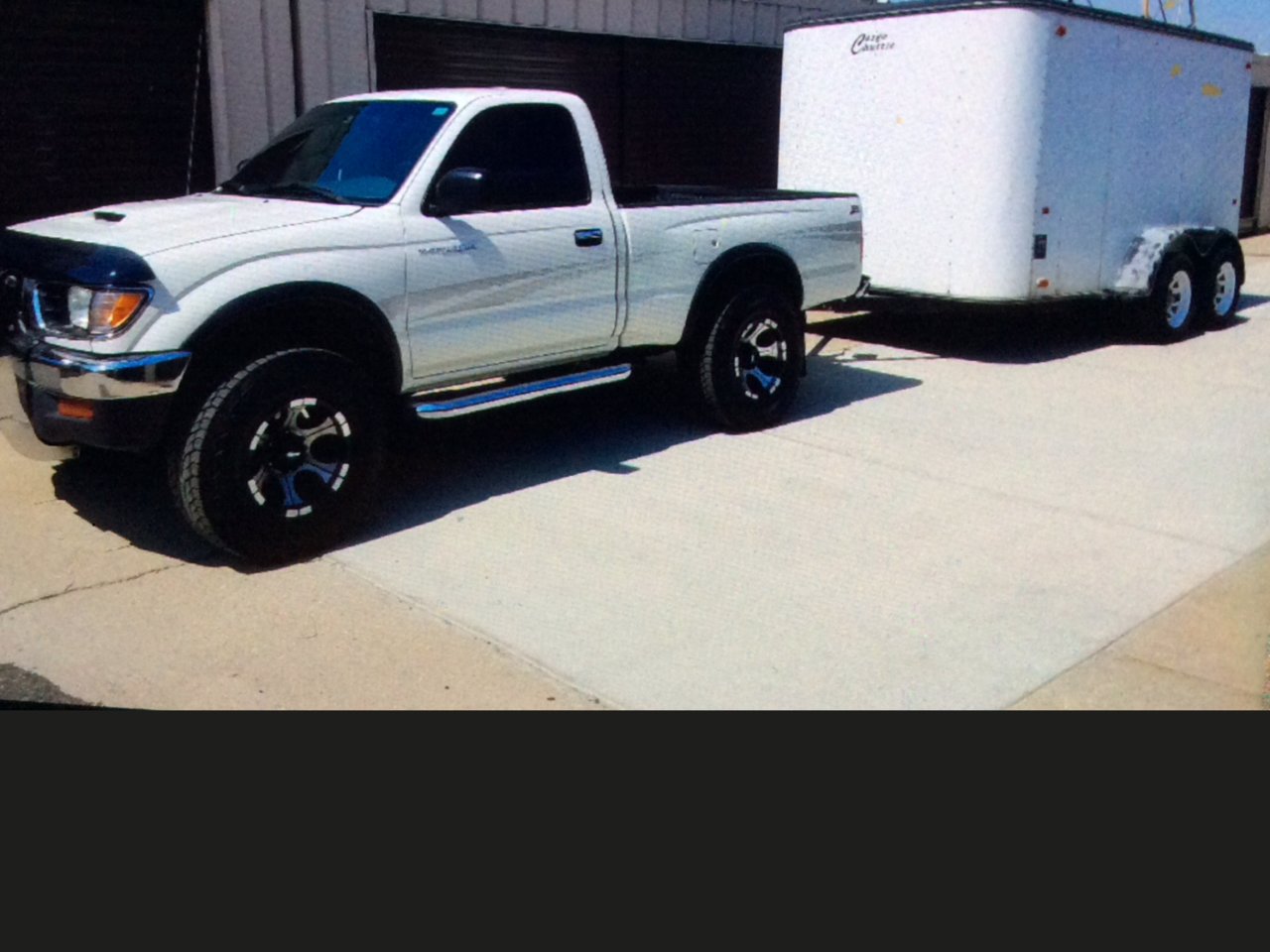

    Just make sure the trailer comes with electric brakes, if possible get a tandem axel setup to support the weight and have a brake controller
