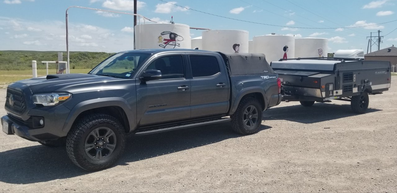

    So I decided to tow my camper for the first time yesterday and I was less than impressed with the capability. I know people are complaining about the power of our Tacos but wow... It really seemed to struggle on the hills and they weren't that steep.
    My camper is a Coleman pop-up with a GVRW of 3350# and an unloaded weight of 2200#, well below the towing capacity with the class 4 hitch. I used to tow it with my old Dodge Grand Caravan and it pulled fine. Now I'm trying to figure out what is the best option to improve my towing... It's not like I'll be towing every weekend but I do plan to tow often, that's one of the biggest reasons I got a Taco.
    What is everyone else doing? I was also planning to upgrade my camper to a travel trailer in the future.

    Start easy and get the vF tune for low end torque and better AT programming. See if that helps, it should.
    If that is not the answer, then 5.29 gears is the next step.

    My little popup has 21 states under its belt. It's crossed over the Appalachians, Rockies, and Sierras, and then some. I can't say I ever had a problem with it, either before or after the tune.
    You are towing S4, ETC on, right?

    So the 3.5 in the 3rd gen Tacoma is built to run high RPMs, that's where it makes power. It's prolly pretty disconcerting at first, but it's just how they run. The motor likes to rev, and it won't hurt it. Even my 2nd Gen runs pretty loud upwards of 3500 rpms sometimes pulling passes at speed.
    As @Rock Lobster said, are you making sure to lock out high gear, and also to use ECT?

    ECT+S4(or S3!) and let it rev. Little 3.5 wants to be a Honda vtec yo!!
    Enjoy your camping, don't worry about the mileage.

    14 average, 16 with tailwind, 12 with headwind. 65 mph highway. Milage suffers at 70 and above.

    I tow a 3,500lb boat a few times a year. My experience is you need to get nice and comfortable revving this thing to 4,000+ rpm. This engine just doesn't make much torque down low, and the gearing does not help you out at all.
