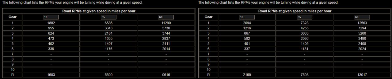

    Don't you think 5.29s are a little extreme for an otherwise un-modded Taco?

    Not in the least. The overall ratios close enough to the Stock MTs, esp in the upper gears. MT with 32s on the left, AT with 32s and 5.29s on the right:
    The website is grimjeeper.com .
    YF_Ryan[QUOTED] likes this.

    That's nuts the difference between the MT and AT ratios on the 3rd Gen. WOW.
    But looking at the AT 3.91 vs AT 5.29, that's a VERY large difference. I just swapped from 3.73 in my 2nd gen to 4.56s, stock tire size, mainly for towing which I do consistently. Just seems extreme for intermittent use.

    It is nuts, right? The 3rd Gen AT diff gearing is a joke. In real life, the MPG difference is not even there. And, it was said that Toyota can't build more than 5% MTs without goofing up the CAFE compliance. Just weird all around.
    IMHO, ATs should have been at least 4.88s Stock. That would have made some sense.
    The 1st Gear ratios in yours has an extra zero. :D
