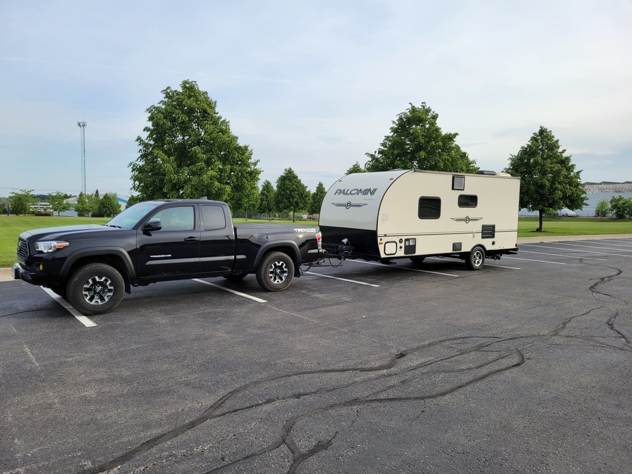

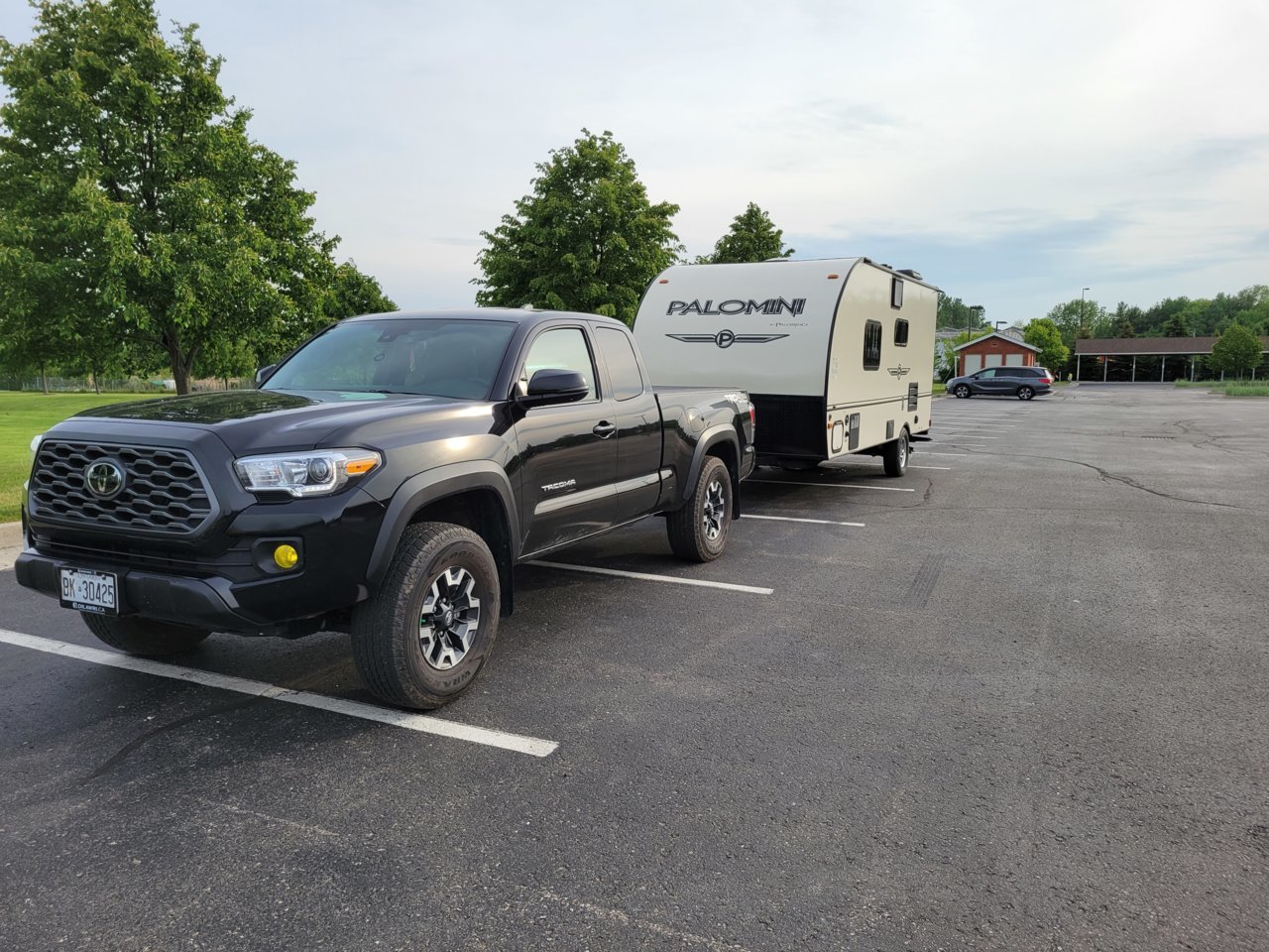

    I tow in s4/5 (depends on speed limit, if its over 70mph I use s5) ECT on. 3k lbs, highest trans temp I saw was 197.6f and that was leaving a light. I'm also at sea level, and it was roughly 70f.
