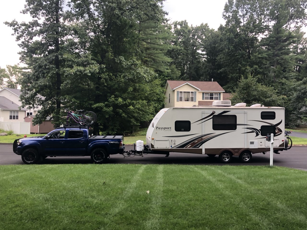

    02A1A9B7-E977-403F-B827-42EA65F552B2.jpg A few things to start. Towing capacity is upwards of 6,400lbs depending on bed length.
    So 4,400lbs dry is a decent size trailer. Likely 5,500lbs if you load it up with stuff. 22.5 ft is not super long by any measure but that is a big mass. You will be fine if you have towed before. Practice and experience building up to a bigger trailer is very helpful.
    I tow a 2013 Keystone Passport 2300bh 26.5 ft 4390 dry weight. Short wheel base TRD D Cab. 4.0L. 5,000 plus pounds towing.
    We tow all over the Northeast and Adirondacks from Upstate NY. We do Maine. Cape May, NJ. Just fine.
    Apparently a Silverado 1500 can tow like 12,000lbs optioned correctly. No one bats an eye at one towing a 30 ft trailer or larger and relatively speaking it is no different. A 22.5ft trailer at 4,400 dry weight is fine for occasional use and an experienced person towing.
    Dealers setting up hitches is hit or miss so it helps to find an experienced friend/stranger or small RV shop that may be willing to help. Can’t stress that enough! I would talk directly to the person setting up the hitch. It will likely need adjustment by the next tow. They don’t know what you carry in addition.
    You will want to practice towing. On highways. In rain. On back roads. All of it. Understand when to engage only the trailer brakes from the controller. On ramps and sharp curves you have to take at a proper speed. Especially clover leaf style ramps. Windy days are also slower speeds.
