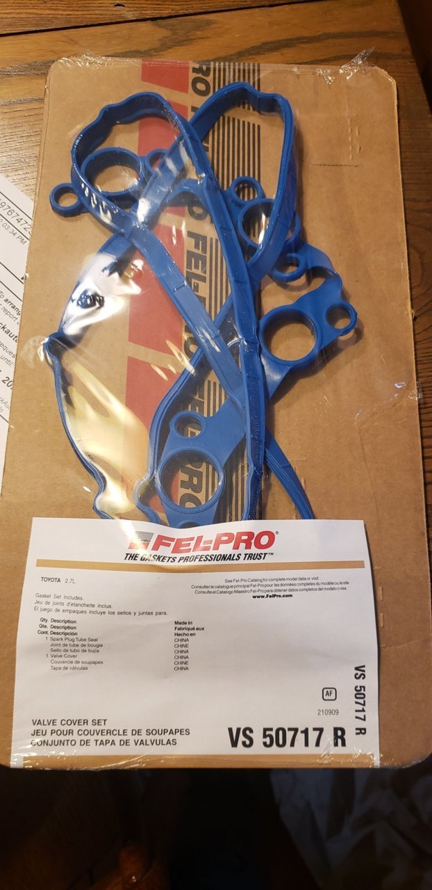

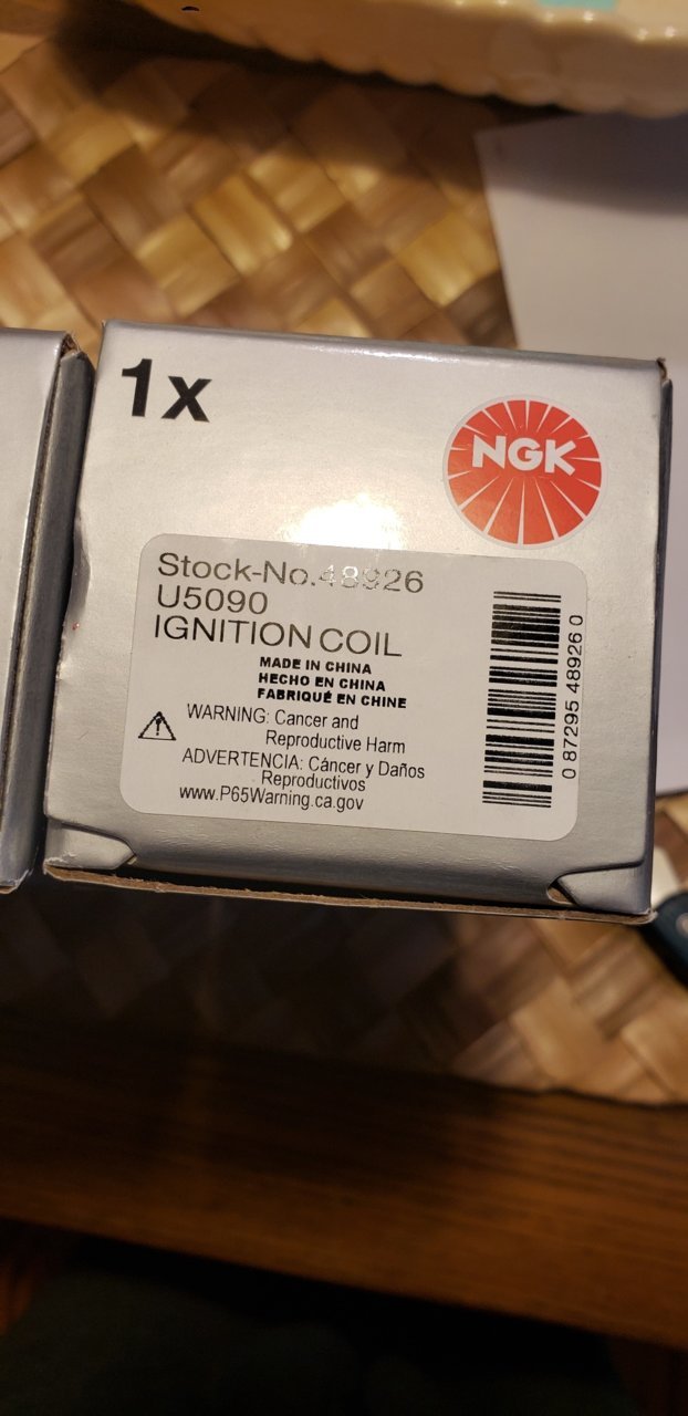

  4. Feb 3, 2022 at 1:42 PM
    #24
    Madmax1949
    Madmax1949 [OP] Member
    Apr 23, 2021
    #363635
    17
    Got everything in, Fel-Pro gasket did not have the grommets included at least with this kit # in the photo. A little disappointed in the packaging for the gasket as it was kind of all twisted. Doesn't appear to be any damage but usually gaskets I buy are laid out flat. Surprised the NGK coils were made in China, I was really hoping to get made in Japan. I trust the NGK brand but not the guy at 5:00 on a Friday putting them together if you know what I mean. We just got hit with an icestorm so have to wait for the install

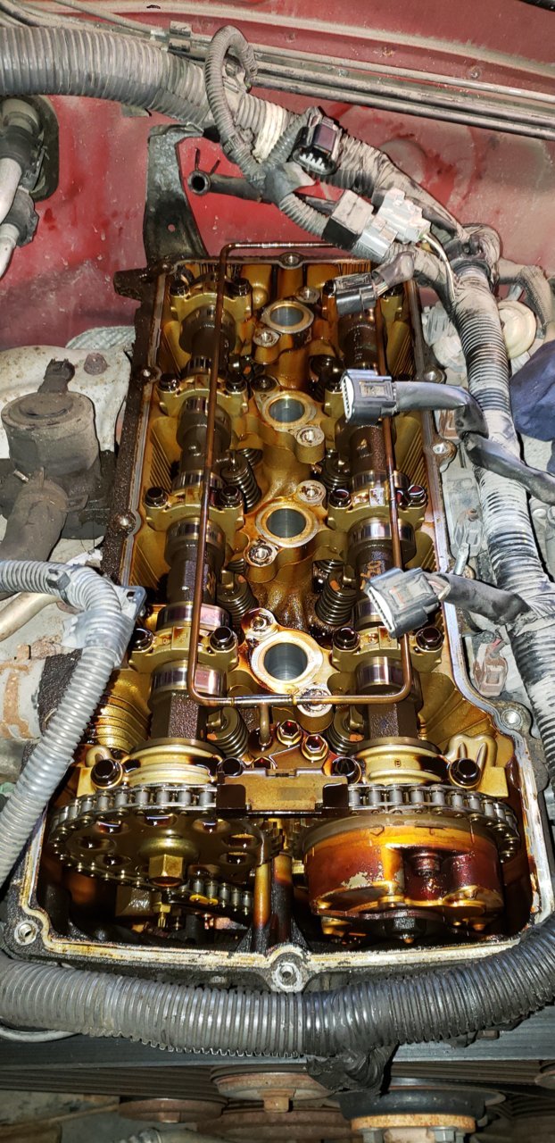

  5. Mar 1, 2022 at 2:14 PM
    #25
    Madmax1949
    Apr 23, 2021
    #363635
    17
    Here's how it looked on the inside. Timing chain looks good and the sprockets still had some flat across the top of the teeth so that was comforting. No grooves on the cam lobes. A little grimey on the inside but not horrible. Most of this I'm assuming coming in the last few years of driving it while it was leaking. Center spark plug gasket was hard as a rock and crumbled to pieces when I tried to pull it out. It was easy to see where the gasket had flattened out in the back corner where I was getting most of my leak. Outer gasket was also brittle along the edges. Hopefully I'll have the new one in by this afternoon. In hindsight, I'd have had my engine by cleaned/detailed before this so there wasn't so much dust everywhere....
  6. Mar 1, 2022 at 2:17 PM
    #26
    Madmax1949
    Apr 23, 2021
    #363635
    17
    Also forgot to mention that there were no grommets that I could see as was mentioned before so I didn't pick any up.
  7. Mar 7, 2022 at 2:30 PM
    #27
    Madmax1949
    Apr 23, 2021
    #363635
    17
    Just wanted to say thank you for all the guidance. Everything got put back together, no leaks and no more burning oil smell when I start the truck. I really appreciate all the help.
