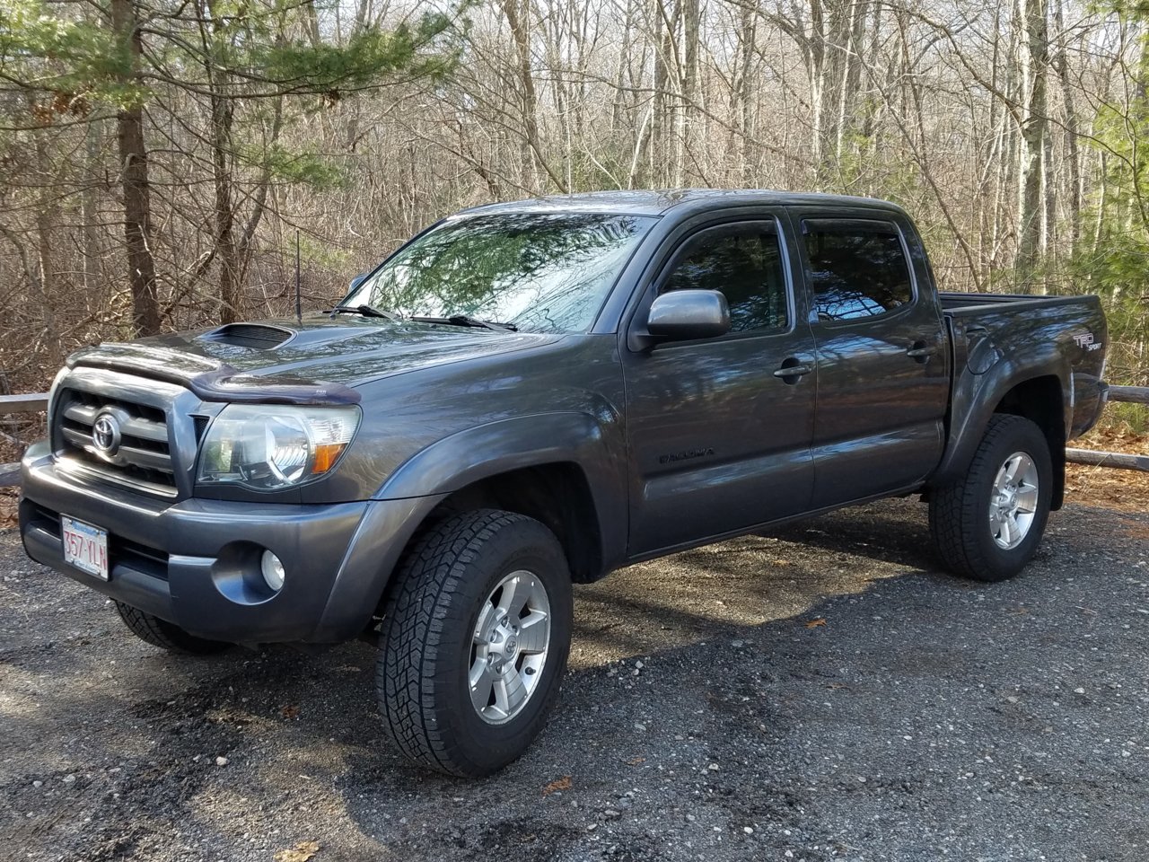

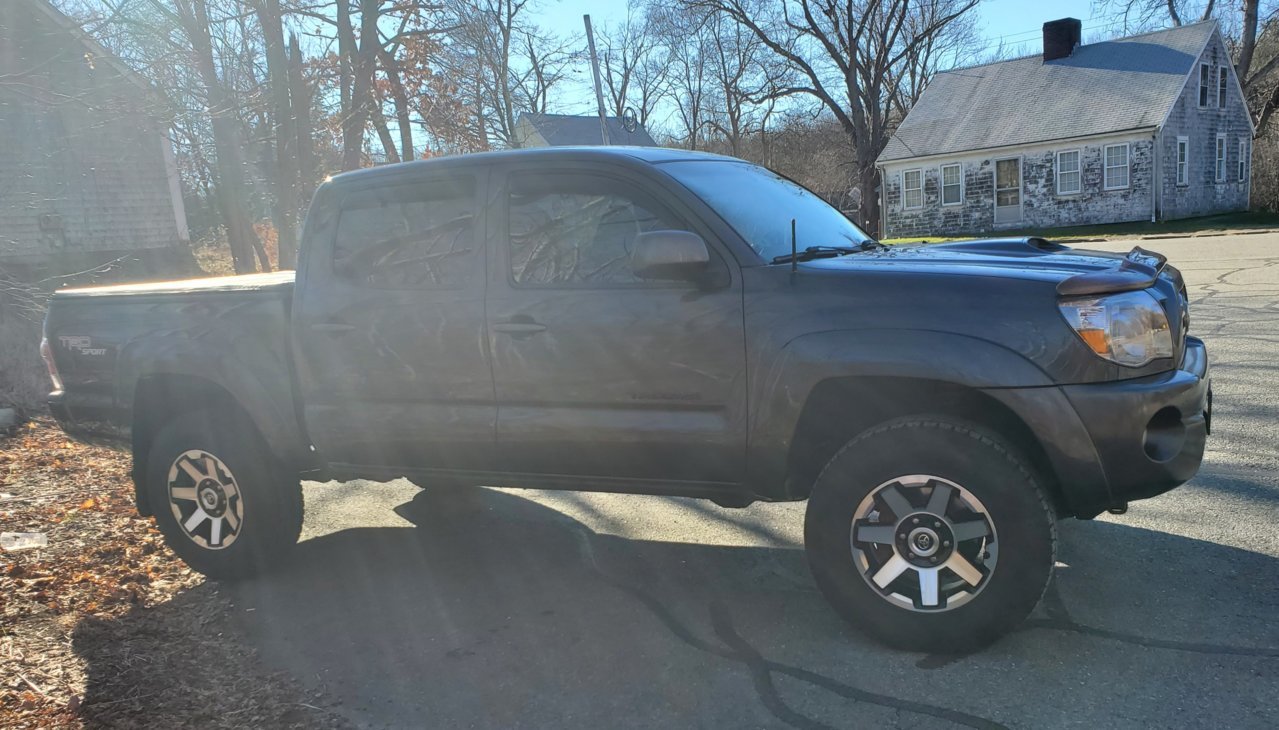

    You have other options in the 17"wheel size. 265/70/17 will fit and so will 255/75/17 which is what I run. Mine is a 32" tire and it fit on stock suspension. I'm sitting at +2" now but kept the same tires.

    255/75/1720221220_115409.jpg 20180212_145621.jpg

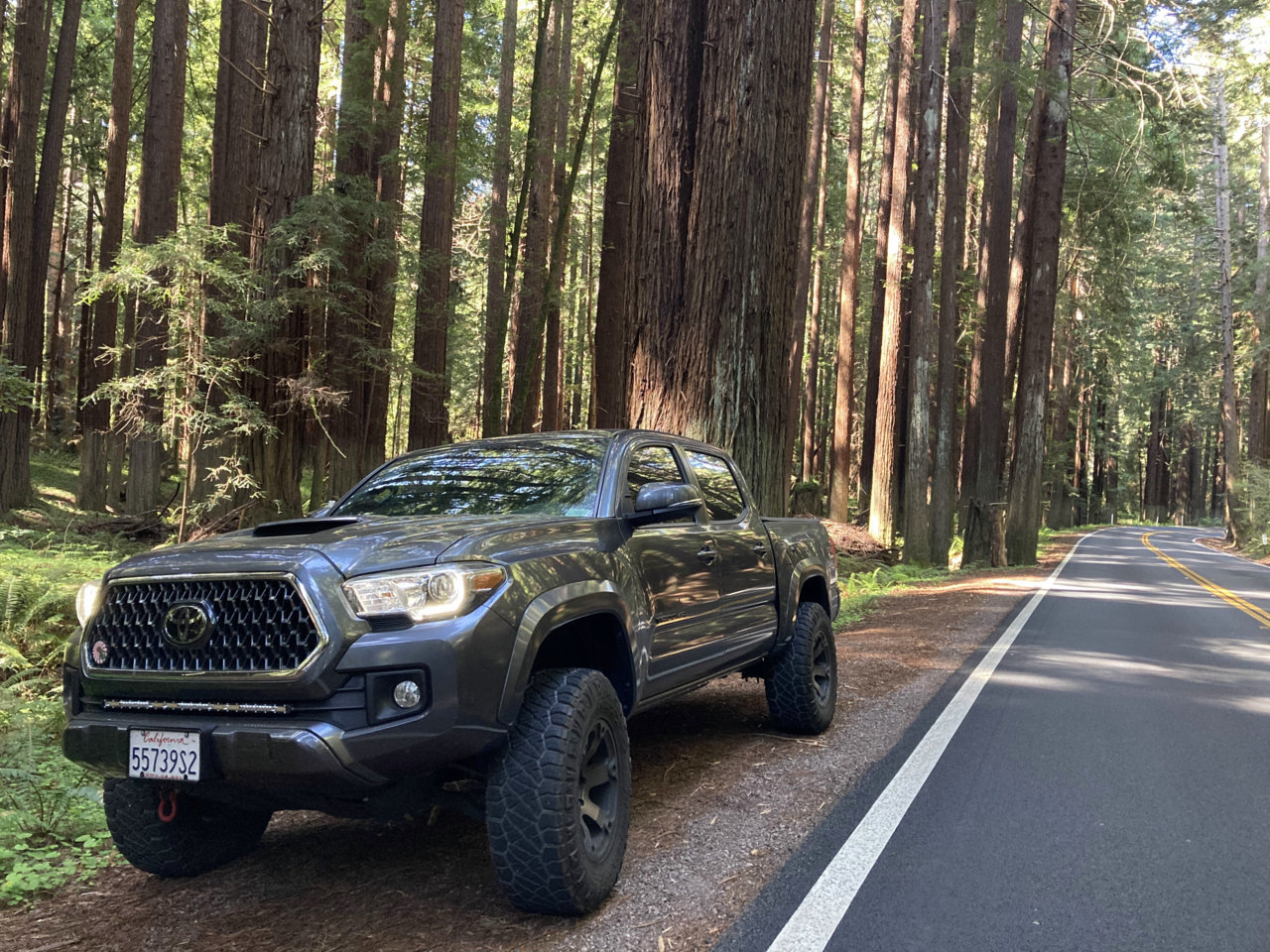

    BB4DF13C-8F36-4C10-A205-B28C061F2BFB.jpg i have 285/70/17 with a 3" NITRO lift (puck) 2" block in the back (1" in the back on this picture) i believe my offset is 12. killed my MPG but i knew that going in. i have ZERO tire rub! not a lot of off road for me but it does everything i need and want. Tahoe ready with WeatherTech from mats, slimline light bar (3 settings white light, fog and combo) and Amp research running boards (not pictured)

    So many choices. It really depends on the look your going for and how much work you want to do to make it fit properly. Find something you like the look of and go from there. Maybe post a pic of the look you want for reference and you can get some help on what it needs if anything other than bolt on. 285’s (roughly 33” depending on the tire brand) would most likely rub, especially without a lift or other mods to trim. The offset will also play a factor in rubbing. Like the other guy said though, you get many more options in 17” wheels. Look forward to see where you go with it.
