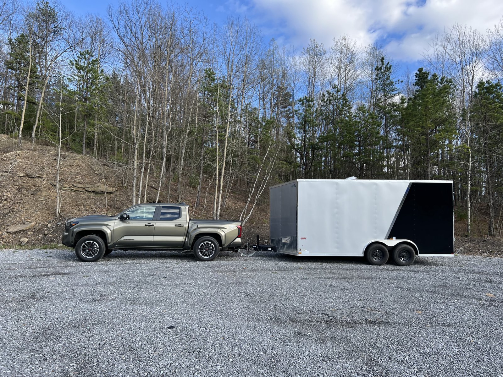

    I pulled this ~60 miles today. A combination of 2lane county roads and 10 mile uphill pull on RT80. The wind pushes it a bit. I kept my speed at 60. It was on full boost a lot going up hill. Not sure if that’s bad?. Trailer is ~5000lbs
    It doesn’t pull like my 5.7 Tundra but it did okay. I messed with the Utv load to get it more level.
    sorry pics are not loading

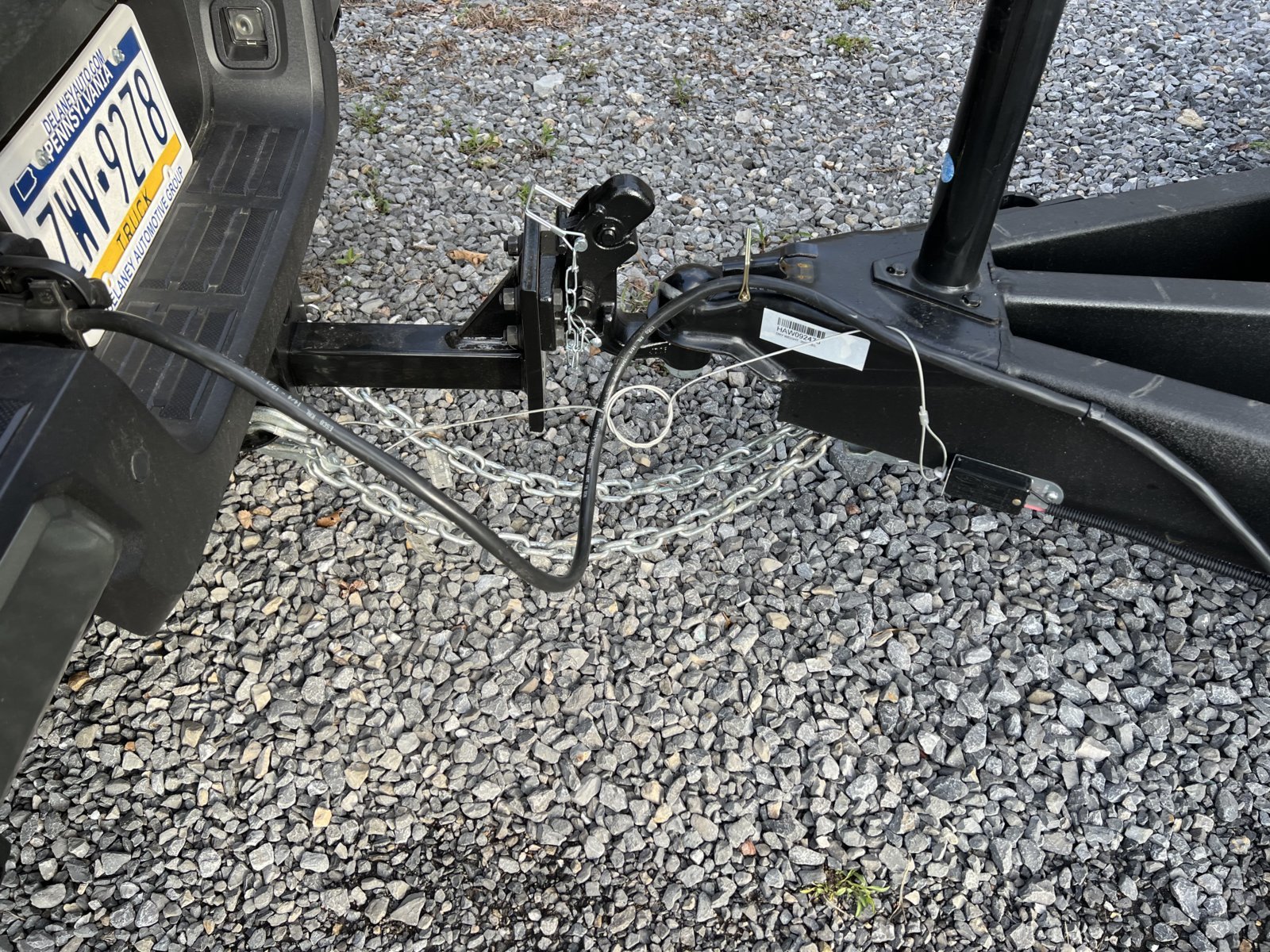

    Extended hitch

    Is the 5000 lb trailer weight dry or loaded?

    yikes.. that's definitely not good if done all the time

    I had that exact trailer and towed it with my f150. I def wouldn't want to tow it with my tacoma with a bunch of stuff in it
    edit: and damn that's a lot of stress on that hitch with the extension

    Why the hitch extension? Did you do the math on the increase in lever arm/tongue weight for it to make sure you're still within limits?

    No I had this hitch on my tundra 5.7. I needed a long hitch so I could open the tailgate while the trailer was hooked up. I think I can go back to a standard hitch now. The taco tailgate is shorter and the receiver seems to sit farther back. Still trying to find the right set up

    I'd want that hitch way closer, it multiplies tongue weight the further out it is.

    Oof. That's V shape is not good. Too much for a midsize.

    I wouldn't be super worried about it. Watched the car care nut video and read through some of the technical documentation, not only is the engine built super stout but the water to air intercooler should really help keep IAT's down while towing like that. Sounds like it's well within the trucks means to operate like that. Only thing that gives me brief pause is if OP did it under 1000 miles on the odo.
    Bet it felt a lot better than my truck towing a similar load, 2grfks running at 5000rpm to get up a steep hill:rofl:

    I'd get a shorter hitch, as others have mentioned, and I'd also get a weight distribution hitch to get some of the weight off the rear axle and moved to the front end. That would help a lot. If you need to be able to open your tailgate, and can't with the shorter hitch, I'd suggest relocating the trailer jack instead of getting a longer hitch.
