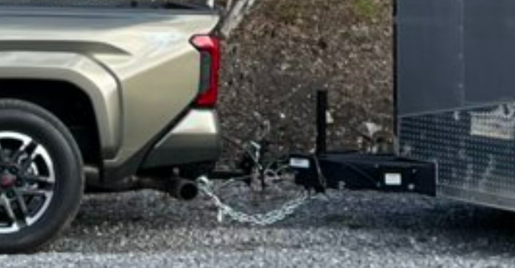

    And while we knit-pick your trailer setup:
    I just noticed the length of your safety chains. This is partly due to your longer hitch, but those chains should be short enough that if the trailer detached from the ball, the crossed chains would support the trailer tongue without it touching the ground.
    I swear I'm not trying to be a jerk, just wanting to keep your rig as safe as possible while you're towing that trailer :thumbsup:
