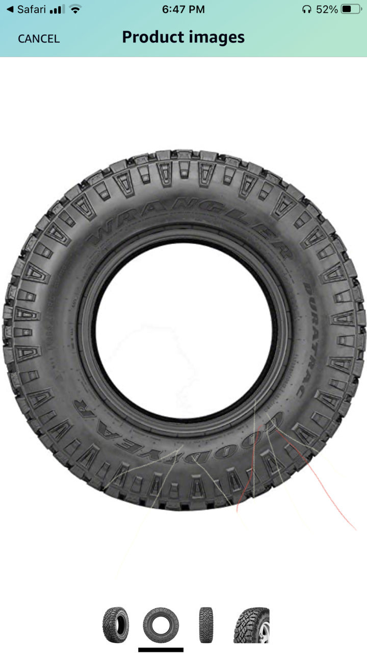

  17. Mar 4, 2021 at 6:48 PM
    #17
    mwrood
    mwrood [OP] Well-Known Member
    Oct 6, 2020
    #343042
    1,030
    2021 Voodoo Blue TRD Premium Sport
    Yeah. Definitely won’t be off-roading at all. I just wasn’t sure if the tire compressing like it did was bad and if I should have aired up to compensate for it. Sounds like I’m good at the level it was at.
    Door says 30psi cold and I’m usually right around 31-32 cold, so I’m guessing it’s good. I did the chalk test and it was closer to 34-35, but I’m just gonna leave it at 31-32.
    RedWings44[QUOTED] likes this.

  19. Mar 4, 2021 at 6:50 PM
    #19
    RedWings44
    RedWings44 Well-Known Member
    Apr 28, 2020
    #326226
    8,060
    Michigan
    2017 Black TRD Off Road 4x4, 2019 MGM 4Runner SR5
    I was wondering why your username looked familiar. I remember now. Yeah, I'd say you're pretty good where you are at. If the temps dip again, the cold pressure could go down so it gives you a little wiggle room. Just remember to keep an eye on that because too much above and you'll start running into excessive wear on the center of the tires.
  20. Mar 4, 2021 at 6:50 PM
    #20
    Tacodog
    Tacodog Well-Known Member
    Feb 13, 2010
    #31329
    1,859
    Ron
    Renton, Wa.
    ‘19 TRD offroad DCSB Cement
    Icon stage 1, Icon upper control arms, 17” Fuel wheels,Ridge Grapplers, TRD exhaust, leather interior.
    Look on your tire around the inner ring. You will find load with max psi.
    mwrood[OP] likes this.
