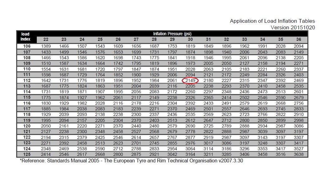

    Your Duratrac has the same load rating as the stock tire; 30 psi is perfectly suitable.
    That said, load capacity of your tire will continue to increase until 36 psi, at which point anything over 36 psi is used to maintain the speed rating.
