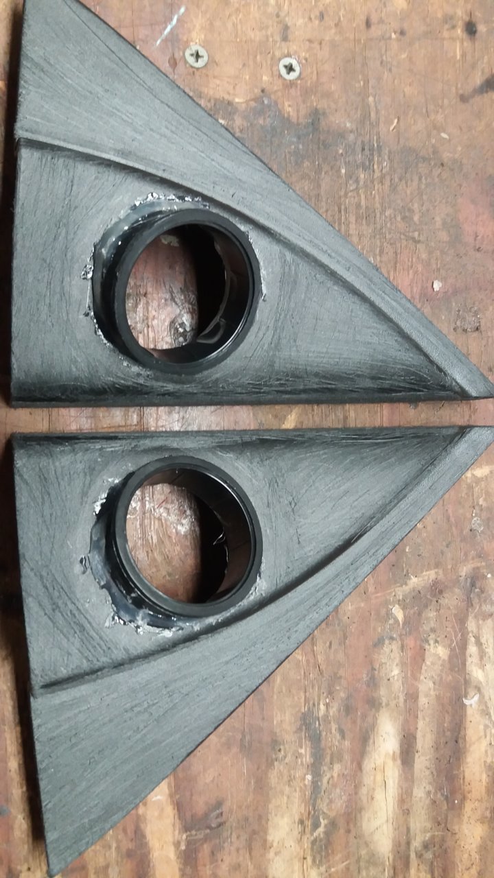

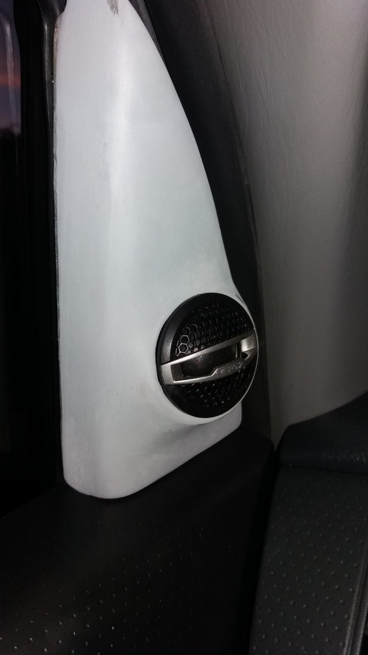

    I just wanted to share some pics of my tweeter mod made from fiberglass,I painted it with some texture bed liner in a can,It turned out what i thought was ok..Just wanted to share with you guys,All of you are always willing to help and i learned a good bit on here.Thank you all!

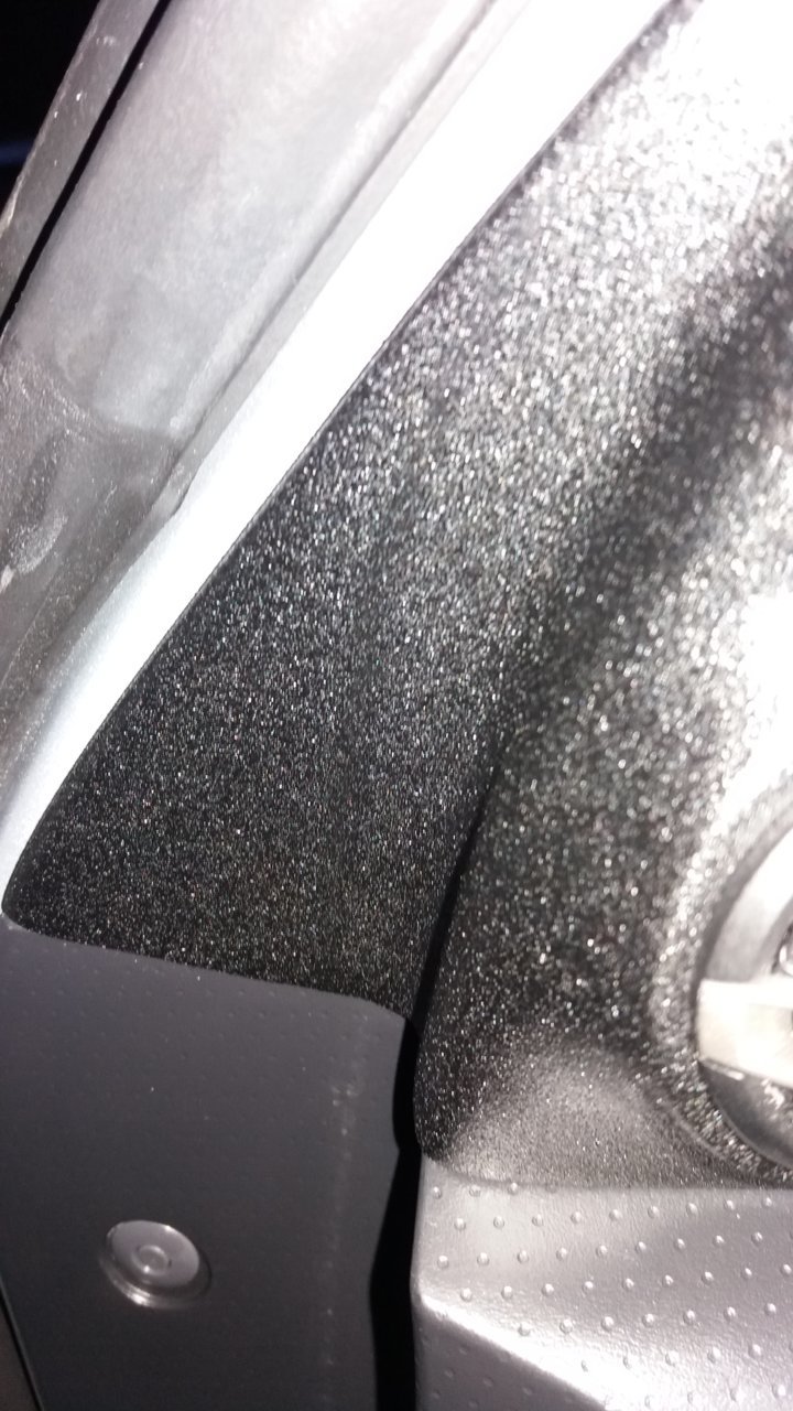

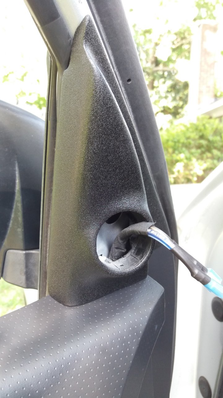

    Ok this where I'm somewhat unhappy..I love the look and i worked really hard on this...If you look at this pic where the door closes against the sail panel,It leaves a line..The door opens and closes fine,I'm just not under standing how this texture paint would have a line it after the rubber seal hits it?Will i just say the hell with it and leave it,Does it need more texture or do i need to sand that part thinner then re coat?Thank you very much for any advice!

    Looks really good. I wouldn't worry about the line, just means you have a good seal.

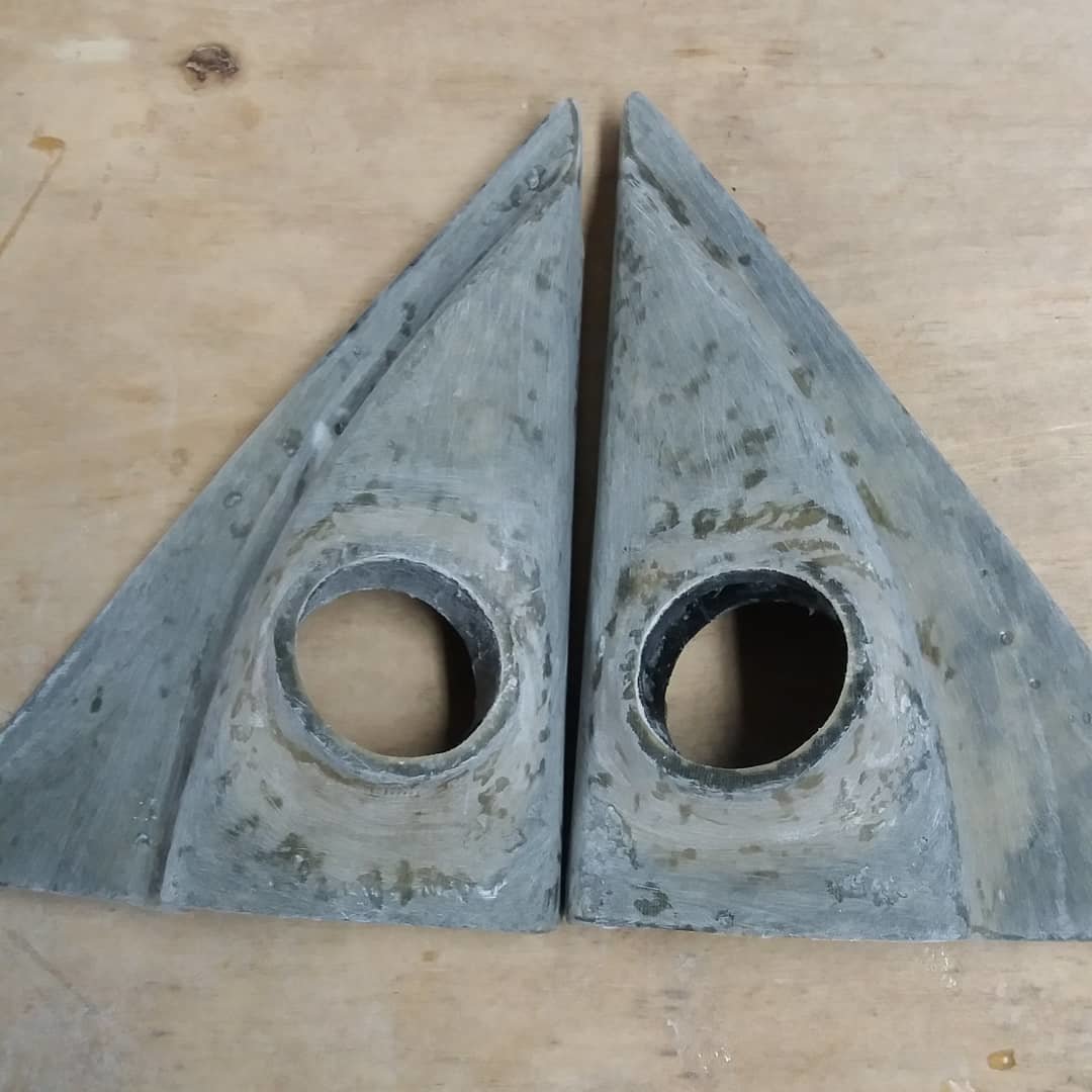

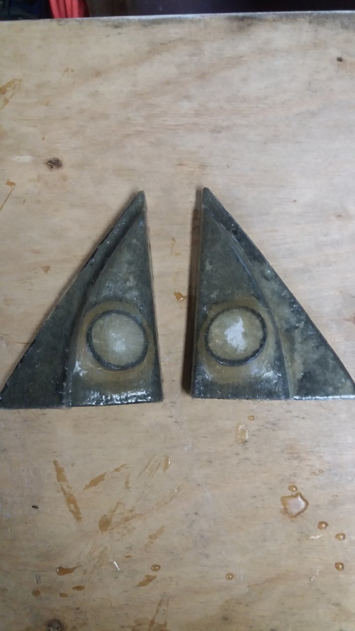

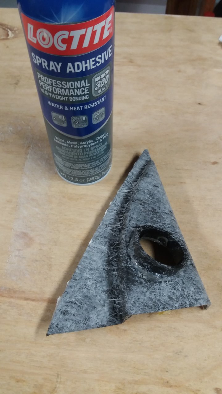

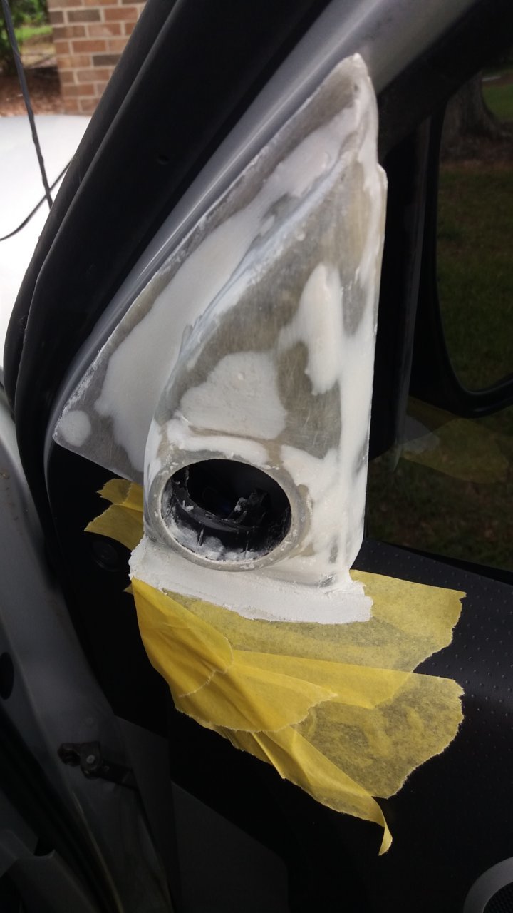

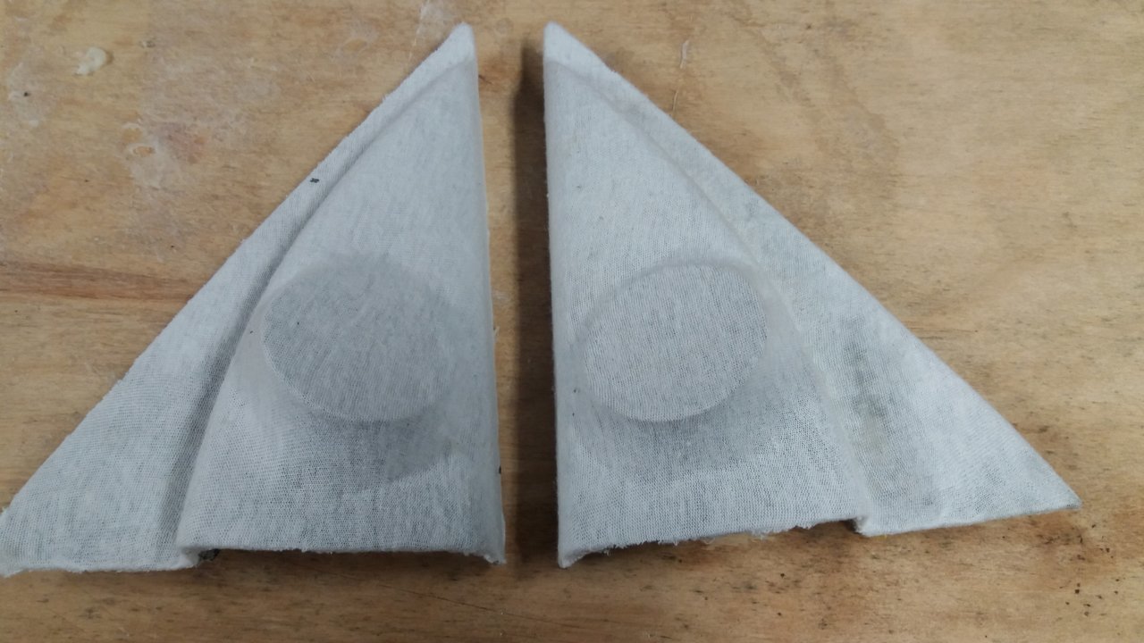

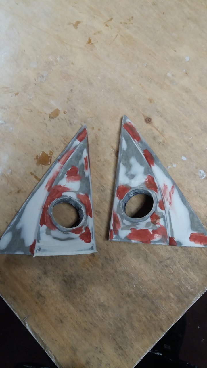

    More pics of the build from the start.

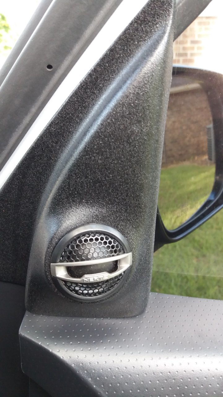

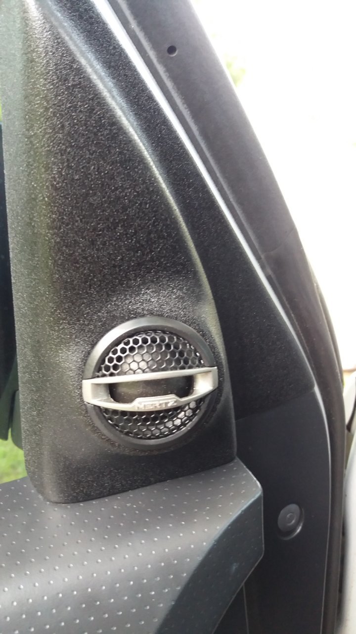

    Thank you!! Went to lowes and bought some rust-oleum truck bed liner in a spray can,After i let it dry completely,Then i went over it a few times with a matte black spray can from Krylon from wal-mart.I used a gray primer and wet sanded it with 400 grit.Then sprayed all the paint.
