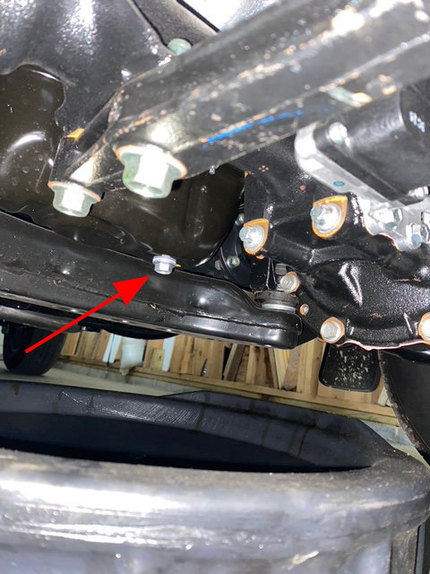

    not it (oem skid ) doesnt extend back to the oil pan. I wouldnt go with the long nipple version.

    OEM "skid" is a splashguard, lightweight. TRD is a better option for protection (gravel drives, camping roads) without going "mod-crazy".

    Looks like the oil should just drop into my pan. This is how I did it on my last two Jeeps...

    I believe the Off-roads skid plate extends the same length as the TRD Skid Plate, so you can use the Fumoto w/long nipple without too much worry. The stock skid plate is pretty thin though. Trd Sport and below only have the front splash guard, and no protection over the oil pan.

    Straight down, mostly, yes. But it comes out fast, thin oil. I have a Fumoto on my OR because I do not want to splash the oil all over the top of my engine skid when just a plug is unscrewed. The tube I can put on the short-nipple directs oil away from the vehicle, even if it takes longer than an open hole on the bottom of the pan.
