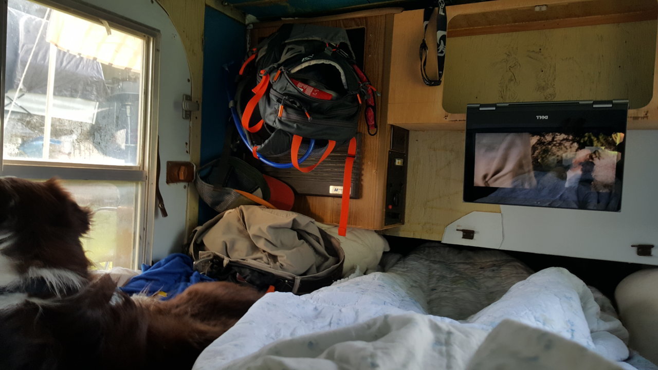

    Here is the sleeping area cabinets... needs some work. Also they are way to low! My toes hit the bottom of the cabinets if i lay on my back.
    Also looks like Dude already found his spot! This is his first time checking out the new camper.
    Not sure what that is on the bottom... But there is a plug on the outside for an extension cord to power it.

    Magnetek/Parallax Power Inverter/Converter

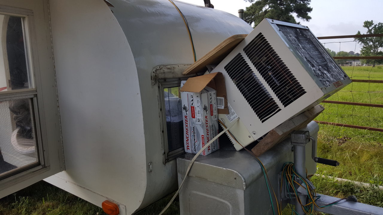

    I camped in it over the weekend to test out the a/c in the front window method. Actually got cold a couple times at night. Need to figure out something for the a/c though... all the cold air blows out the sides and the vents are way taller then the window...
