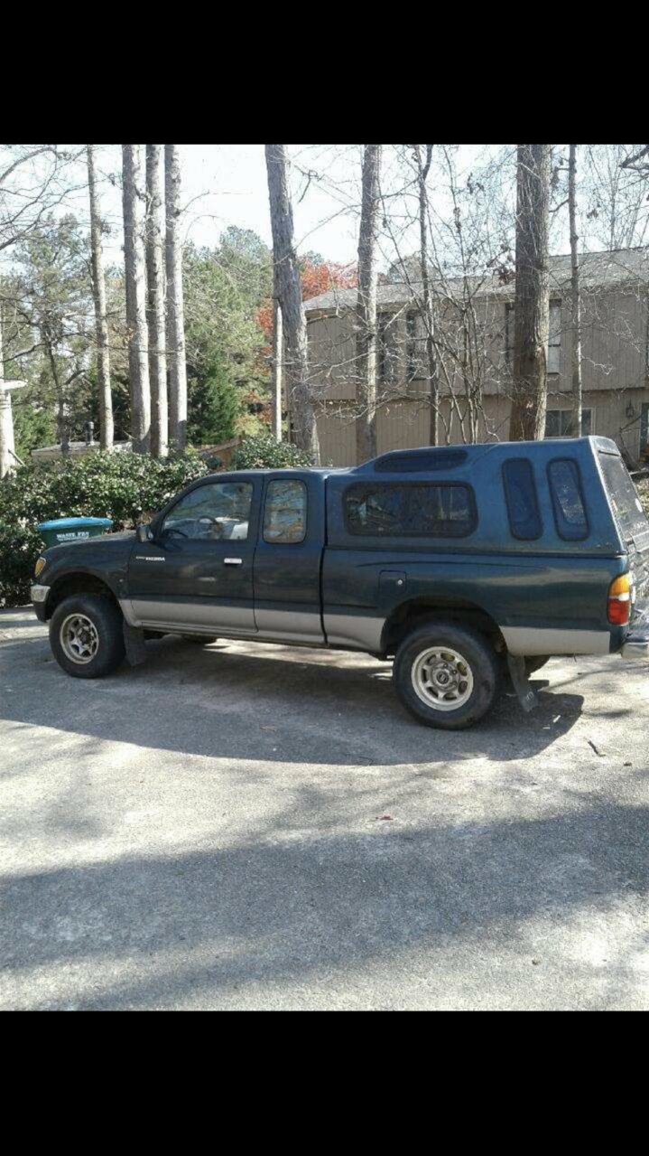

    Bought my 96 v6 auto DLX xtracab 4wd a month ago. 270k on it. I love it. Plan on doing a lot of work, keeping it a long time, and using it for a lot of truck stuff adventures.
    Day I bought it:
    Suspension is shot/possibly original. p225 tires.

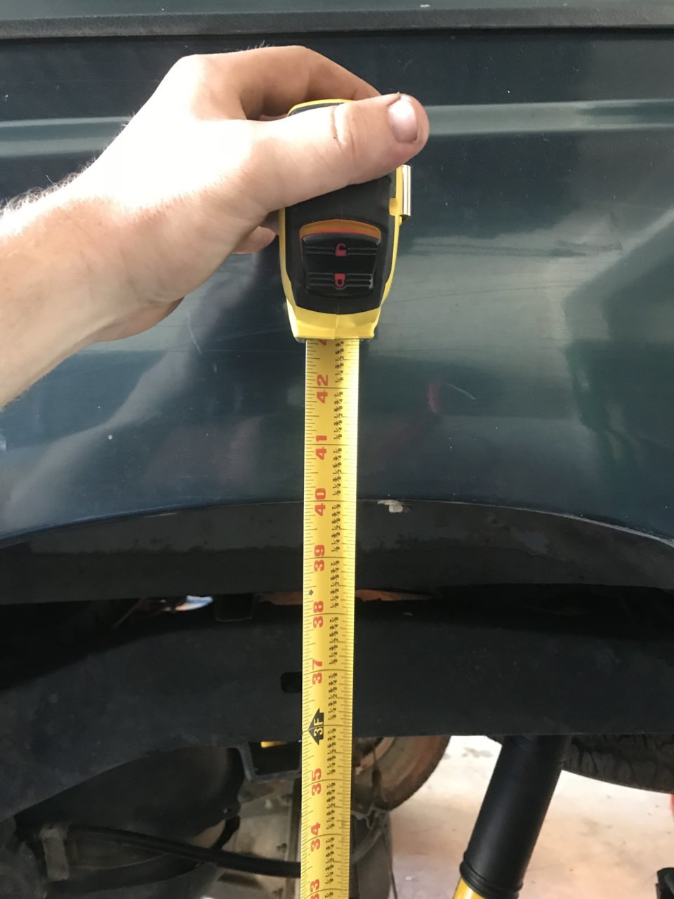

    Before and after suspension, wheels and tires:
    OME, 882 coils, dakars
    265/75/16 duratracs
    2016 Tacoma silver alloys

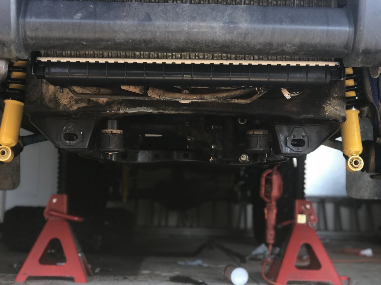

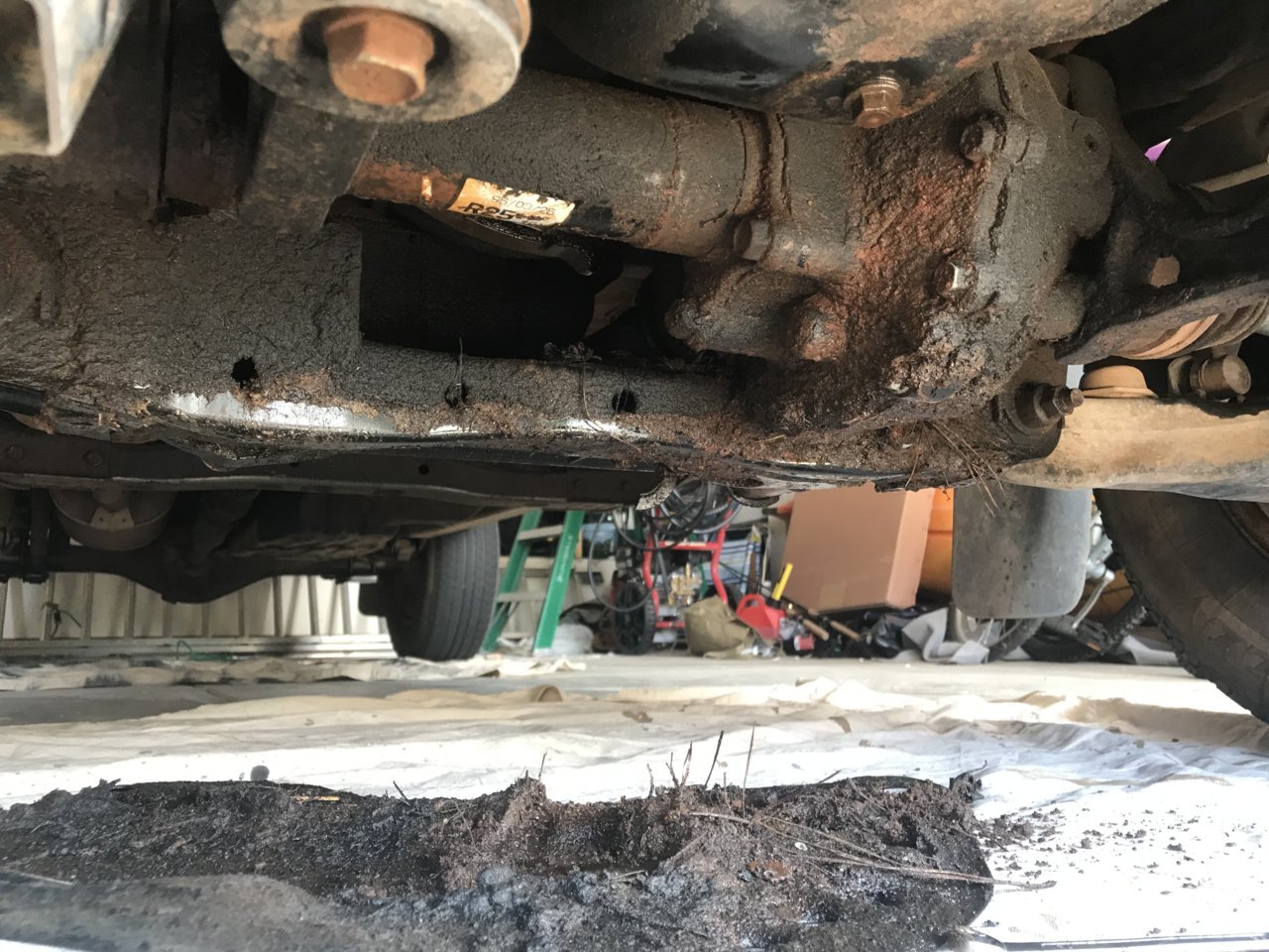

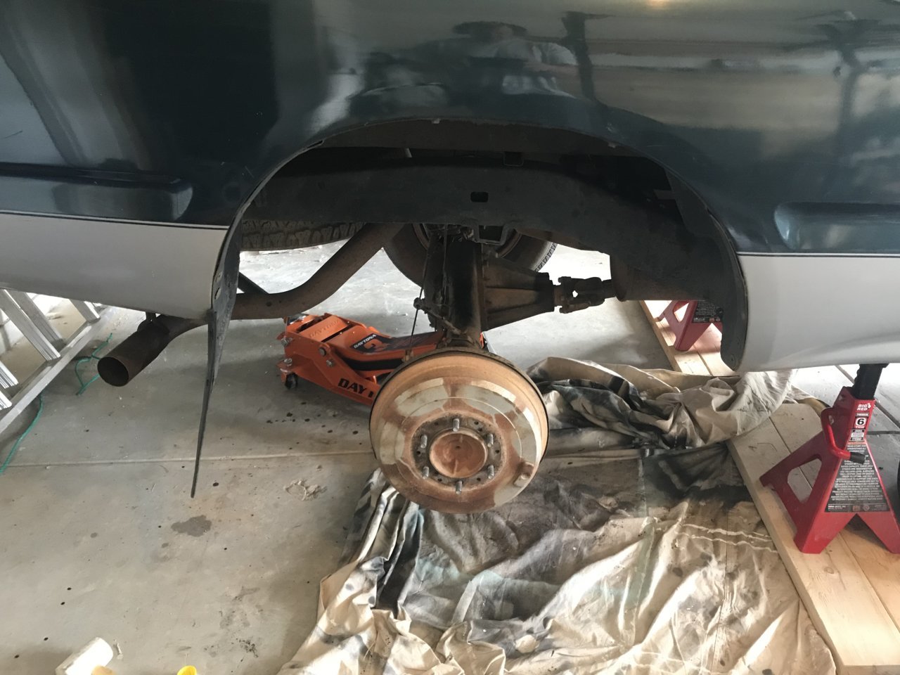

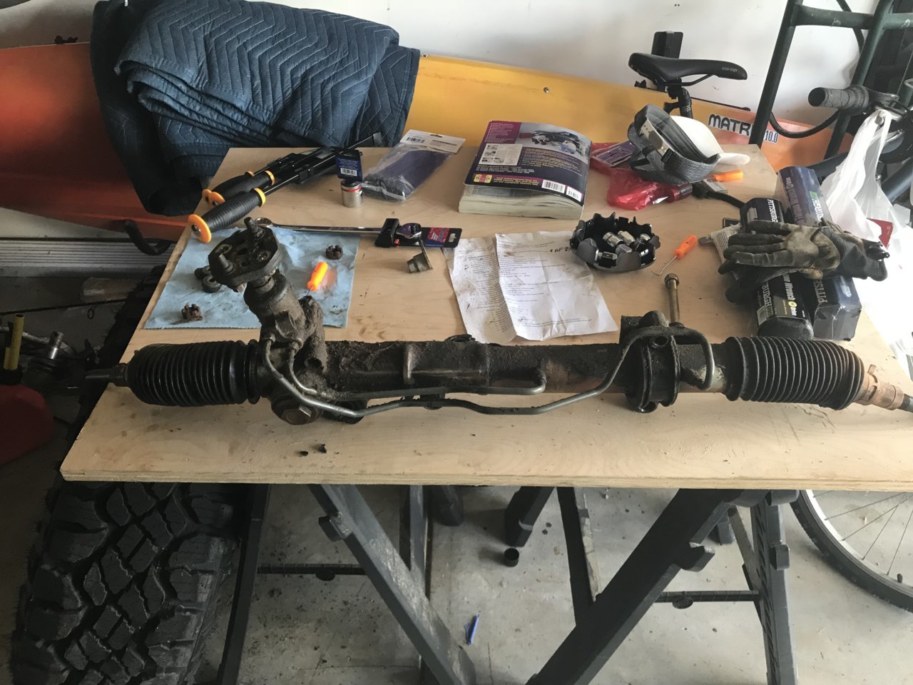

    Put a lot of time (and $) into the truck since the suspension and tires. Got the tires from 4wheel parts, but the couldn’t do alignment due to several steering components being bad. Here is list of things since then:
    Front diff drop
    Steering rack
    Inner and outer tie rods
    Lower ball joints
    Steering rack poly bushings
    Sway bar poly bushings
    Lower control arm white line bushings
    Spent 4 million hours cleaning out old oil and mud caked on everything from years of neglect.
