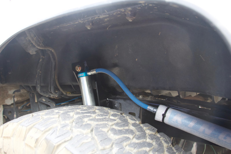

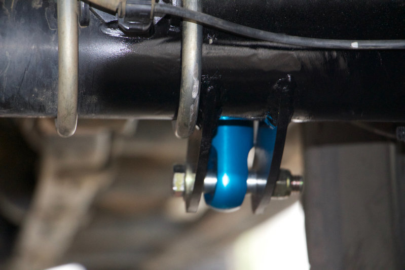

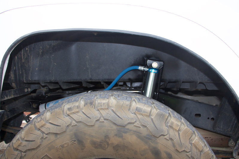

    You didn't come to my build thread to read about my experience with Firestone, so here is some good stuff:

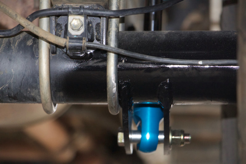

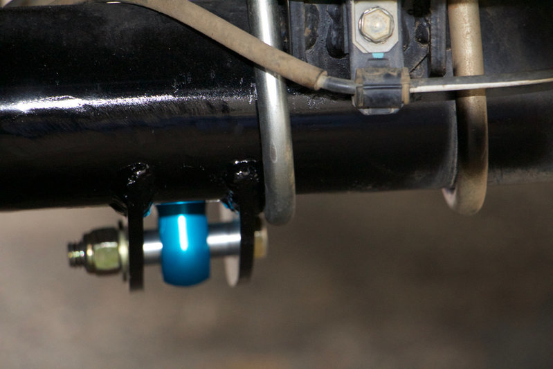

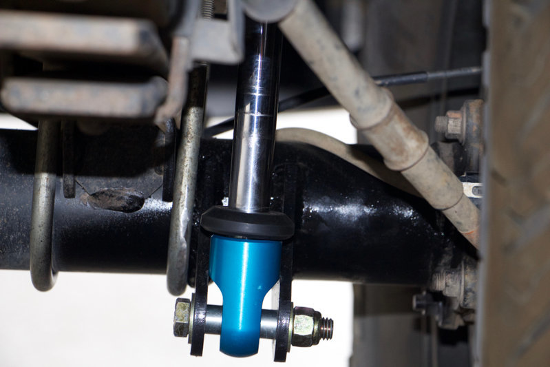

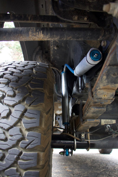

    Need to get some hose clamps to permanently affix the resi's to Jason's custom mounting tabs
    Since I really wanted to avoid running spacers, we moved the lower mounting points as far inboard as possible.
    Need to test more flex but it looks good so far!
    We tacked in the mount, pulled the U-bolt, fully burned it on, then re-installed U-bolt to get it as close as possible

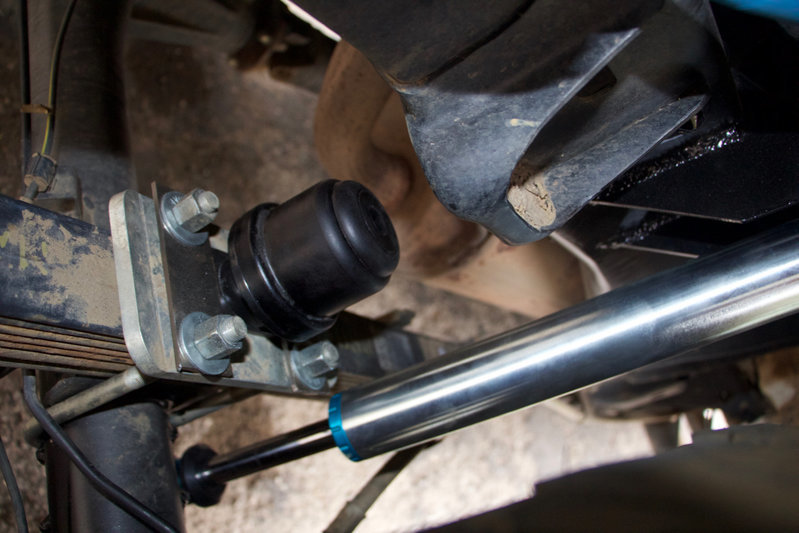

    And I actually helped! "Fabbed" up some brackets to hold my superbumps in place
    Tested a little flex and no tire rubbing the shock body, and no shock body hitting my u-bolt flip plate. I have 4.5 inches of shaft showing at ride height, with 3.5 inches of travel until full bump. Will post flex pics soon! Thanks again @glorifiedwelder !

    Awesome! Haha I did the same thing to hold my super bumps in place

    Are you running the 3/8" spacers on the rear?
    Shmellmopwho[QUOTED] likes this.

    For the bumpstop?

    Yeah.

    Nah, I don't have the spacers. I need them for up front though. I need to limit my travel slightly so that I don't hit the inside top of my wheel wells

    I just put them on up front to avoid the same thing, and have them for the rear but not sure if I'm going to put them on. Need to test!
