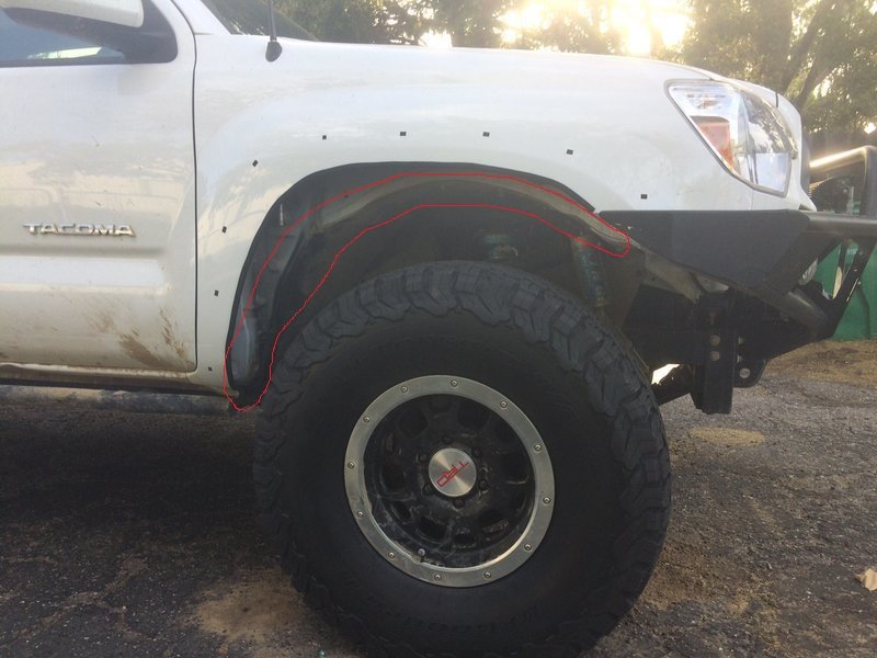

    Did you have to pound any of the below spots to get your 35's to fit on full bump/lock?? I'm assuming yes, since my 295's barely fit, but i just wanted to ask...

    Only between 9 o'clock and 11 on the photo, had to get pretty friendly with the 6lb sledge... I added some 3/8" bumpstop spacers to avoid rubbing the top section, so far so good

    Interesting......with my setup I'm insanely close to rubbing between the 2-3 o'clock position in the photo...
    Thanks :thumbsup:

    With the wheel straight? What is the spring rate of your coils?

    at bump, full lock left/right. Coils are 700lb
    bad pic, but you can kinda see what I'm talking about here:

    Looks like you're in for more :sawzall:

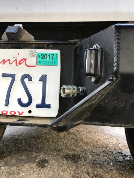

    Routed my OBA to the rear bumper yesterday. Now my dog doesn't have to get out of the back seat when I air up!
