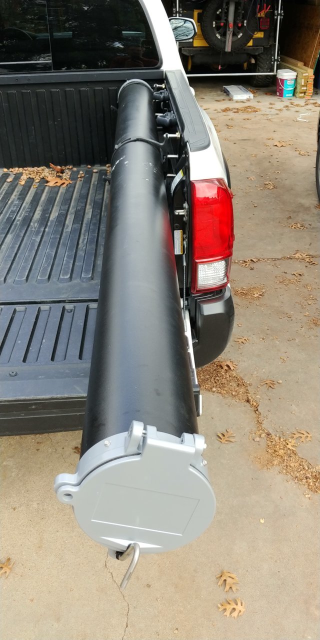

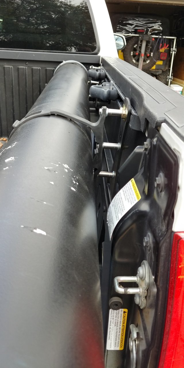

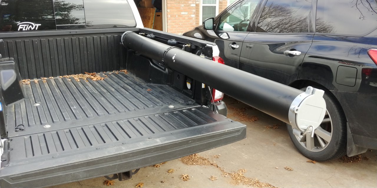

    Finally finished this project, but plastidip was a bad choice. Will remove it, and use a bed liner coating soon.20190113_111511.jpg 20190113_111517.jpg 20190113_111524_HDR.jpg 20190113_111535_HDR.jpg

    I'm thinking of making something similar to that but I want it to sit above the bed and so I can still close the tailgate. Do you have a writeuwr or what you usesto mount it?

    https://www.amazon.com/gp/product/B00B2HP1A4/ref=ppx_yo_dt_b_asin_title_o06__o00_s00?ie=UTF8&psc=1
    and some 6" PVC i got locally at a plumbing supply store
    then these slightly modified
    https://www.relentlessfabrication.c...cts/05-tacoma-bed-rail-dual-quick-fist-mounts
    to accept these:
    https://www.amazon.com/Super-Quick-...F8&qid=1547412544&sr=8-3&keywords=quick+fists
    the relentless fab only has 2 holes and the dont line up with these quick fists.
    had to drill 2 holes on each.
    also, had to use a 1 1/4" spacer to clear that hump, seen here:
    had some stainless 2" bolts from another project laying around that i used to attach it all.

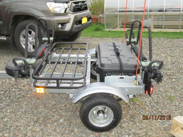

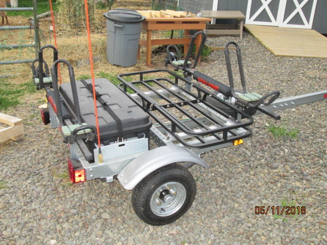

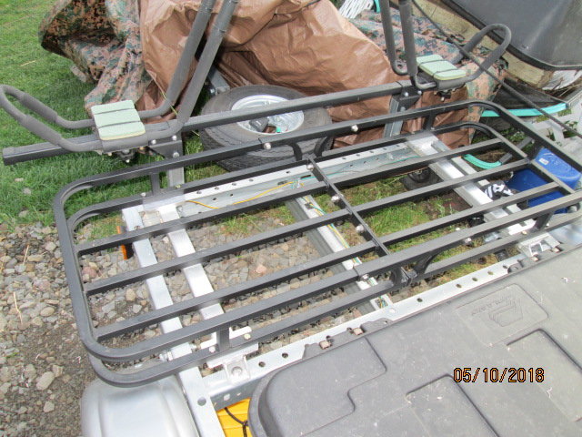

    I am really digging this setup. Do you have any details on the build?

    The basic trailer is a Malone Xtralight. I added the cargo trunk but it does come as a kit but it's expensive for what it is. Rather than the kit I pieced it together after I found the individual components. Cost me maybe $65 or so as compared to the kit at $110. The cargo rack is a Harbor Freight hitch rack and I just eliminated the center bar that would slide into the hitch and bolted the 2 sides together. I used aluminum rectangular tubing to raise it a little to clear the fenders. I did have to drill some holes in the rack to secure it to the rectangular tubing. All stainless hardware was used. I also added the spare tire and mount because none of the trailers come with a spare. To hold the kayaks I opted for the TMS kayak cradles as they were the cheapest and had good reviews. The orange marker poles are actually from Walmart and fitted with quick disconnects because they would interfere with the kayaks. I put them on when I have to transport the trailer empty like getting it inspected and such just so I can see the empty trailer while towing.....Traiker Rack 001.jpg Kayak Trailer 002 mounting.jpg Kayak Trailer 002.jpg
