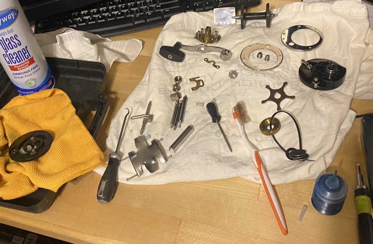

    I got this apart, and it’s not that the brass shaft is bent, but it’s worn. It’s also starting to round off at the “D” such that the handle’s not staying put.
    Any how this appears to be a genuine American made Penn 10 “Mag”.
    I have a proper set of tools for gunsmithing and so getting this apart was no trick at all. Getting it back together will be only a little more difficult. I used penetrating oil to clean everything but the glass cleaner takes any rust off the chrome. This reel didn’t have any rust to speak of. Just a spot & a lot of smut.
    To make sure I would get things back in order I put a zip tie thru the clutch pack, gear, and thrust washer.
    I also took a few photos and watched the obligatory YouTube video.

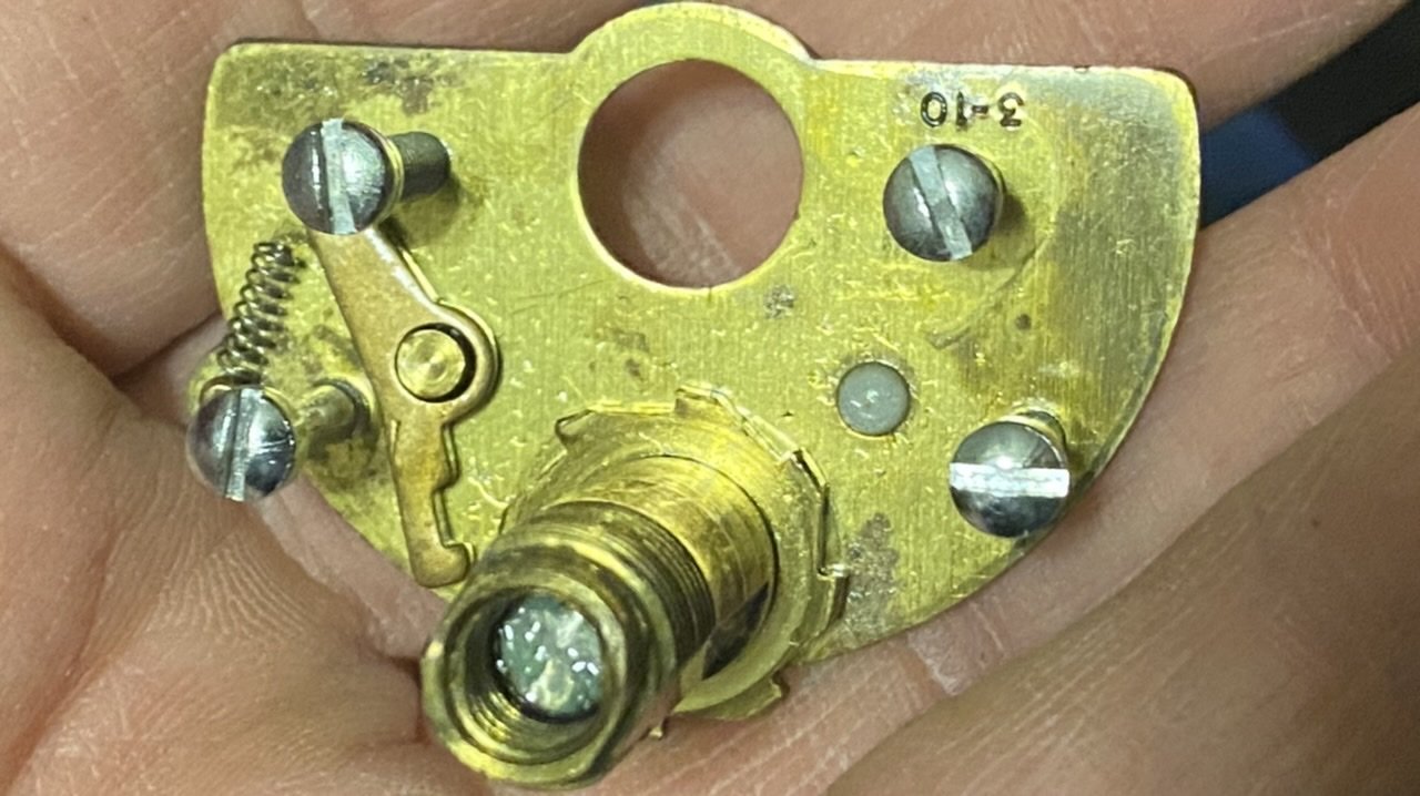

    My parts came Yesterday and my reel is back in action.
    If you get frustrated easily, this is a job I would pay someone else to do. Even with an exploded diagram and the educational YouTube video, it is still a tricky business to overhaul this reel.
    I only had to take it apart about four times until I got everything installed correctly and tuned up a bit.
    It’s easy to get the clutch discs out of alignment assembling it, and also I had a part upside down. You can see it in the picture of part 3-10 above: a little lever that runs the ratchet. There’s another part that locates the pinion gear and I took the reel apart once to reverse that, as I thought it would make the reel a little smoother. It had a slight wear pattern in it. Also the part had a slight cupping from the stamping process.
    After lots of cleaning and oiling and greasing and I am really happy with the way this works. The clicker is really loud though and I was thinking I might trim it down a little bit.

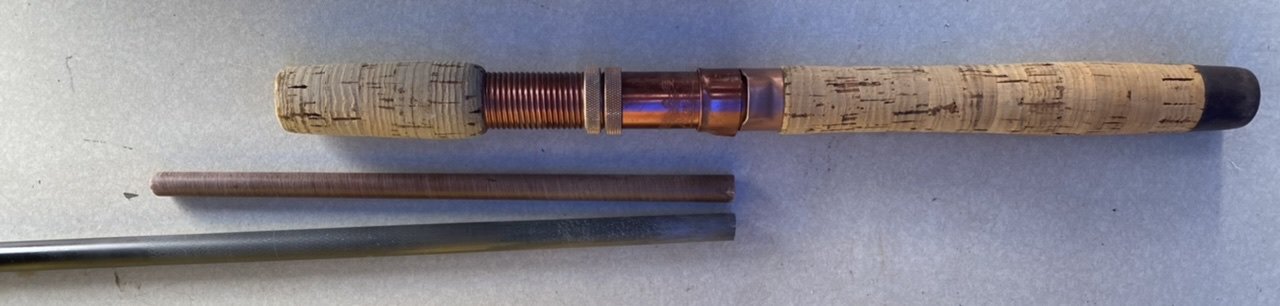

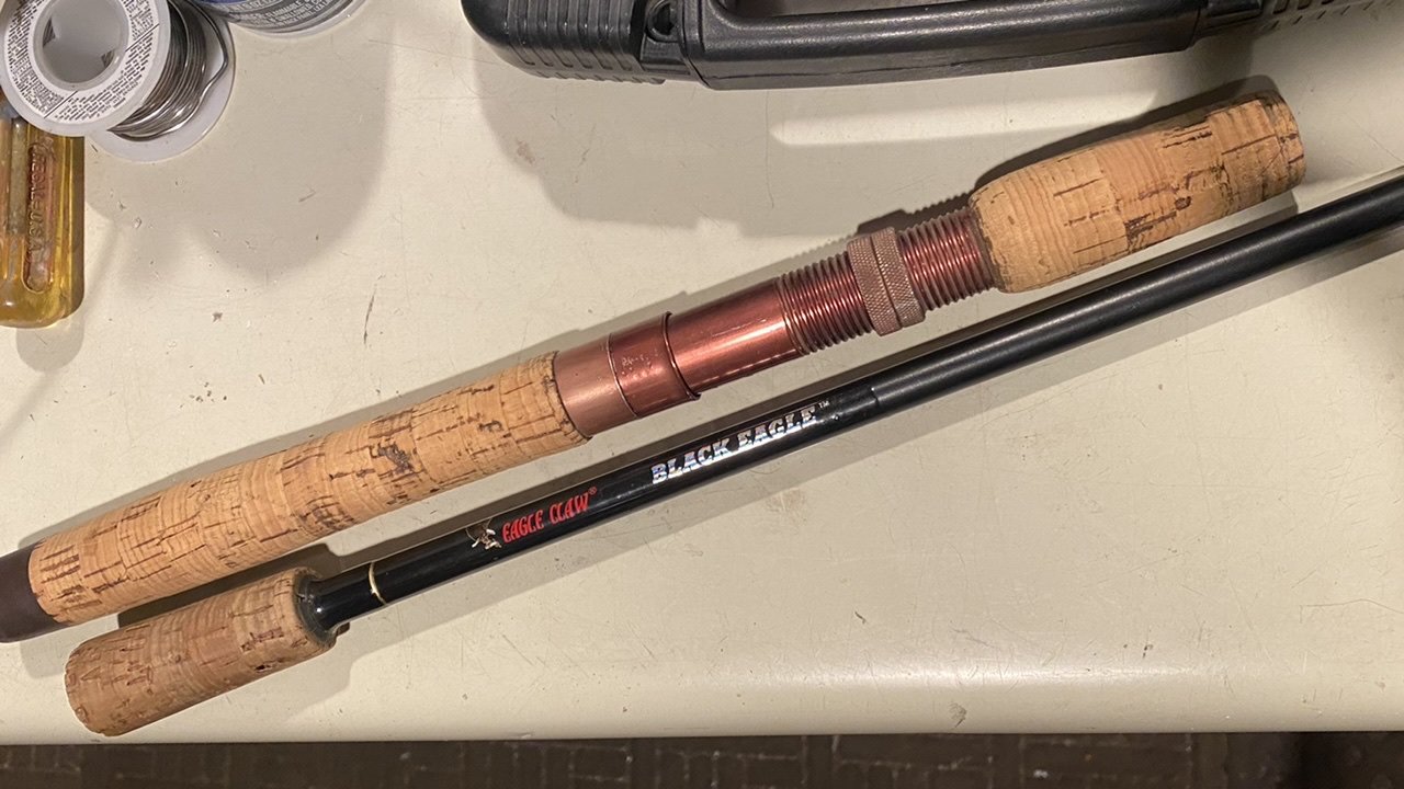

    I have a “special” fishing rod I’m going to put it on, which is a 1972 Fenwick with all metal hardware & cork handles. Unfortunately it snapped. I’m going to get another Fenwick rod and do a transplant.
    New carbon fiber Fenwicks are definitely nicer but they have plastic threads on the handle. This was my first fishing rod, and I am going to rescue it for sentimental reasons, and because it’s not plastic.

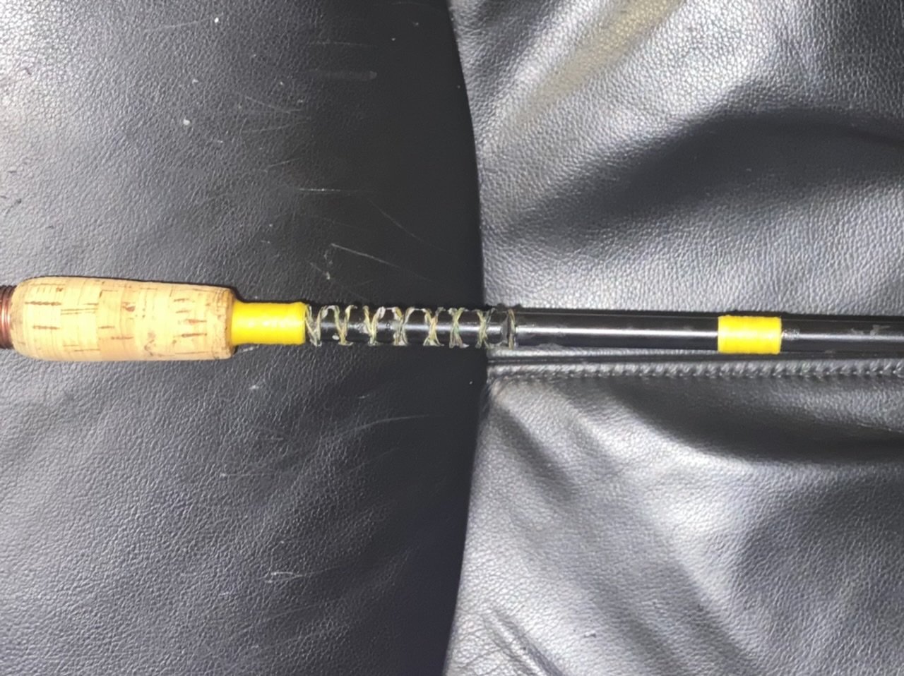

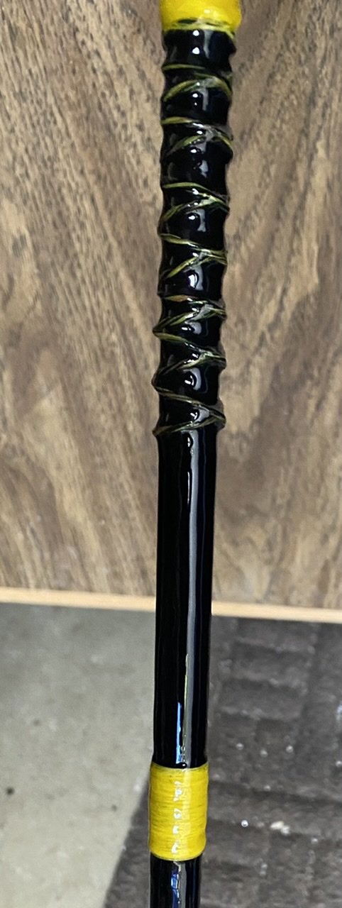

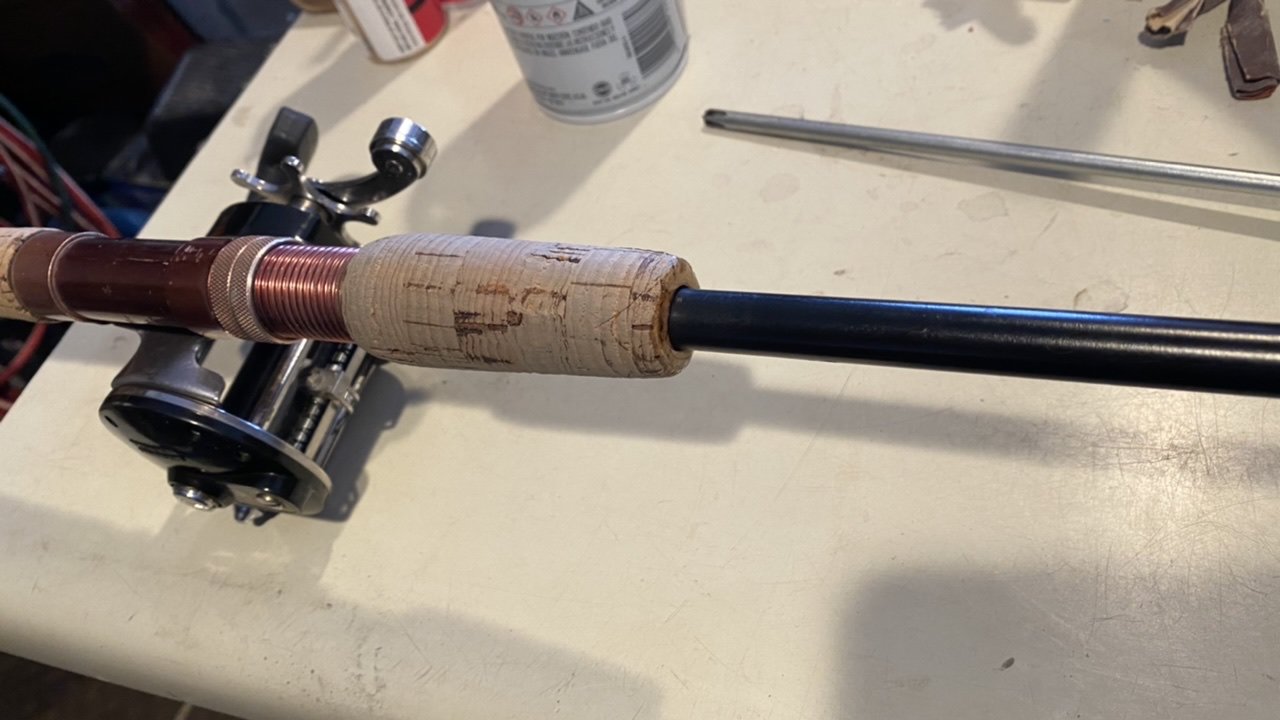

    The lacing and threading didn't come out perfect, but it just needs to cure a few days. I have other rigs for fishing ready to go.

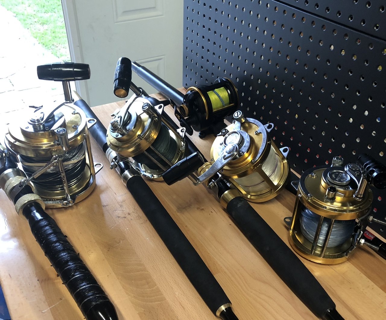

    Reels serviced this week:
    Penn International 50W
    Penn International 50W 2 speed
    Penn International 50TW
    Penn International 50VSW 2 speed
    Penn International 80W
    Penn Squall 30LD
    Daiwa BG 4000
    Shimano Stradic 3000FI
    Daiwa Fuego 2500SH
    Daiwa Fuego 2000SH
    Offshore Angler Seafire
