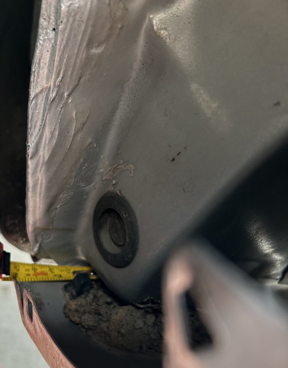

    At rear bottom of front fenders, it goes back about an inch before the cab mount. Unless getting a CMR, I'm guessing start with 1" front and rear to keep it even.
    So right now that is my plan.
    Tape and mark fenders 1" back, cut with jigsaw.

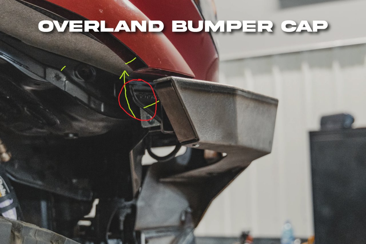

    Make sure front bumper installed per ARB guidelines; unfortunately they say hang it low to allow room for flexing during recovery. I believe 10-15mm gap.
    After cutting fenders with jigsaw, for appearance will find where ARB top meets (overhangs) the fender, tape mark and cut with grinder.
    Not inch(es) evenly off the bumper, but a triangle cut at an angle. To avoid cutting into the crash reinforcement brace that's hidden inside it at the bottom.

    I just noticed, the C4 kit appears to end up being cut (fender) exactly where the "Toyota triangle" (let's call it) ends.
    To remove any protruding.
    IDK what it's real name is. But basically any time you get a steel front, or at least an ARB, it reveals that ugly triangle, which is why the instructions included say during install, scuff it up and paint it black to hide it.
    I think I'm gonna measure out to the triangle, trim excess, then copy that on the rear so both fenders look the same, start at that and go from there.
    bumper I'm obviously gonna have to use a grinder due to thick metal

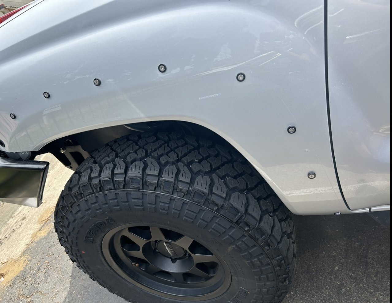

    but if I had to guess by looking at the above C4 pic before I go look at the truck again, I *think* the "toyota triangle" would result in about 2" of cut. So you're probably right.
    At this point, 1" would likely be small, negligible, a waste of work
    and leave a big ugly fender with no tire gap making it look more like a streetcar than a truck
    2" will probably mimic a stock or close to stock clearance gap

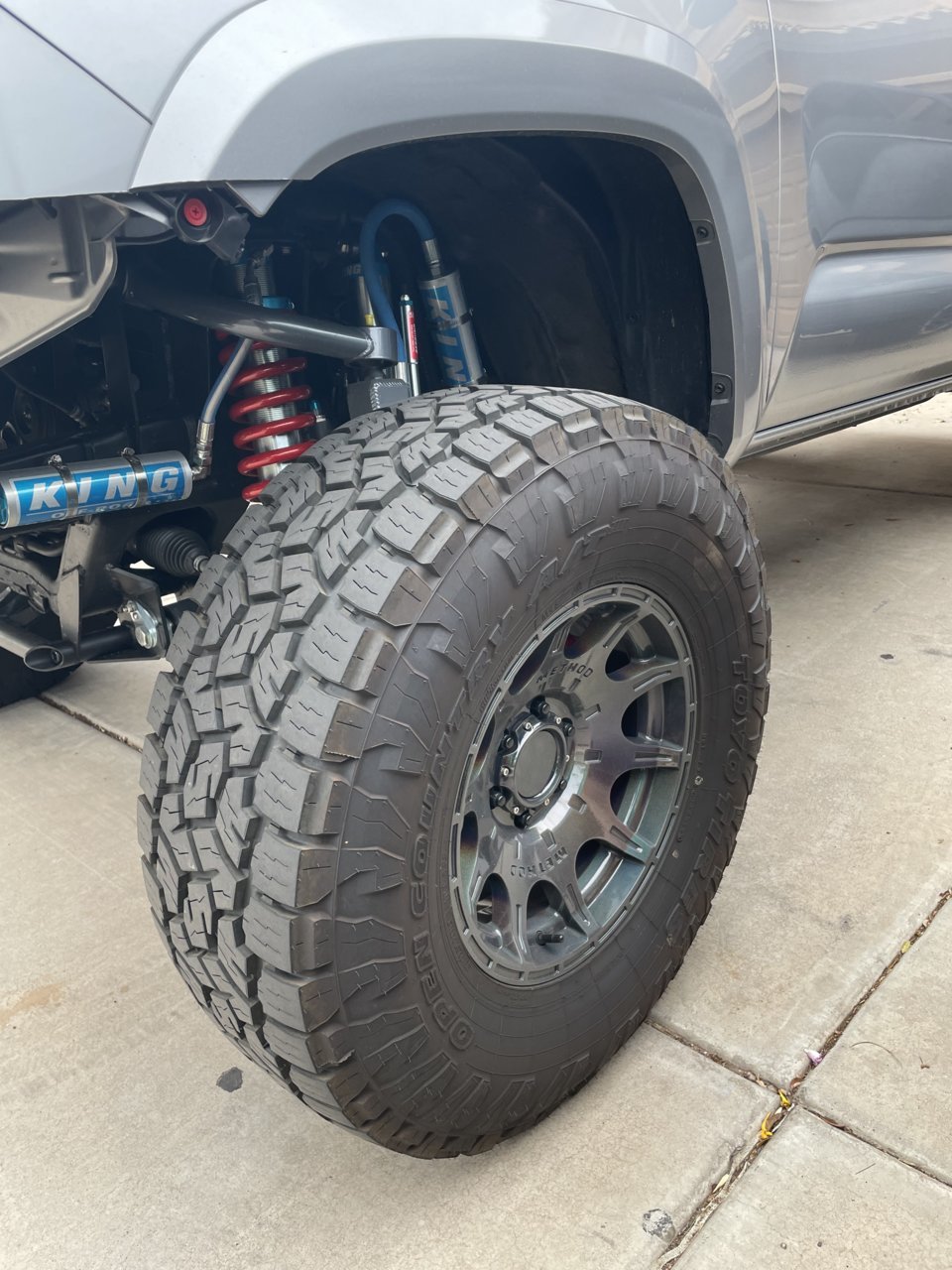

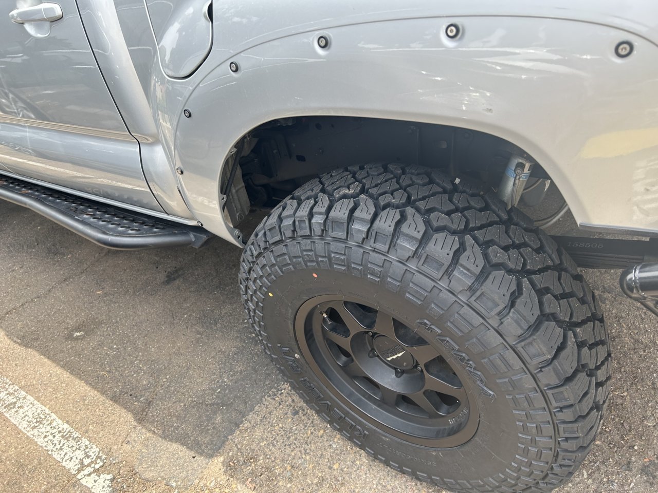

    1st is a 35 with a lift spindle with 1” of clearance from the fender at full bump.
    2nd is a 33 with outer fender cut around 2” and there are rub marks on inner fender at full bump
    1st photo is for reference of what 4 inches of lift can do in a 2wd situation

    the “Toyota triangle” sticks farther from the fender than I thought. Over 3”IMG_6765.jpgIMG_6766.jpg
