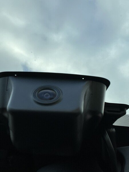

    I like my FitcamX - just in the front. I would want wireless for the back (I have a Leer Shell). But that's a drag because we all have a camera already in the rear. Right? So I just bought a "ANYTIME FRONT AND BACK Camera setup". The front cam needs to be installed at the grill below the Toyota logo, and wired to the computer, and then there will be a switch on the left dashboard area where you then can turn on the camera front or back and look front or back anytime you want too. So back to the Dashcam issue, it would be much more practical to program and equip the computer with the recording "anytime" and "all the time" because those cameras are there anyway. While I am not able to do this myself, I am sure some people out there are.
    The only problem I see with it is that to make sure it is running and in operation correctly I need to turn on my FITCAMX app on my phone connected to the computer of the car. If caught the camera recording system not functioning at times. And needing to download a video file and not finding it because it didn't record anything is lame. A few times already I was on the road already for an hour or so and then looked at my dashcam file and couldn't find any recordings for that day. This never happened though when I loaded up my app first thing after starting my truck. Always works.

    You can look by rear view mirror and see if blue lights are flashing. If no lights. Could be a different firmware. I’ve never had an issue..

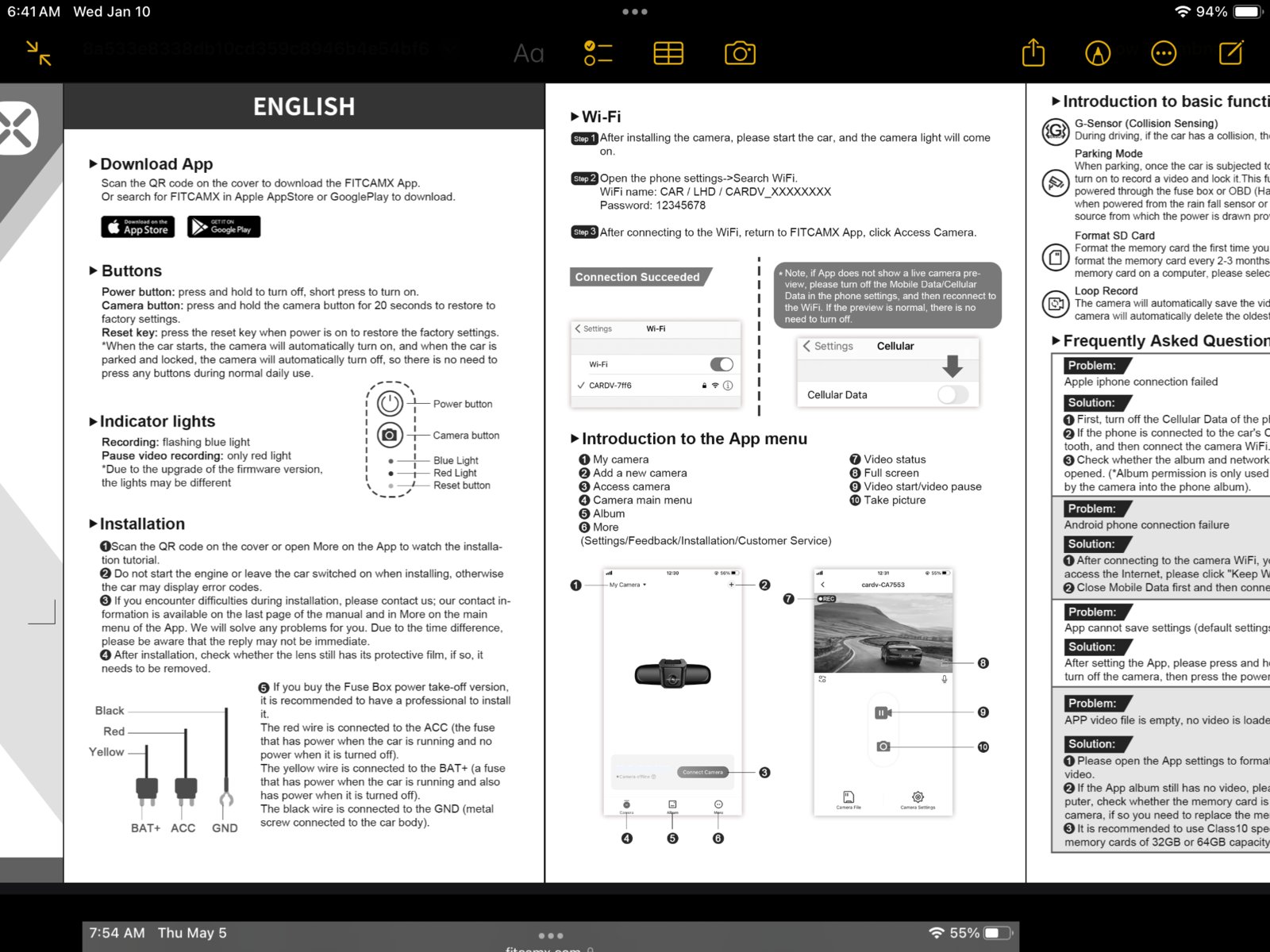

    Late reply sorry. I reformatted the Samsung card that I was using and it seems to be operating fine now. The manual actually suggests to format the card every 2 to 3 months, I didn’t see that originally.
