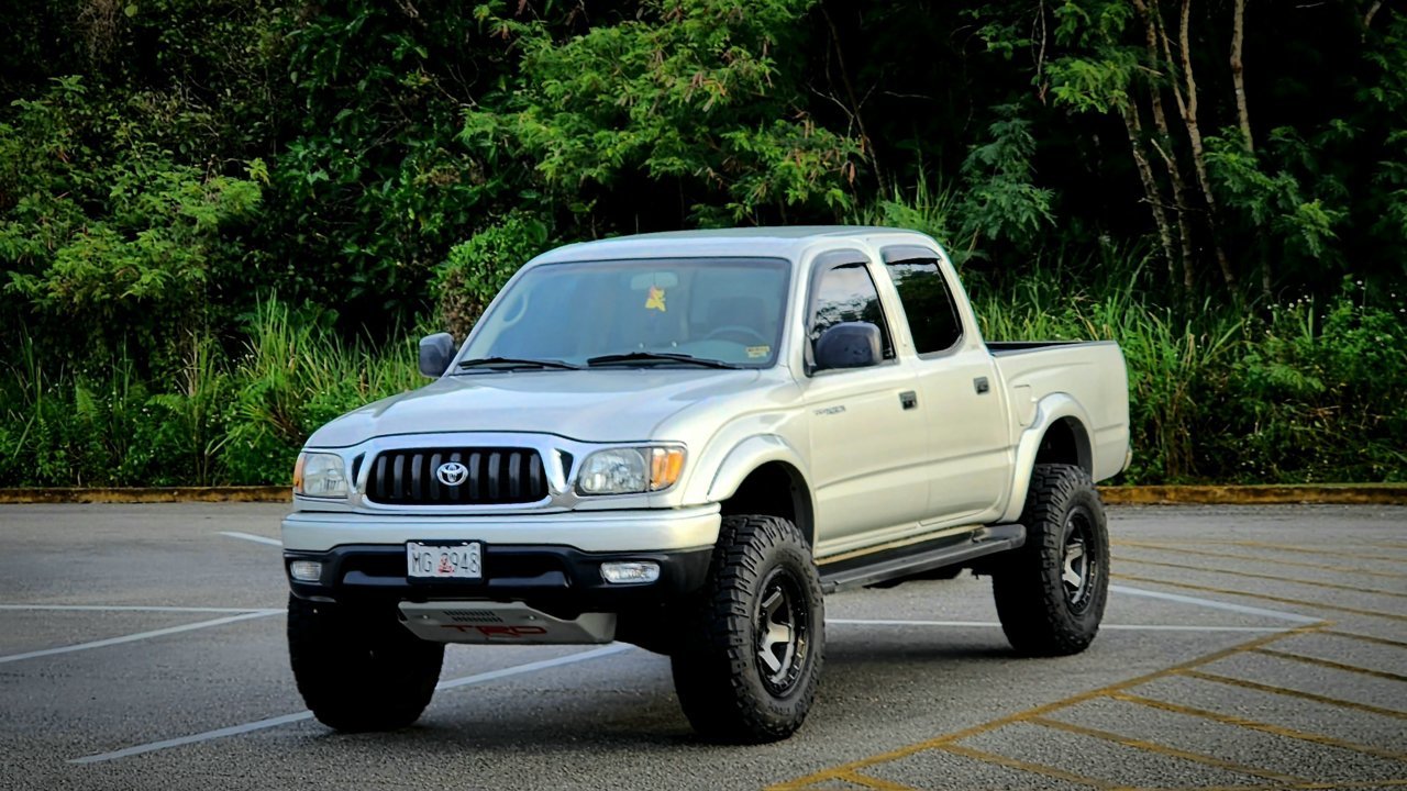

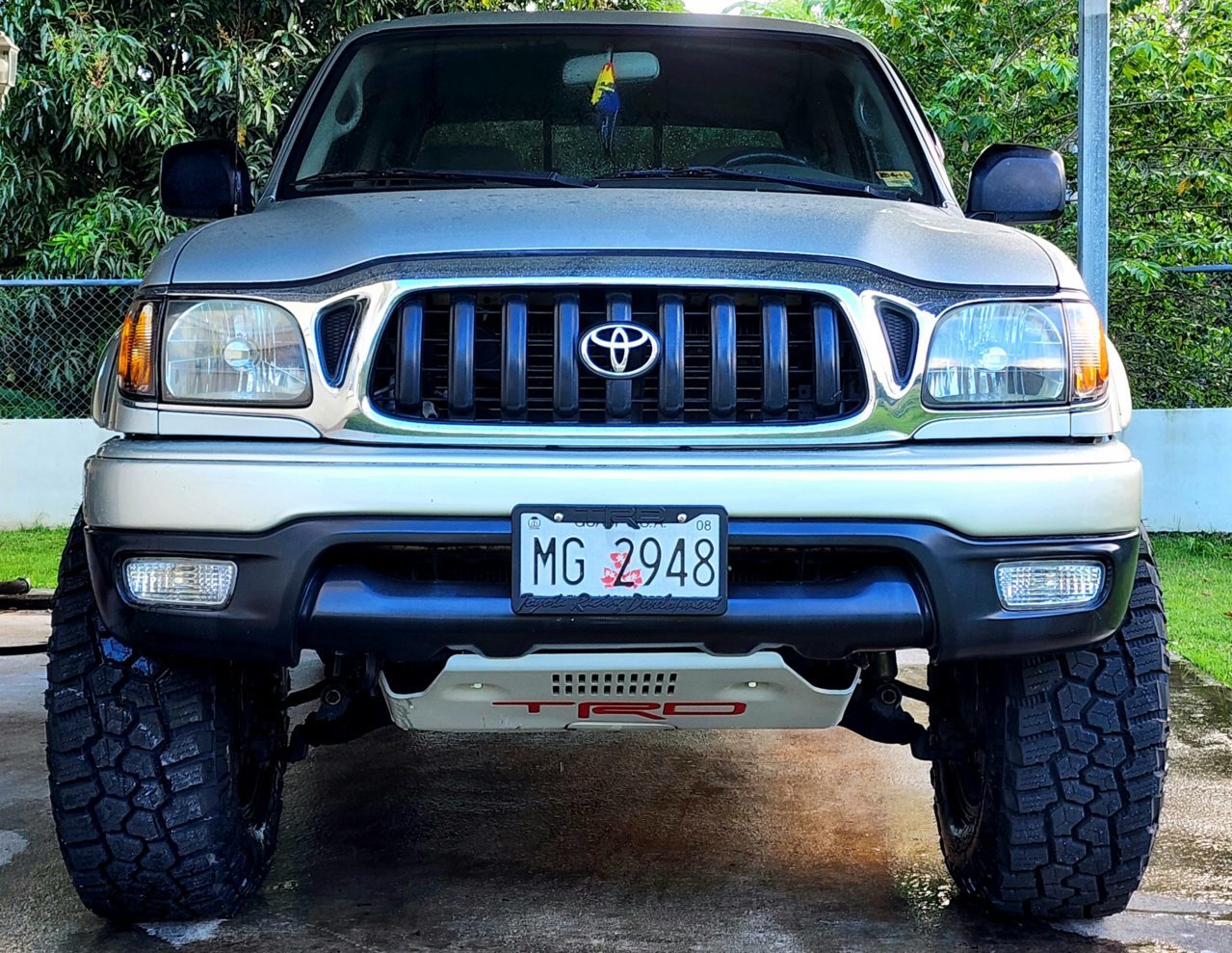

    Used a 2020 tacoma skid, cut off the Trans skid part, trimmed some of sides and remounted to existing skid mounts using L bracket up front and flat brackets on rear. Rock solid doesn't budge at all.
