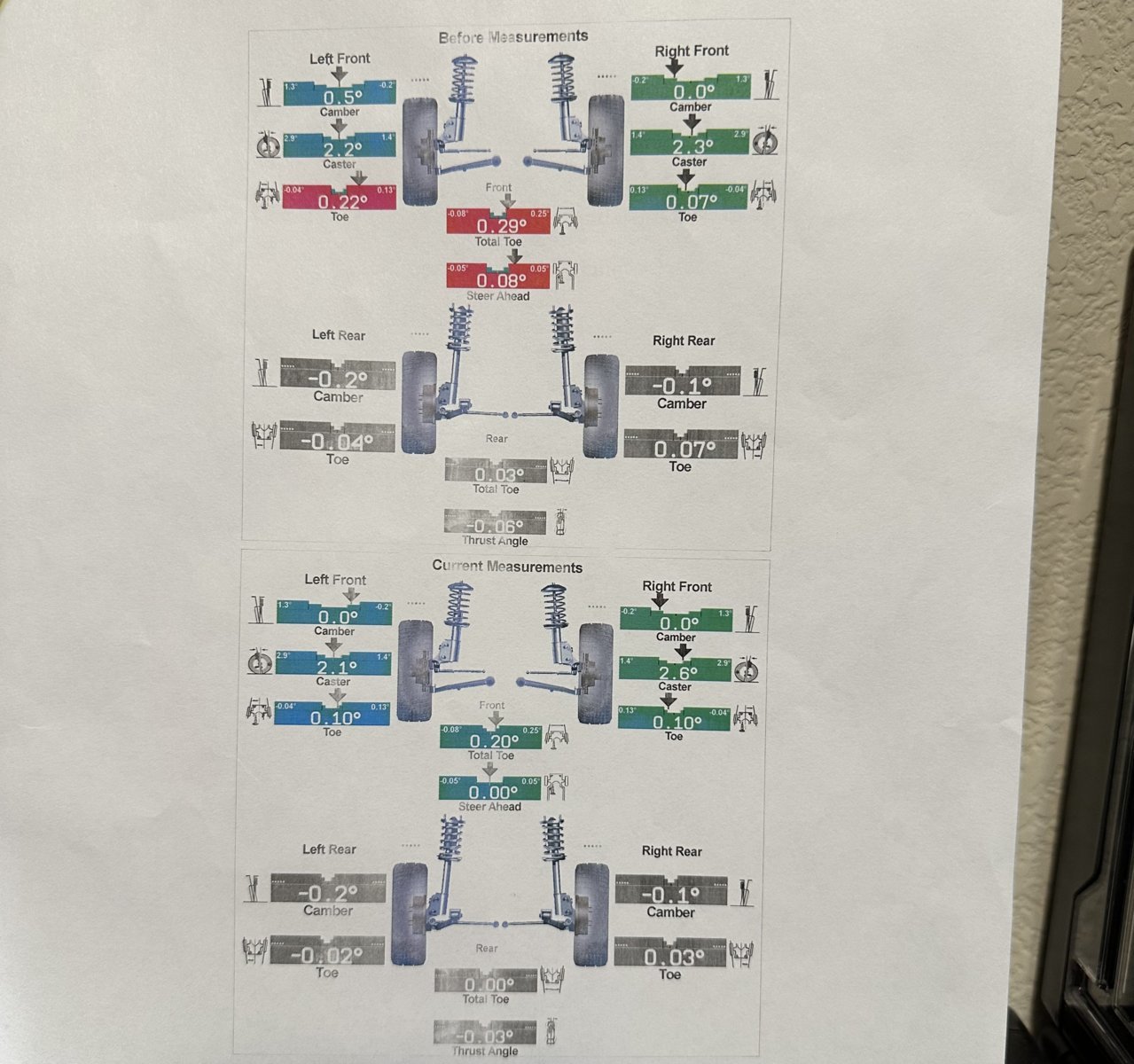

    Been searching around and I can't really find any definitive answer to this...
    I've just completed a 6112/5160 lift with 285/70r17 tires on -10 offset wheels (yes not ideal for clearance but I prefer the look).
    I was planning on getting a CMC which will cost around $300, but I'm wondering if anybody has been able to clear tires of this size on this offset just by aligning properly and using aftermarket UCAs... SPCs or maybe even a non-adjustable option.
    Basically... if I allocate money towards UCAs and can push my caster much further on the LCA adjustments (since the UCAs should correct the camber issues that come with doing that on stock UCAs), would it be likely to fit my tires in full stuff or is the CMC probably inevitable no matter what?
    Thanks

    Seems to vary a lot truck-to-truck. I just installed -10 offset wheels (SCS F5) with 285 70 17 tires (KO2s). I have a little rubbing on the cab mount when wheels are turned and suspension flexed. I have an appointment to get my SPC UCAs realigned on Thursday, pushing the wheel forward.
    I can check back in, but I'm expecting the alignment to fix what little rubbing problems I'm having - although did have to trim the rear part of the wheel well, and remove the splash guards up front.

    Enough caster and alignment will get you close but you will eventually get the CMC but you can get away with it for a bit for regular and mild offroad. I had the SCS -10 setup when I first started ( 17x9) and 285/70/17.
    I would def consider the UCA. at first it will pull it back to the wheel well but if you get around 3 degrees it will give you room then previous replies apply when you go offroad. The worst case is you could cut off the part of the cab mount and then weld on a plate later on. I've seen this done in a crunch before.
