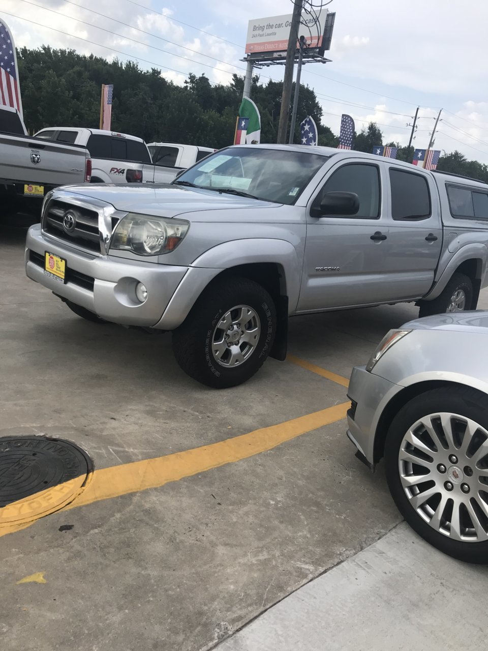

    Hello everyone, I am new to the Tacoma world, as I just bought my first Tacoma a few weeks ago. I have a 2009 TRD offroad double cab with an ARE c amper shell on the back, everything is in great condition except the tires which are dry-rot (265/70/R16 general grabber A/T), so I want to upgrade to bigger tires but I cant afford new wheels at the moment.
    I have researched for weeks everything from suspension kits to tire sizes to tires themselves but I couldn't quite find the solution to my problem.
    As of right now I currently have Bilstein 5100s' with OME 887s and an rear AAL on the way. I am estimating this should put me at a 2.5" lift all around.
    I want to keep factory uca and trd offroad wheels while avoiding all rubbing.
    I understand that I will need to do CMC and trimming on the fender lining and removing mudflaps.
    I plan on getting spidertrax 1.25" spacers all around to hopefully prevent rubbing on the uca
    The tires I plan on getting are 285/75/R16 nitto ridge grapplers
    Do you think this will work without rubbing or needing any other components?
    I plan on doing all the work in one weekend so Im trying to avoid any surprises.
