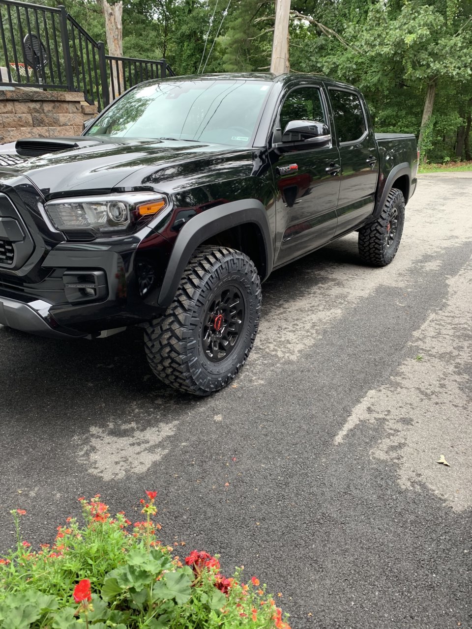

    Hey y'all! I just ordered a set of Ray 10s (17x8.5) for my 2018 Pro that's currently stock. From the specs it looks like the final size and location of 285/70r17 Ray10s should be very close to 285/75r16 on Trd Pro Wheels. Has anyone put this set up on their rig (ideally Pros, but open to input from other trims) and can you share what you needed to do, if anything, to fit them?
    Here are the specs of both wheels:
    17x8.5 Ray 10s - 4.3in BS / +10mm Offset
    16 x 7 TRD Pro - 4.51in BS / +13mm Offset
    I know there are several threads debating if you can fit 285s on a stock Pro...that's not my question, as much as "Do I need to do more to my truck to accommodate the 285/70r17 Ray10s vs the 285/75r16 on Trd Pro?
    And of course real world experience would be great too!

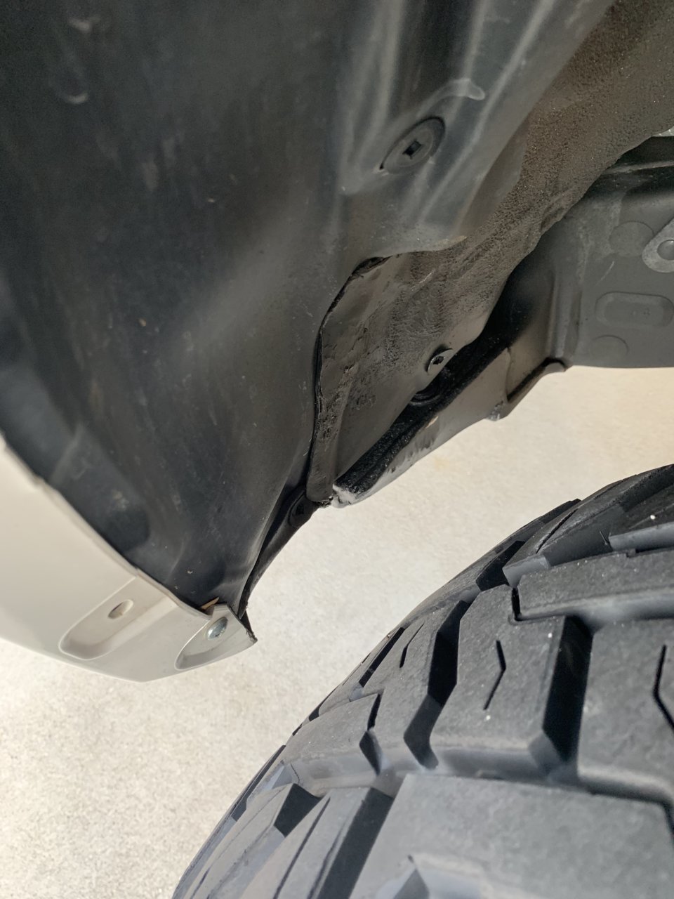

    I put Nitto Trail Grapplers on my stock 19’ TRD Pro. There’s some pretty serious rubbing in reverse especially with passengers. From what I can tell it isn’t doing any damage. I haven’t done any “serious” off-roading with the tires but I have done some and haven’t had any issues. I’m curious as to what pieces I can move in the fender well since I am new to off roading and haven’t modified a vehicle like this before. Do you guys just remove pieces? What would cause the rear wheels to rub anything? To me it seems like it would require tremendous travel to cause problems.
    Overall: I’ve had essentially 0 issues with road driving in 1,500 miles. Minus the absurd drop in MPG....
