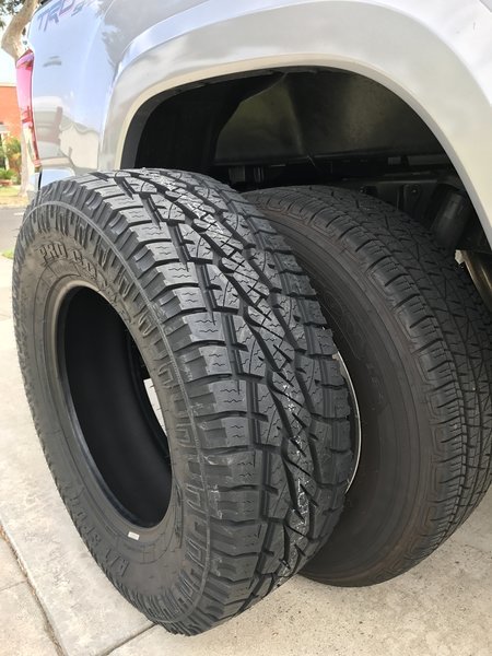

    I ordered myself a set of Vision wheels
    R17 X 8 +25 offset (the stocks are R17x7.5 +30) to make up for the wider rim although it'll seat 0.054" closer in, with Pro Comp A/T Sport tires LT265/70R17E, if the set rubs I'll add a 1/16" shim behind the rim.
    Also if I ever want to go with the 285s I'm thinking of a 1.25" spacer.
    I hope this helps you decide (I spent a week of researching and some math)

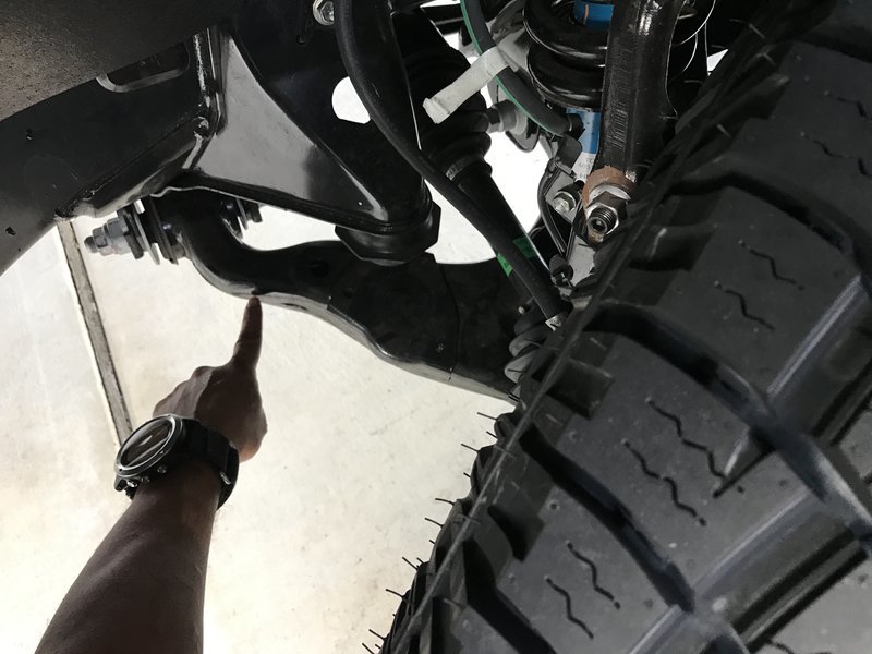

    Report: I installed Pro Comp AT Sport 265/70R17 & wheel 17X8 +25 and there's RUBBING, it happened pulling out of the tire shop, I can't imagine off roading, I might add wheel spacers, (see pic) stock wheel is R17X7.5 +30

    Current 5.484" stock was 5.43", keep in mind that this is the wheel alone. The tires are 265/70 instead of 265/65
    I hope this helps

    16 TRD OR DCLB
    Bilstein 6112 front, 5100's rear with blocks, camburg UCA, 17" XD's with 285/70/17 AT 3's and a blackout front grille.
    Did you put those wheels on already? I have KMC 17x9 with -12 offset and I tried putting 285's on and they rubbed super hard. Like turn the wheel 4 inches and they rubbed super hard. (I put 6112 bilsteins at the 4th notch which is little over 2 inches of lift.)
    I think 9 inch wheels with -12 offset does not work with tacoma's. I put 265/70/17's and they still rub at 80% turn of the wheel unless on completely level ground.

    Wow, I would have thought on the cab mount but on the Lower Control Arm?
    This is my set up compared to yours. Mine is rubbing on the Cab mount
