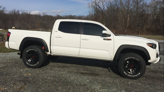

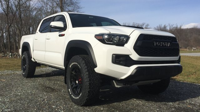

    OP, I was on the fence about 265/70/17 or 285/70/17 and I have zero regrets going with 265's. Ride feels like stock and fuel mileage is the same. Ties are pretty much flush with genders and with the factory mud guards all of the road crap says under my truck and not on it. Mine is also a daily driver and I didn't buy a 4x4 truck so I could worry about it rubbing. Good luck with your decision brother. IMG_1673.jpgIMG_1675.jpg
