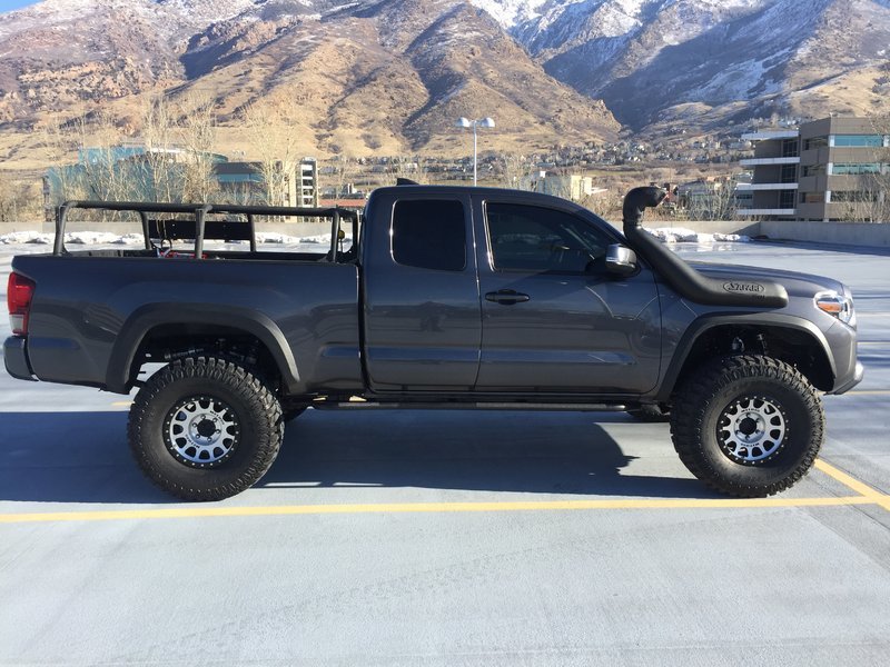

    I had a 2.5" lift on mine and 285's. I had trim a little piece of plastic and that's it.
    Yes, they even cleared off road and no rubbing. :)
    It's all in the wheels and the alignment.
    Biggums[QUOTED] likes this.

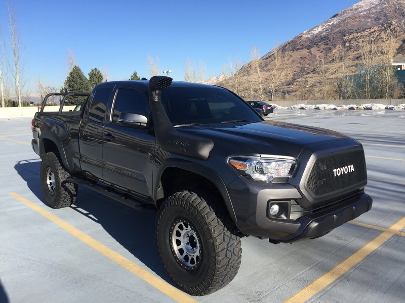

    Aug 15, 2016
    #194699
    5,708
    Imposter
    35's on a 2.5" lift. :rofl:

    Imposter
    Gabezz, batfeet, mikestaco17 and 2 others like this.

    It's got a cop motor, a 440-cubic-inch plant. It's got cop tires, cop suspension, cop shocks. It's a model made before catalytic converters so it'll run good on regular gas.
    35s are for parking lots
    erok81 likes this.
    lmfao at that snorkel

    Imposter
    Anything else?
    The bed rack is kind of dumb too.

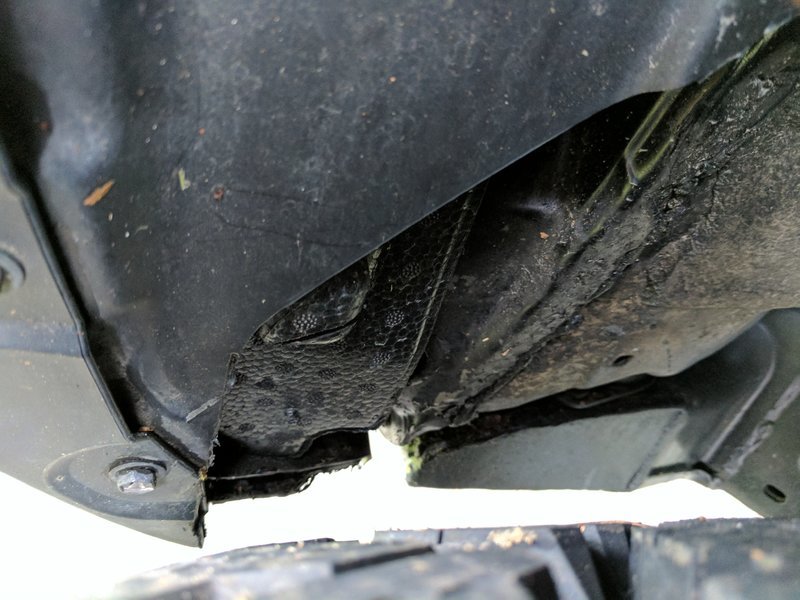

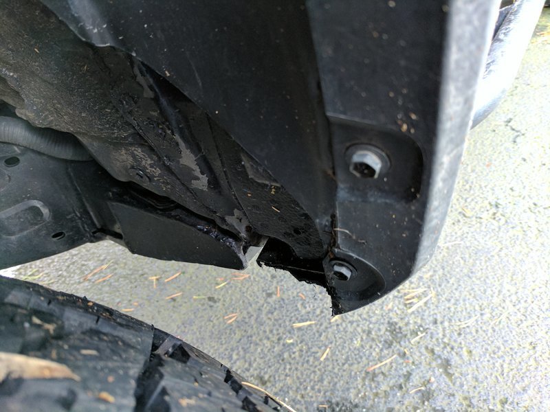

    Because of the ray10 offset, you will very likely have to do a good bit of trimming for 285s.
    This is with ray10s, duratracs, icons.

    Pushed out wheels can actually increase rub. It may push off the control arm and the cab mounts, but too much (e.g., ray10s) will place the edge of the tire right on the fender well in full lock unfortunately...
