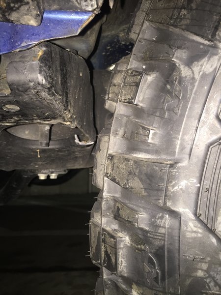

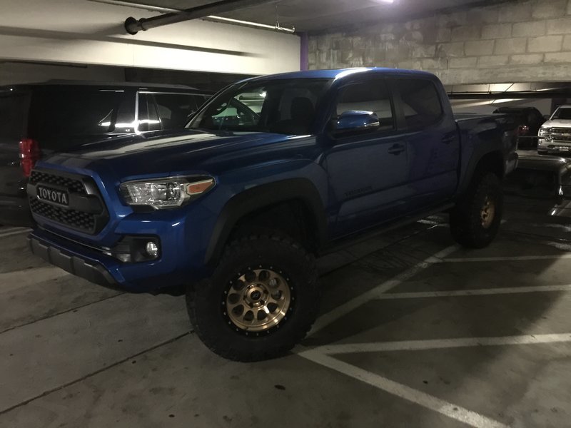

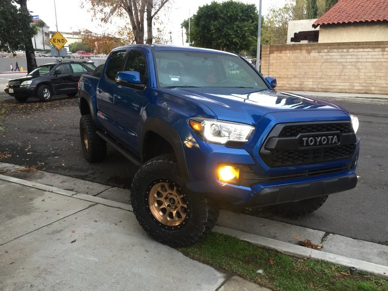

    Woke up to these and Jjst got this done right before I had to go to work. Pics suck but snow trail pics this weekend . No rubbing at turns or reverse turns does look close to the CMC when I turn my wheel all the way to the right (look at pic). I'll find out when I wheel this weekend if I rub anywhere else at flex . I current have the CMC if i didn't I think it looks like it'll rub. @Biggums

    Nice man! Yeah I'm already expecting a CMC this Friday. Truck looks good with the bronze man!
