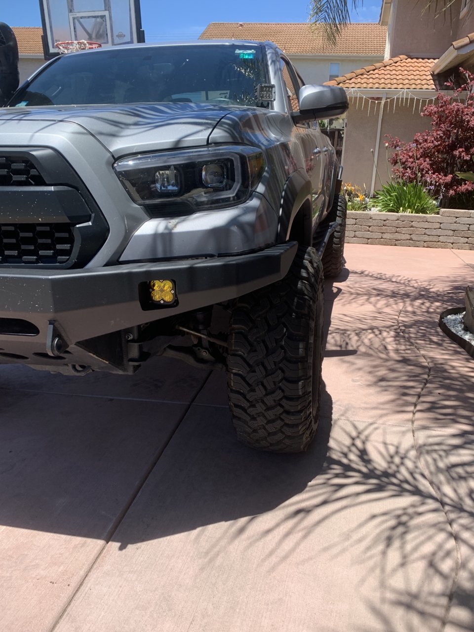

    Have fun. FDE79BB0-5622-498B-9393-BFE7625BFD51.jpg1B5DB056-515A-4070-AA8B-CF66807252F9.jpg

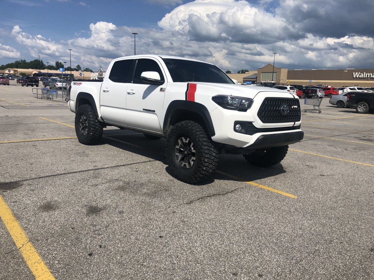

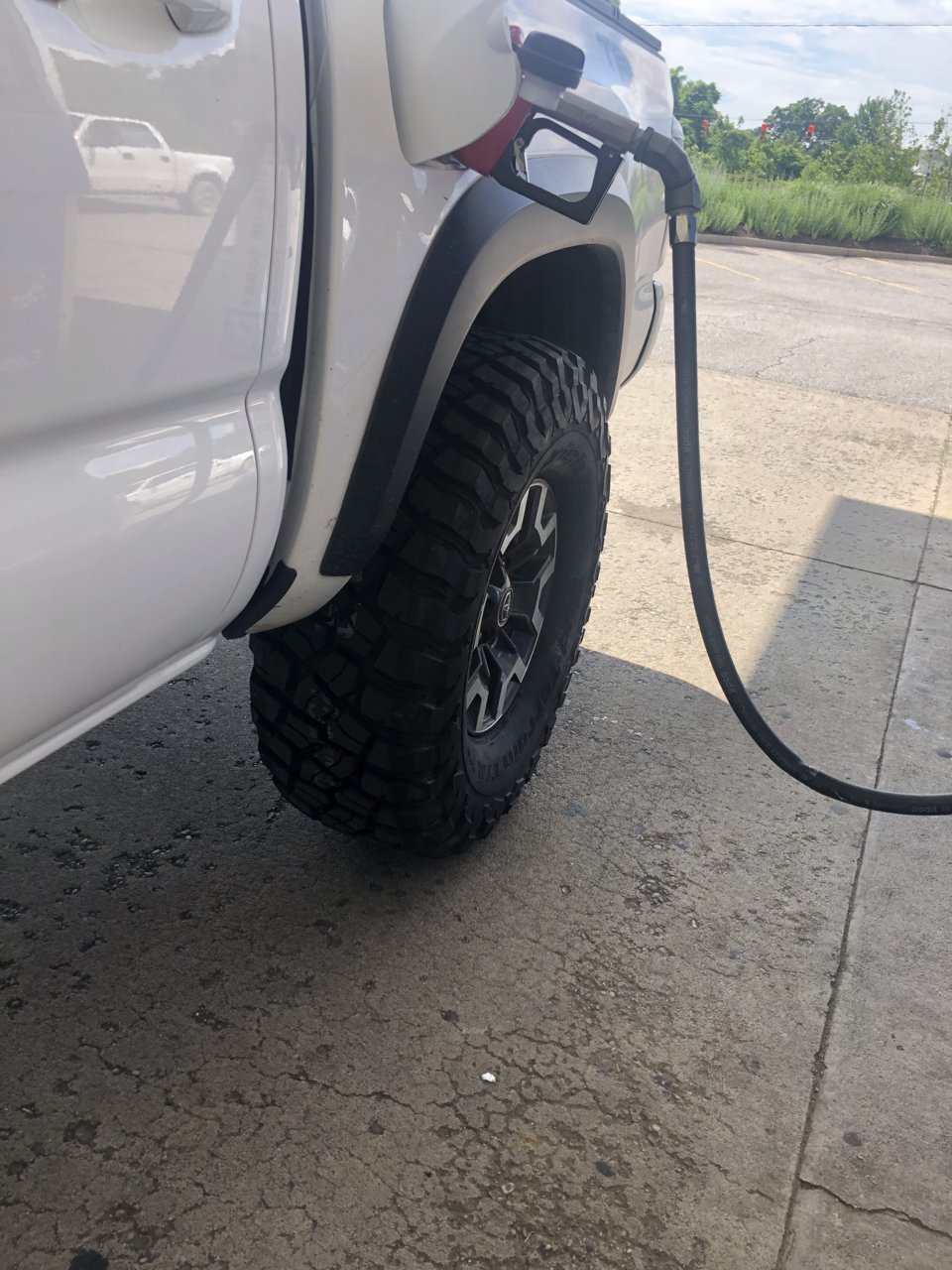

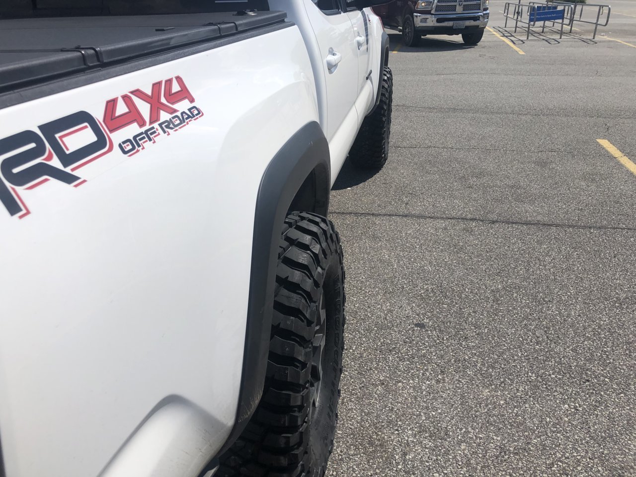

    Update: So I ended up mounting the tires on before doing the CMC. (Please read post before judging me lol) I did this for a couple reasons. 1: The shop i ordered the tires from is closing early due to the virus and my work schedule prevents me from getting there. So i would have had to ask a friend or family member take the truck while I was at work, which is a hassle and not to mention I don't like anyone driving my truck. 2: I live a little over an hour from the shop but work just a few minutes away. So i wanted to avoid an extra trip. 3: I happened to get off a couple hours early yesterday which give me the perfect opportunity to get them mounted on. It only cost me a few bucks to get them mounted so i figured the worst that could happen is i have them take them back off and lose out on a few bucks. So I ran an extension cord from the power outlet in the bed of the truck and plugged in an angle grinder with a small cut-off wheel (yes i keep a lot of tools in the bed, ya never know) turned the wheels all the way and cut some slits in the pinch weld. Hammered the pinch weld with best i could with the wheels still on. Took a razor to the bottom of the front bumper and followed the same trimming pattern as i done for the 285's. Just more aggressive. Had the tires mounted on. After mounting, with the spacers still on the truck, i could cut the wheel a good ways before rubbing the cab mount. No rubbing anywhere else. I even stopped at Walmart on the way home and was able to pull in the parking spot and back out without rubbing at all. I had zero issues going home whatsoever. I guess i just got lucky and bought one of the easier tacos to clear bigger tires. I done the CMC when i got home and finished the pinch weld. Waiting to weld the plate on until I get it perfect. I took it on a trail behind my house. There are some pretty large rocks in a creek bed. Went over them no problem. The only place u rubbed was when going at a downward angle, I pulled the tires on a big rock with the wheels turned and pretty much tucked the wheel all the way. It is rubbing by about an 8th inch or a little more. So I am going to take a little ore off later today and try it again in the same spot. Will take pictures of the work later. Was too dark to get a good pic when I got done last night. So far, no regrets. Love the look. Power loss was nowhere near as bad as i expected, so im happy there. Still getting about 16mpg. Not bad for E rated 315's. So it can be done without the CMC first. I guess it just depends on the specific truck. My buddy had as much rubbing as i did with 33x12.50s on his taco. My truck has always been more of on issue rubbing on the front of the wheel around the bumper. So I think my wheels are a bit more forward than most. Working in the automotive industry, you would be surprised in the difference from vehicle to vehicle. Some manufacturers allow 25mm differences in length from vehicle to vehicle due to stack up tolerances on parts. Ive seen vehicles 15-20mm longer when measuring from the driver side vs the passenger side. So i'm not surprised.

    I’m really surprised the tire shop mounted them on 7” wide wheels. Looks good though :thumbsup:

    Nice!
    We want to see the cuts!! lol
