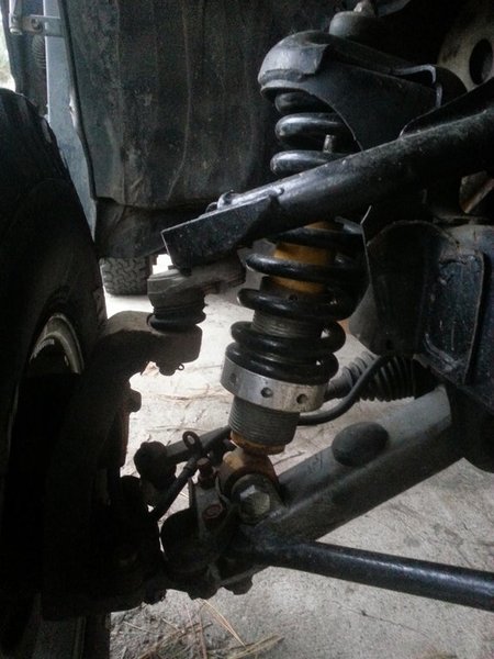

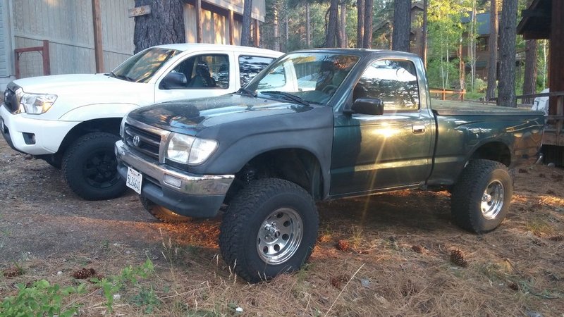

    My 97 has 3 inch spindles and downy 3.5 coilovers uppers and lowers. Also have glasworks fiberglass. And I can fit 33s no problem.

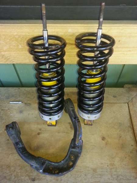

    It is a Downey off-road, taco supreme kit. It uses bilstien 4600 shocks with sleavs and Downey coils. It is considered a mid travel kit. Downey went out of business a few years back so the kits are hard to find. Occasionally they show up on eBay.

    I think the shocks are bilstien4600s made spesificly for this kit. I have a set of 5100s I'm going to try and stop in. I might try stock prerunner coils to.
