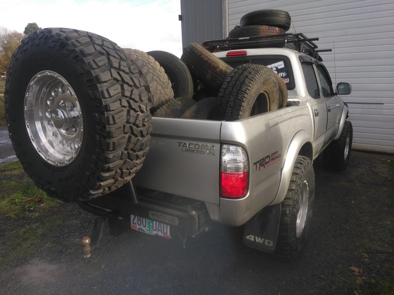

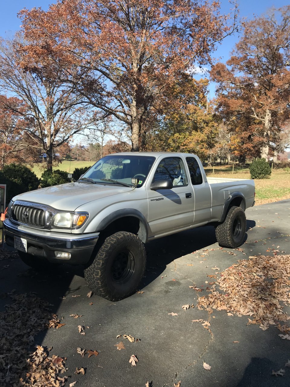

  11. Nov 30, 2018 at 6:25 PM
    HSmith_11
    HSmith_11 Tacoma Enthusiast
    Sep 19, 2016
    #197684
    1,819
    Hunter
    Madison, Va
    2001 Ext Cab SR5 4x4 MT
    5100/OME 881s 1.5" Progressive AAL 33x12.50X15 KO2s
    Here’s what I mean. Also depends on a lot of other variables. 3FB8F972-BBF7-4041-A6F2-42CD79C79691.jpg1FAF223E-A99D-4B5D-B65B-69A00EB26567.jpg

  12. Nov 30, 2018 at 6:30 PM
    Devin19
    Devin19 [OP] Well-Known Member
    May 30, 2017
    #220273
    81
    1997 3.4L Tacoma
    3.4L v6 automatic
    Yeah the silver taco looks clean. Definetaly like the looks of the 8inch wide vs 10inch wide

  15. Nov 30, 2018 at 7:17 PM
    02hilux
    02hilux What do you mean there’s no road, I’m here
    Sep 14, 2016
    #197244
    6,293
    Planet: EARTH
    That red truck is not x10. It look more like x12 the tire sidewall look stretch instead of a small bulge like on a x10.
  16. Nov 30, 2018 at 8:30 PM
    #16
    HSmith_11
    Sep 19, 2016
    #197684
    1,819
    Hunter
    Madison, Va
    I think you’re right cause I know someone with a 15x10s on a ranger and it doesn’t like as wide as that one.
