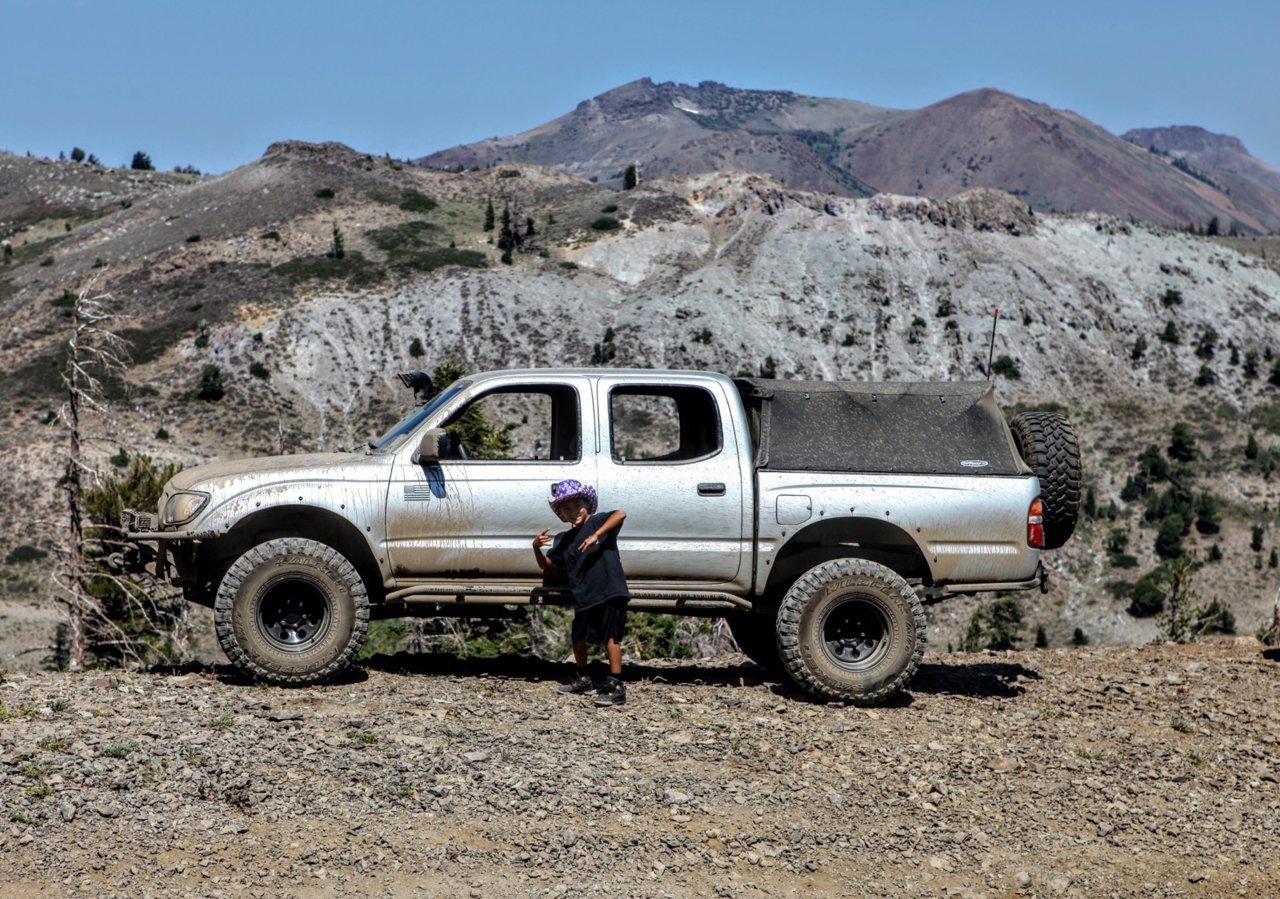

    Bust out a bfh and go to town on the pinch weld area. Im running 15x10s on 35s now. But when i had 33s, i had zero rubbing.
    Here she is on 33x12.5. Same rims.
    I know...she looks odd :p

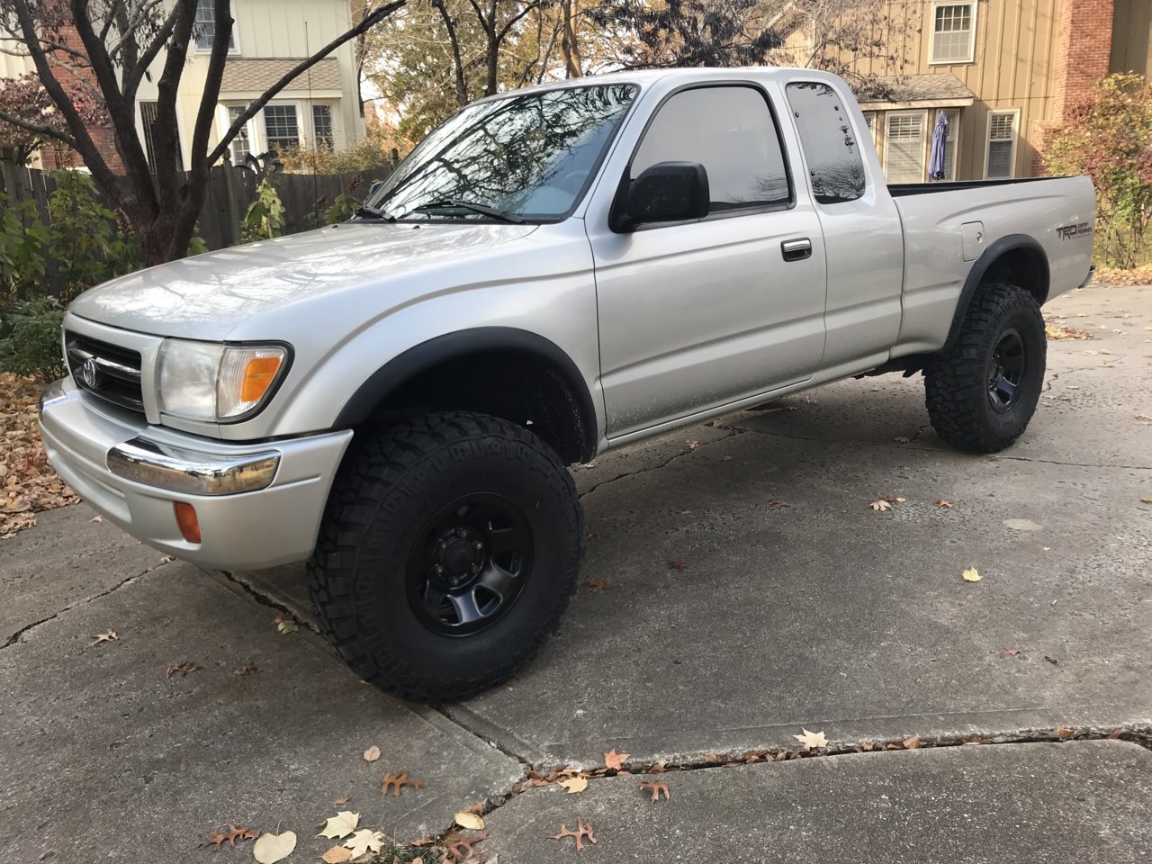

    I run stock 15/7 steel wheels with 33/10.5 tires. Castor is maxed out, I’m still using stock uca’s. No rub at all. That’s with the coil over out and fully compressed.
