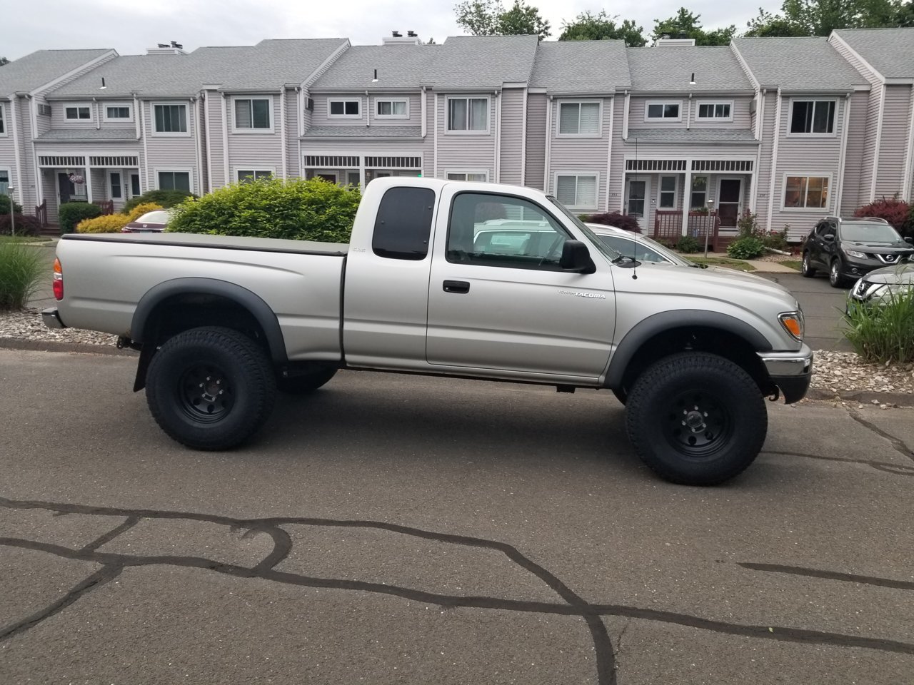

    I started with no spacers and had rubbing. Tried 1.5" spacer and rubbed a bit on the fenders. 1" helped a lot. Wonder what 0.75" spacer would do, but I would need to replace or cut my studs.
    Just got back from the shop and they kicked ass. They got my caster to 3.3ish on both sides and I don't rub at all anymore except in reverse. I'm sure I can get it to rub by extreme driving, but right now I can do u turns again without rubbing.
    I do have to get use to the driving feel. Not sure how I feel about it right now.

  4. Jun 2, 2021 at 5:44 PM
    #44
    Piccup
    Piccup Active Member
    Apr 6, 2021
    #361869
    40
    2004 Tacoma 4x4 ExtraCab
    Alright, finally found a setup that works with 33x12.5x15. Just had to listen to the forum.
    - SPC UCAs set to D position
    - Find a shop willing to set caster to atleast 3.3 degrees. It's doable so if a shop says they can't do it, find another shop.
    - pinch weld mod
    - and a must do, 15x8 wheels with 3.75" of back space
    So far, no rubbing anywhere under normal commuting, u turns, backing up while full lock. I'm sure I can make it rub with enough flex and articulation, but I don't encounter that at all on a daily.20210602_200034.jpg
