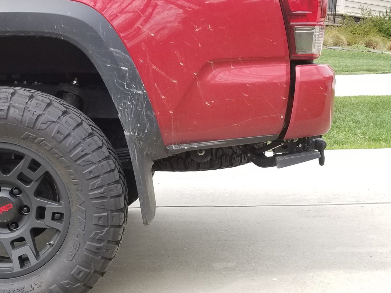

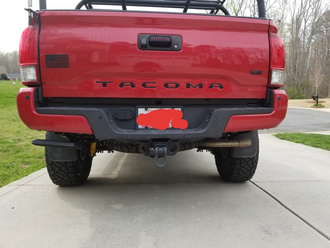

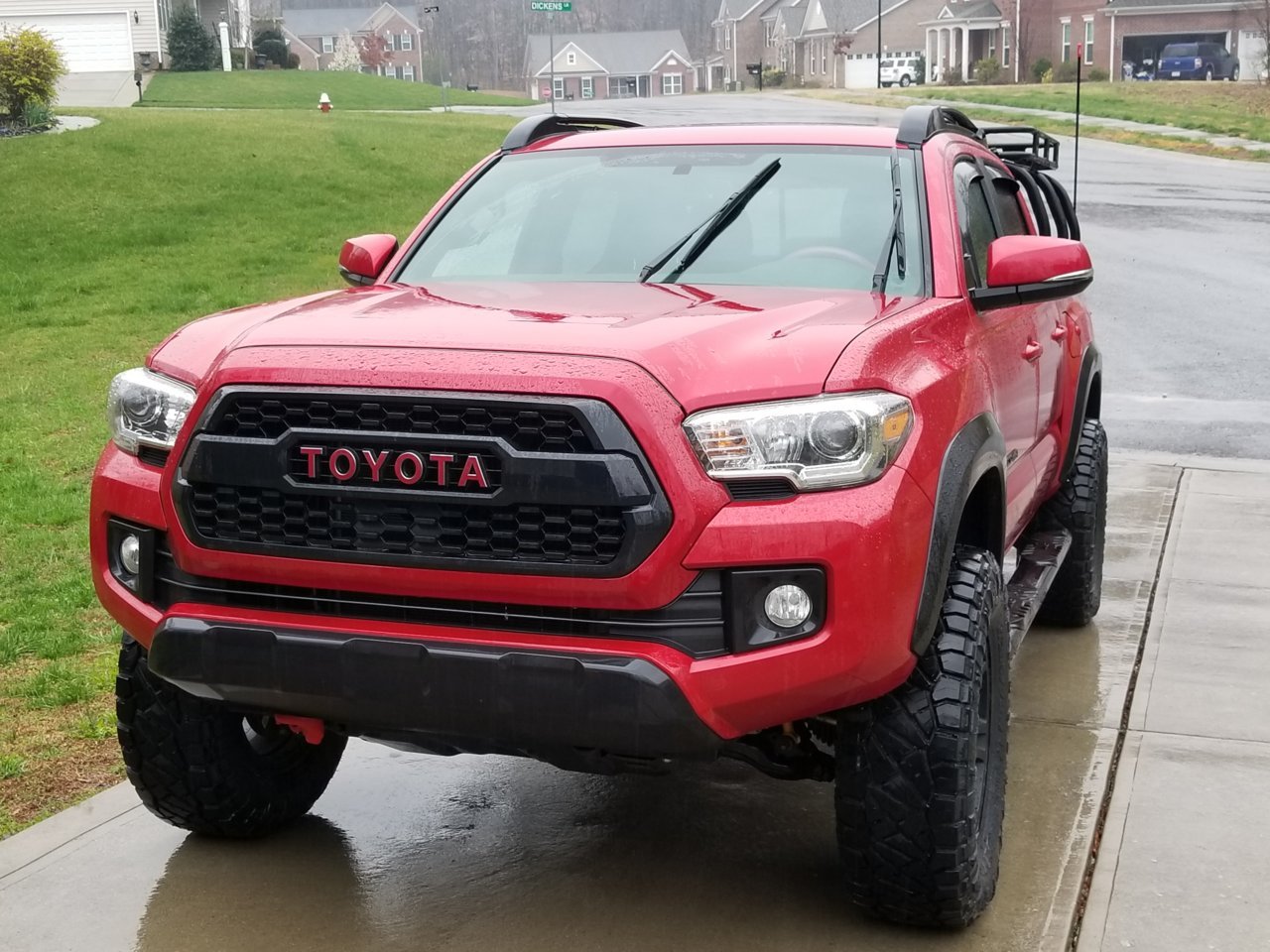

    This mine 285 75 16 Falkens, foto is zoomed in from my porch cause to lazy atm, but it fit with some manipulation as you wind up the chain. I have plenty clearance on the diff and about 1.5” on the exhaust.

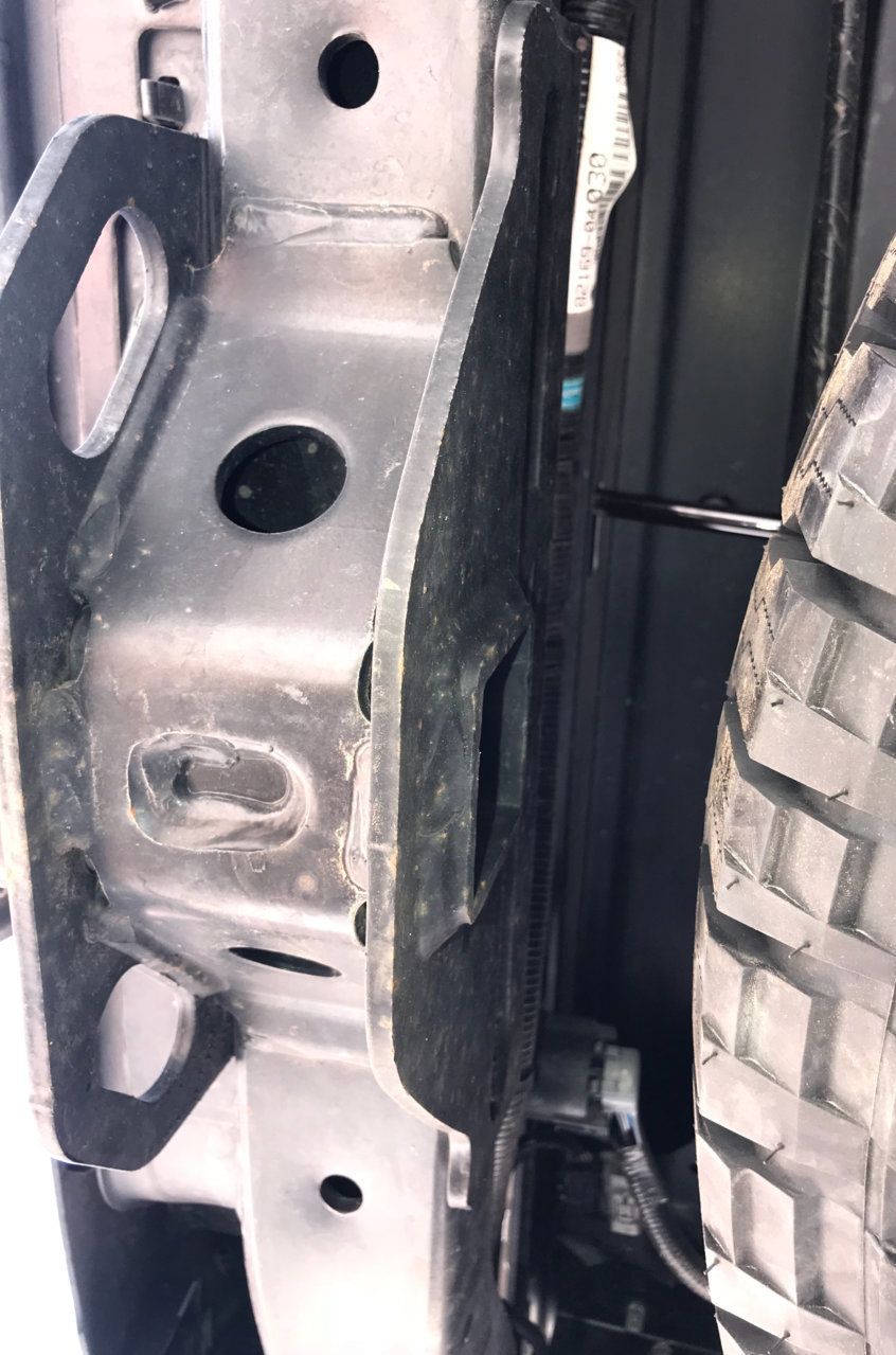

    Did you have to do a cmc with 285s and the spidertrax?
  3. Apr 1, 2018 at 8:26 PM
    #43
    remgu2000
    remgu2000 Keepin' on keepin' on.
    Aug 29, 2016
    #195912
    1,568
    Ray
    Roswell, GA
    Used to have a 2017 Barcelona Red TRD Off-Road DCSB 4x4
    Yes, I did. The spacers cause more rubbing than without so there's no way around it. First time doing anything with an angle grinder. Not hard at all.

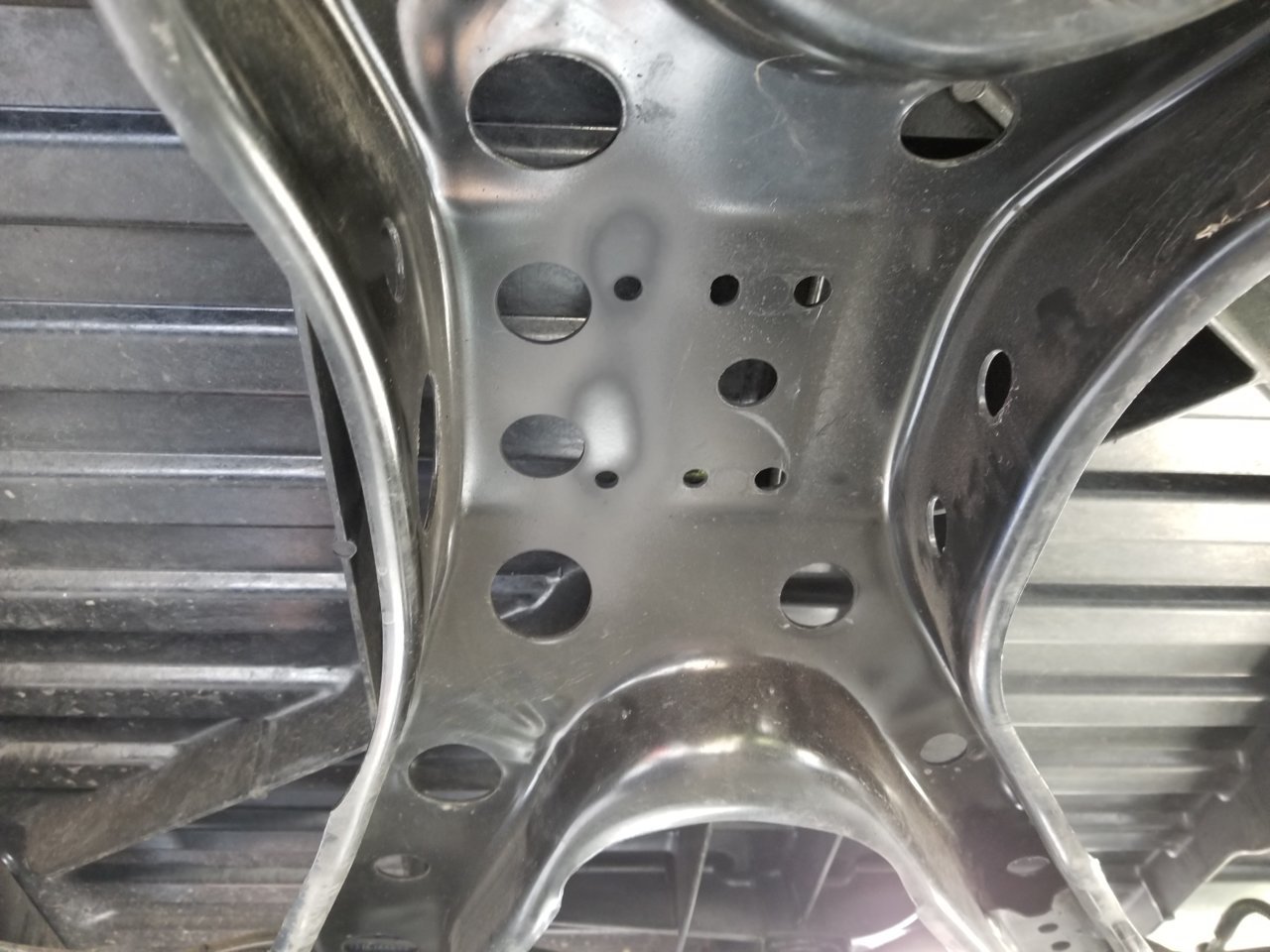

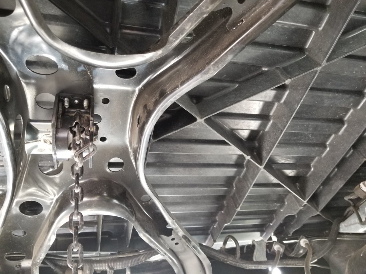

    Ok. Did the spare tire hoist assembly relocation mod. It hoists up fine now but I noticed the tire is a little lower in the back now. My driveway is on a slight incline so I will have to try hoisting it on a level surface and see what it looks like.

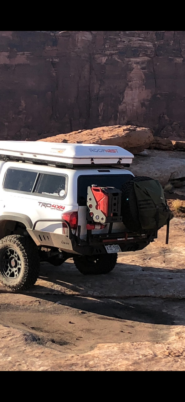

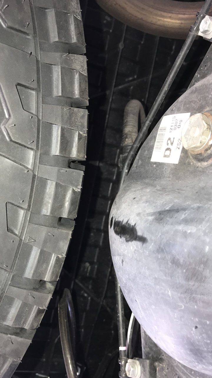

    Like this. 285 70 17. Doesn’t rub diff or exhaust. Or anything for that matter.

  16. Jul 14, 2018 at 12:35 PM
    #56
    Tibetan Nomad
    Tibetan Nomad Well-Known Member
    Dec 9, 2016
    #204436
    903
    2016TRDOR:DCLB:JBL
    NitroGear5.29,B6112,.25"spcr,SPC:UCA,Diff-drop,ECGS
    B5160,Dakar-HD-leaf-pk+OL,UBolt-Flip,33s,Superbumps

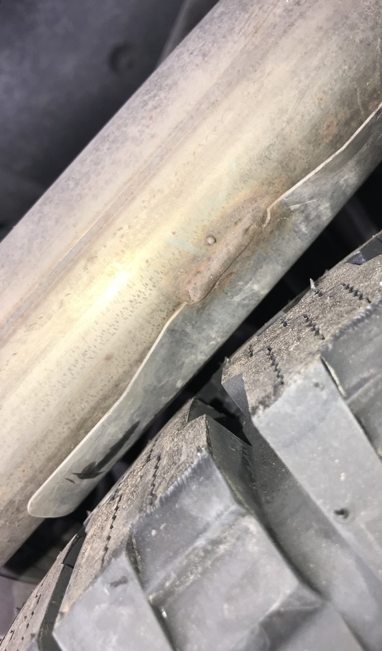

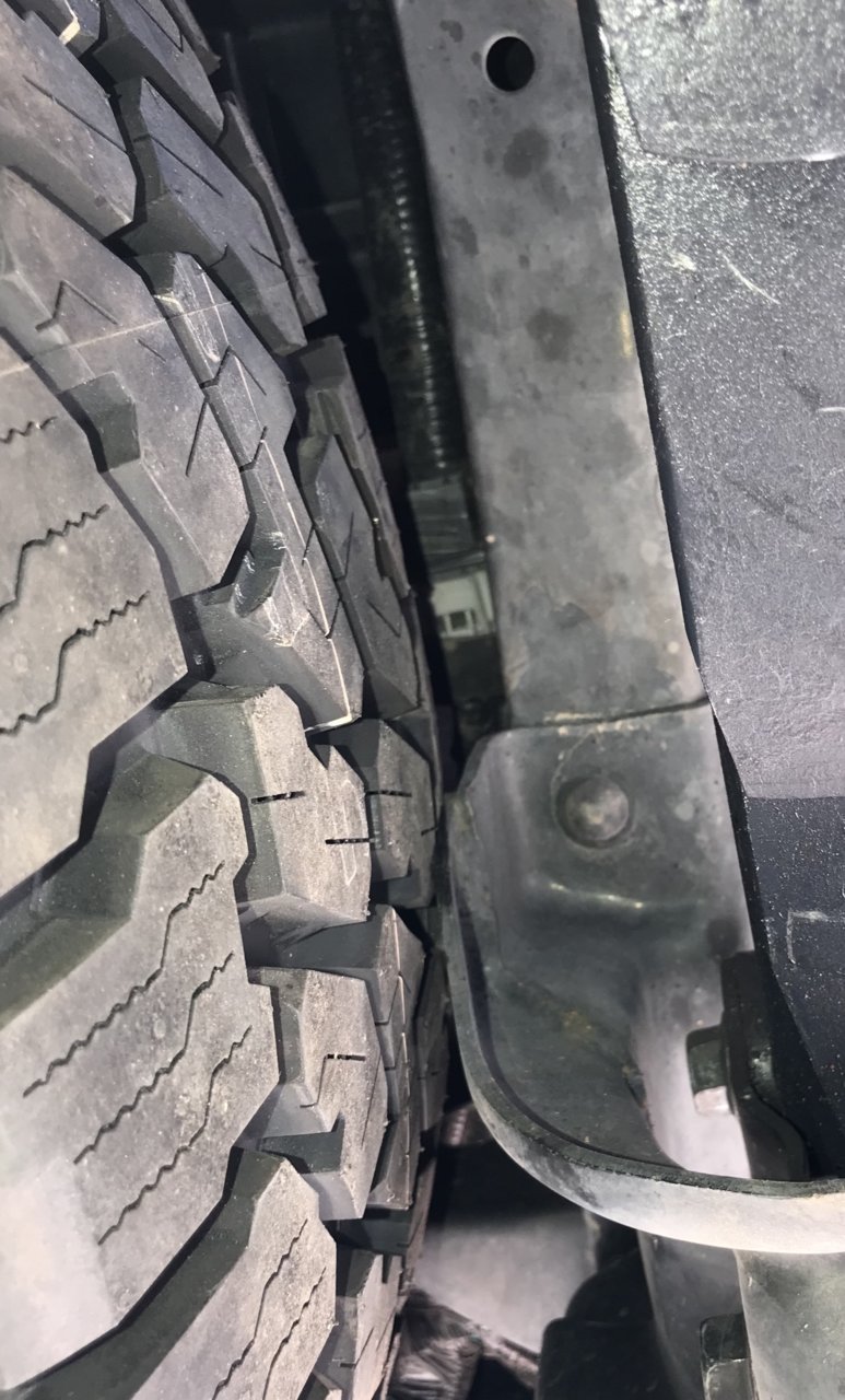

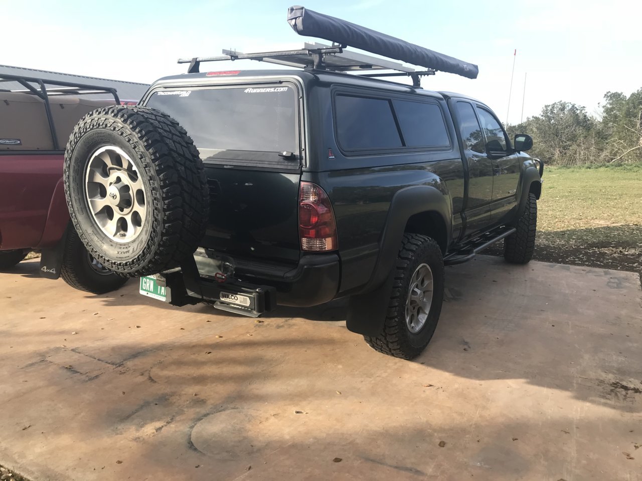

    Finally got the matching tire/wheel as a spare 285/70-17. Just now did my best to fit it in the spare location with Zero modification. I pulled it towards the driver side as it rubbed bad to the exhaust. Don’t have time now but i definitly need to hammer thr guide brackets soon.
    Exhaust side: Way too close even after pulling it towards the driver side.
    Driver side: Yep rubs bad here!
    Diff side:
    Hitch side:
    SilverII and remgu2000 like this.
  17. Jul 14, 2018 at 12:41 PM
    #57
    Joe23
    Joe23 [OP] Canuckistikian
    Oct 5, 2015
    #165909
    11,299
    The Great White North
    2017 TRD Off-road DCSB
    Drop the chain and shift it back about an inch. Helps a lot

  20. Jul 14, 2018 at 2:37 PM
    #60
    Tibetan Nomad
    Dec 9, 2016
    #204436
    903
    2016TRDOR:DCLB:JBL
    Done deal. Much better!
    Now not sure if i still should bother hamering the guide brackets. Looks fine to me as is.
