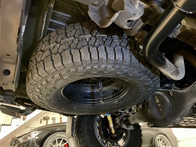

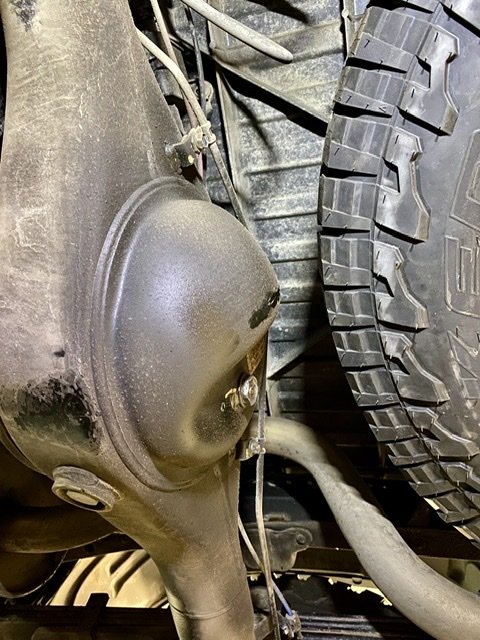

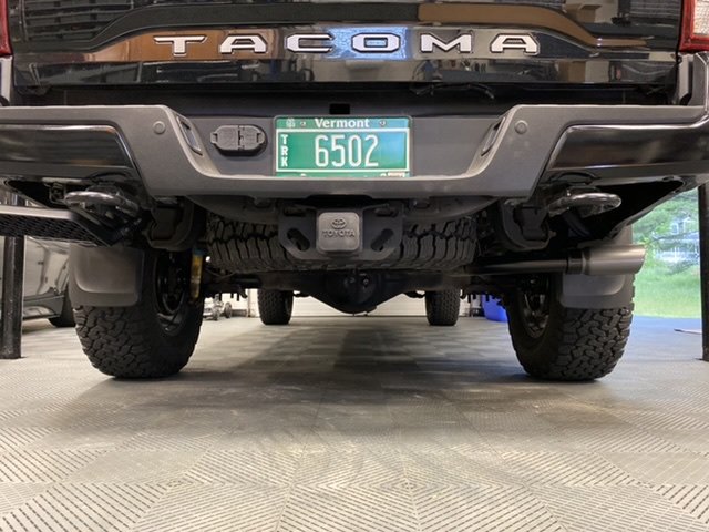

    Another thread revive! I just fit a 285/75/16 Falken Wildpeak on the stock steel spare wheel. I bent back the mounts but left them snug against the tire to not hit the diff.

    I put a 285/70R17 BFG KO2 on a 17x8.5 SCS F5 down there before I got my high clearance bumper. I chopped off the tail pipe (was doing anyways), relocated the hoist, and flattened the guides. If you wanted to keep the tail pipe, you could only flatten the driver side guide and try to pull it to the driver side as you raise it.

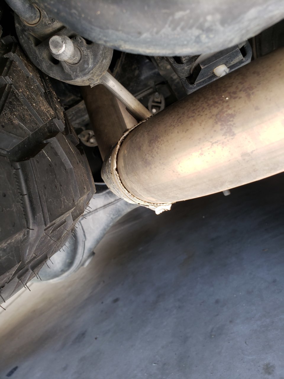

    Any issues with the tire resting against the exhaust hanger? Mine did this and I wasn’t sure if this was alright, so I took the spare out.
    also, I did the relocation and drilled the extra holes.

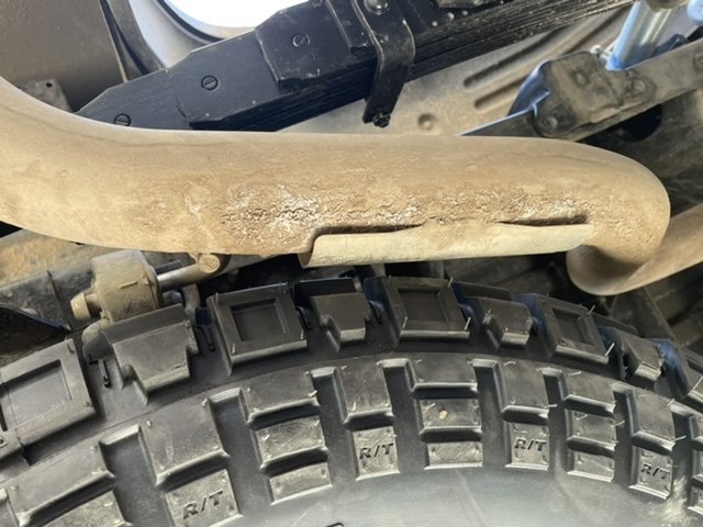

    what’s the verdict on the exhaust hanger?

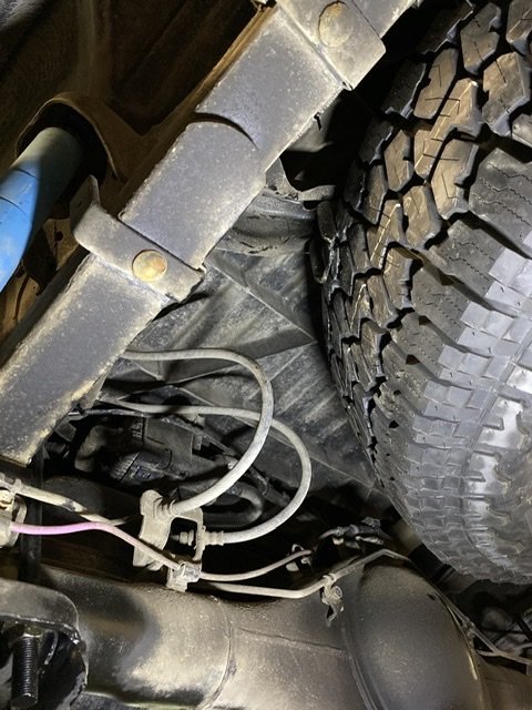

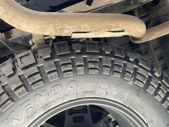

    I relocated my spare today. It’s a 33 x 11.50 Kenda klever.
    it fits, but the tire is hitting the exhaust hanger. On the other side it’s butted up against the leaf spring bracket.
    Can anyone comment on the tire being this close to the exhaust? Ok?

    Kerbouchard!
    Kerbouchard! Well-Known Member
    Jan 9, 2018
    #240760
    522
    Englewood, CO
    fishin' tank
    That looks like about 1/4 inch clearance. Any issues?

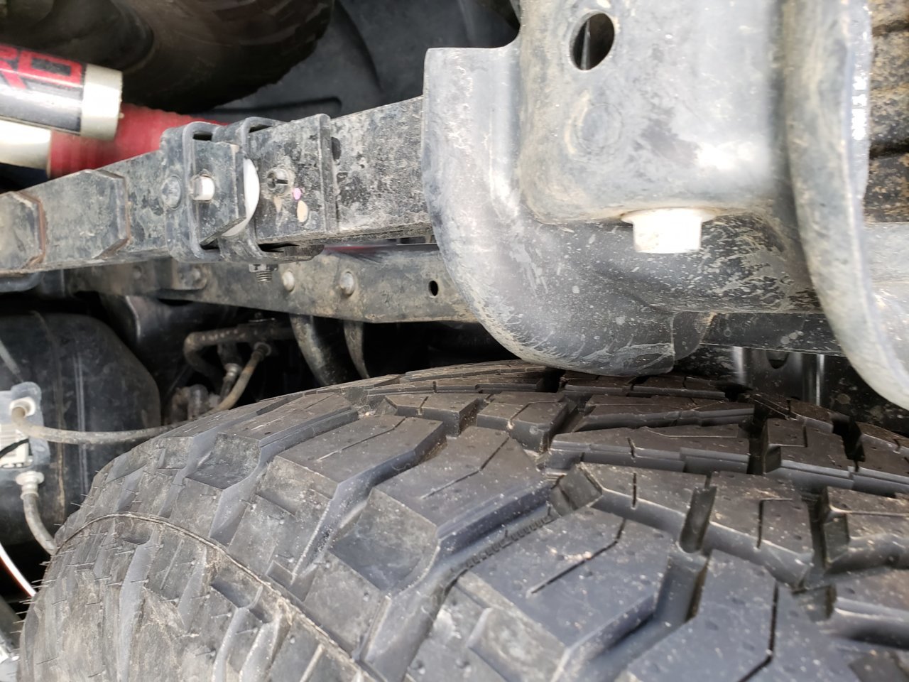

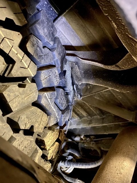

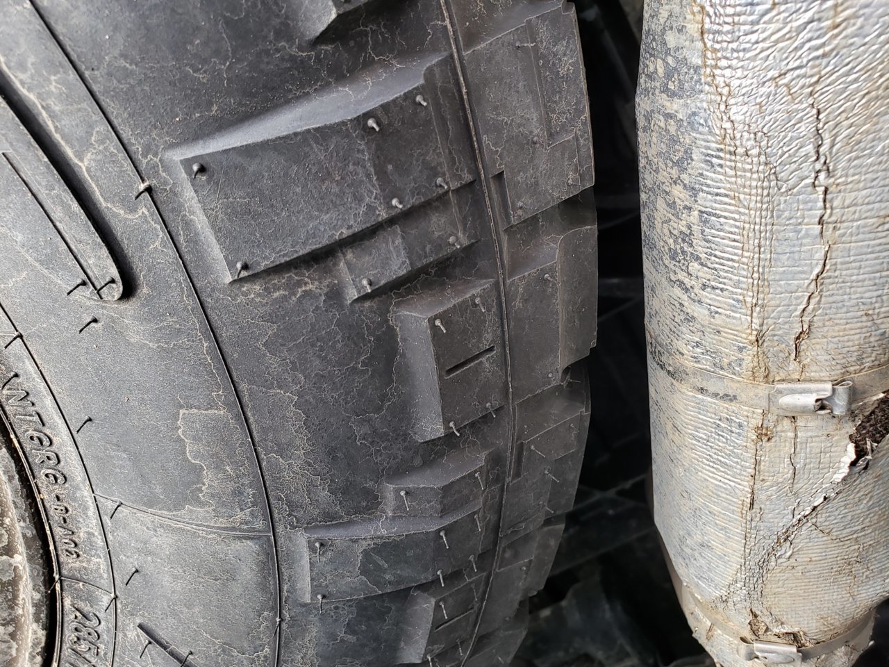

    Here's the clearance I have. Been about 9k miles including last 110 degree summer. No issues.
    Kerbouchard! likes this.

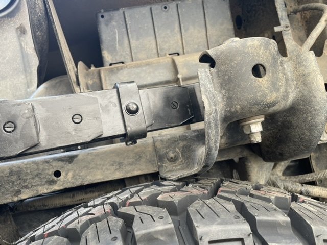

    Perfect. Thanks, dude! Are you bumped up against the leaf spring bracket on the other side?
  12. Apr 2, 2021 at 1:18 PM
    #112
    TacoBoutNothing
    TacoBoutNothing Well-Known Member
    Jan 14, 2020
    #316067
    106
    2019 White TRD Pro
    All up on it. Hasn't hurt a thing.

    If you’re worried you could get the heating insulation and wrap that part of your exhaust to protect your tire.
    It has the yellow fibreglass mated to a tinfoil.

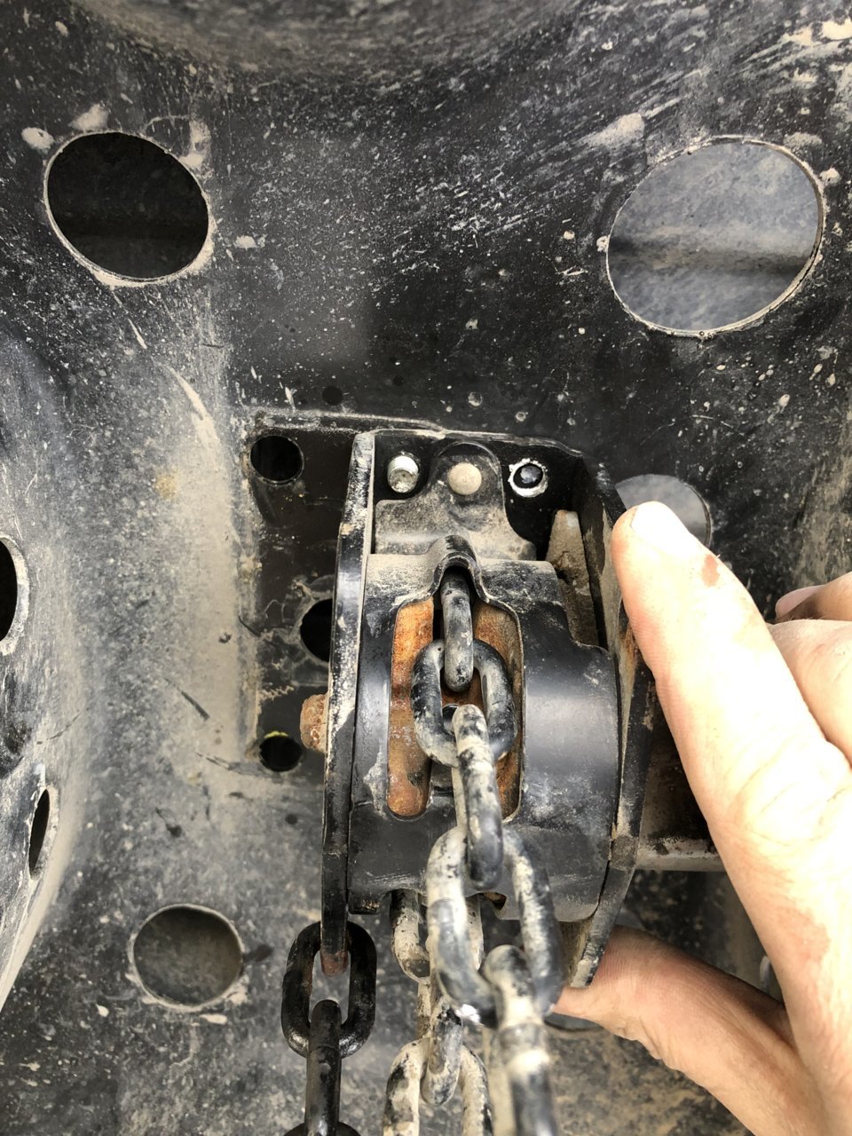

    I redrilled the cross member and put the hoist a little further back. Better clearance that way but definitely took longer than 5 minutes. More like 30

    How did you get to the nuts on the cross member and what size socket? Man I had a hard time getting to them.
