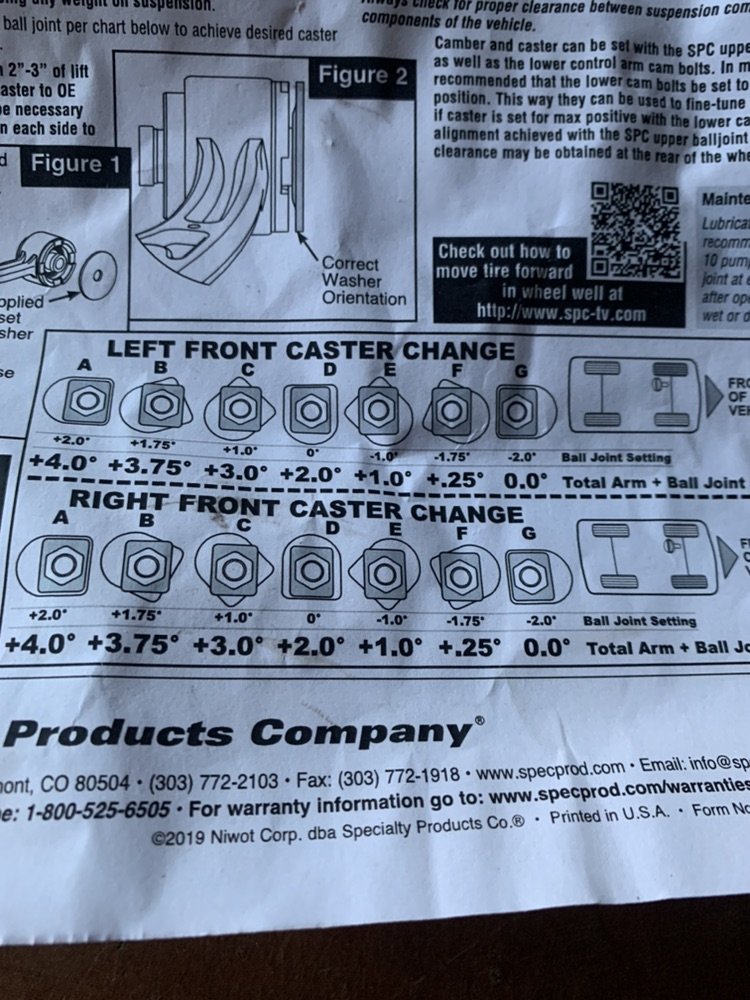

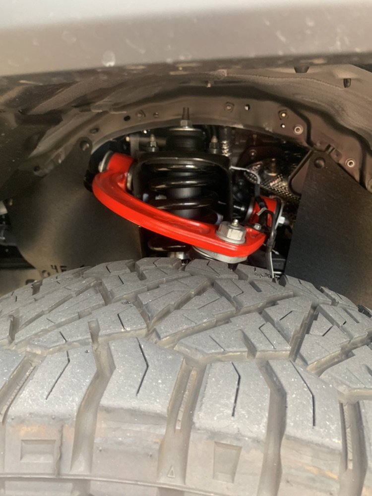

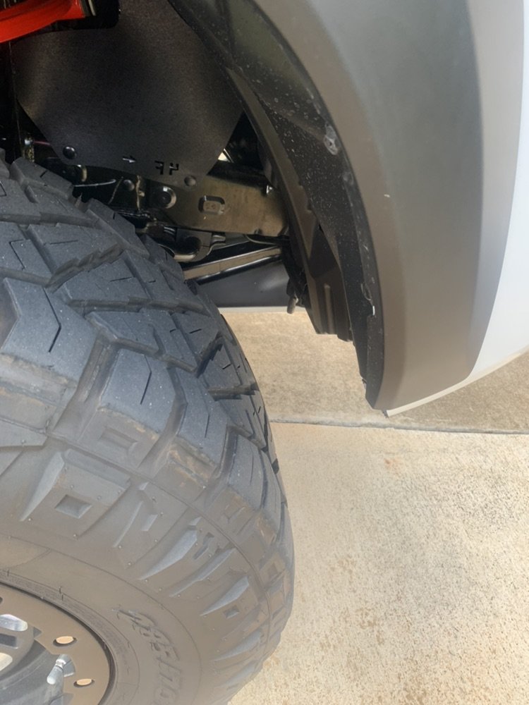

    Got my truck fully dialed within all factory Specs. I'm running 285/70R17 Ridge Grapplers on 17x9 Procomp with 4.75" BS. (I only have 2" lift Bilstein 5100 with OME 887 coils.)
    Set my SPC UCA's to setting "F" and had my local alignment shop set my Caster to 2.5* and my Caber to approx. 0*. Sat setting "E" @ 1.8* Caster I had very slight rubbing while reversing and turning.
    But now that I'm at setting "F" and set to 2.8* Caster there is full clearance of the cab mounts.

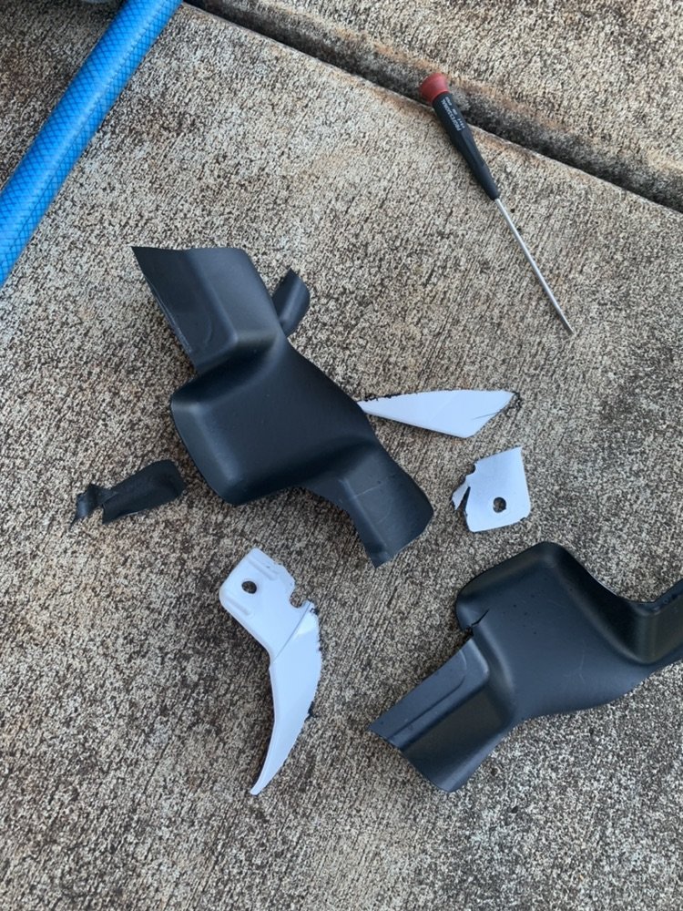

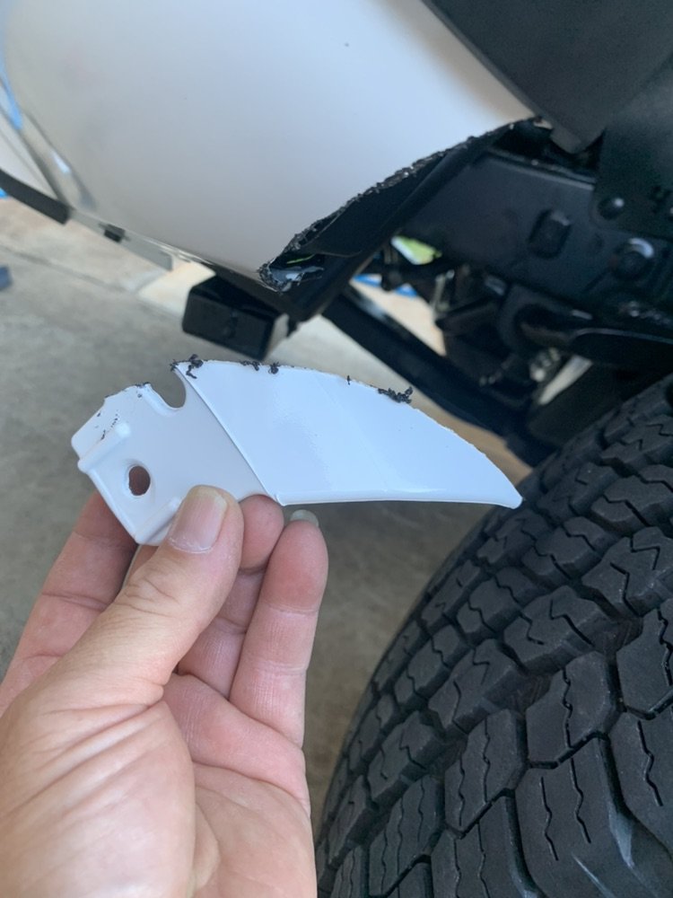

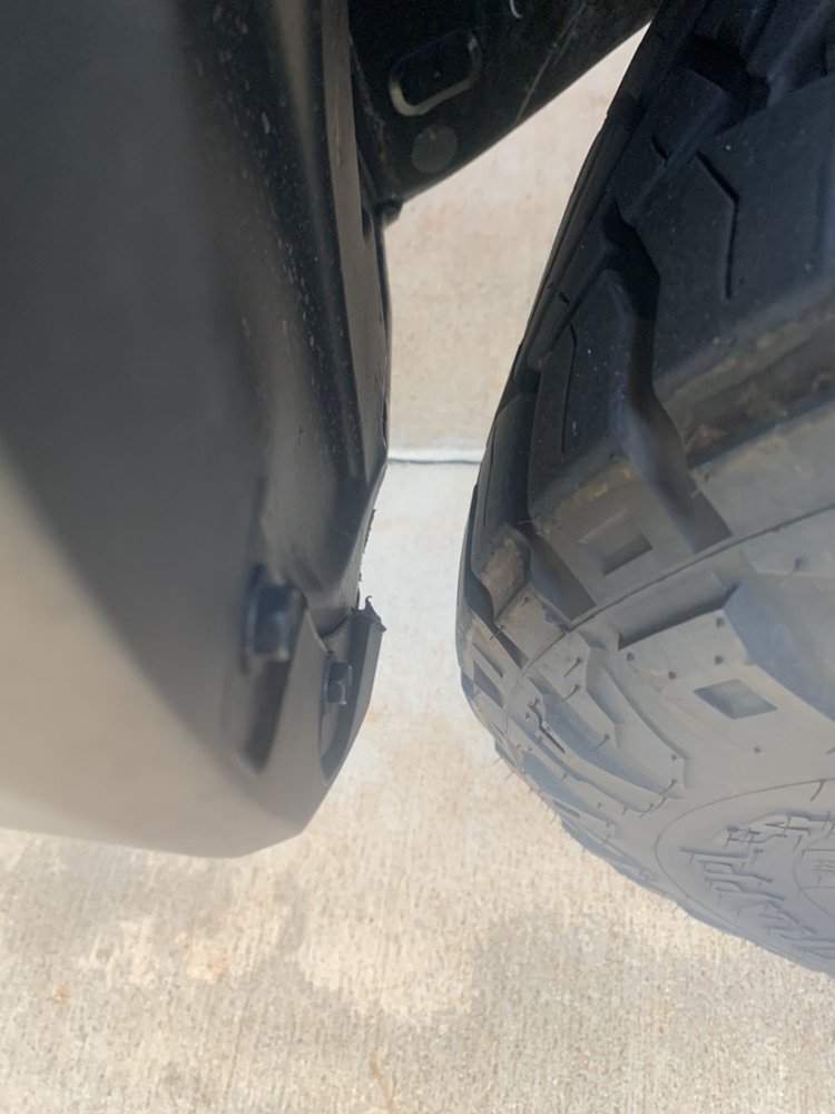

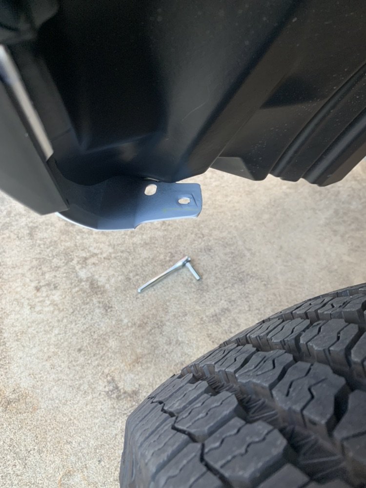

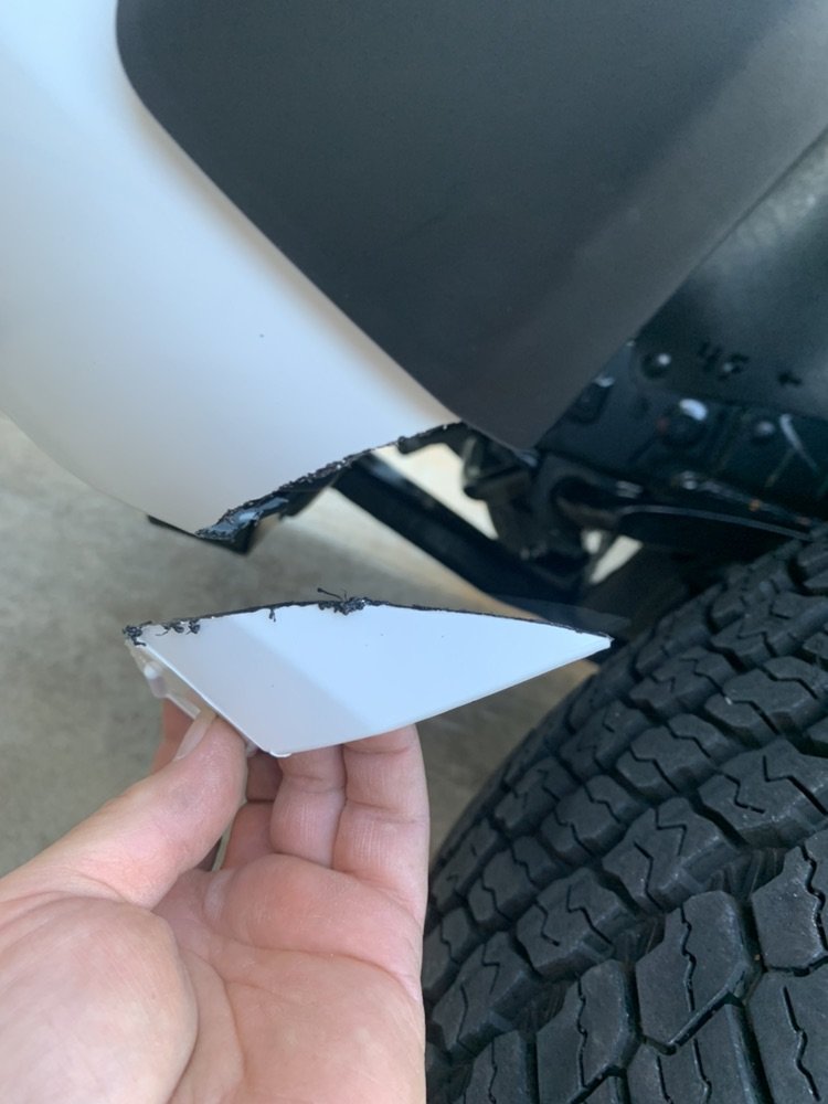

    Th only thing was that I needed to move the front fender liner forward about 3". But that was easily done with minimal cutting of some plastic.
    The good thing is that I could still go to setting "G" and move the tire forward even more to get additional clearance if needed.
    These are not my permanent set of wheels and tires. (I'm currently waiting for them to come in).
    But just to let people know that it is possible to fit 33" tires without a CMC.
    The main reason that most people need to do a CMC is because the aftermarket UCA addd CASTER. Which moves your tire towards the cab mount.
    With the SPC UCA you can move the CAMBER to allow the correct Caster.
    I'm sorry I should have done a proper write up on this. But I attached some pictures of the amount I needed to trim from the front fender.

    Actually those are SPC, I think he got them custom painted. He has another thread that shows them before he installed it

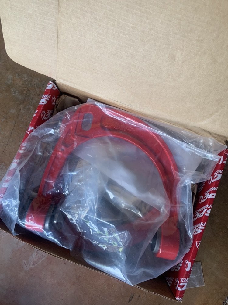

    They are SPC UCAs painted red. You can take a look at the links in my sig. to see things about lifts and alignment

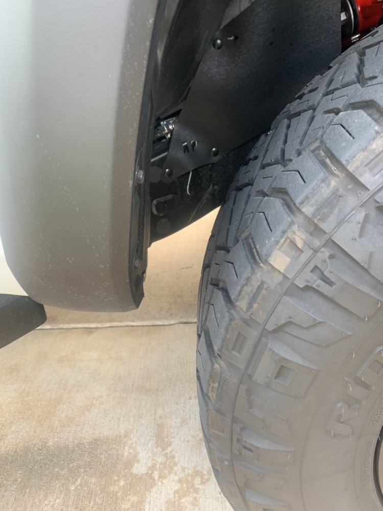

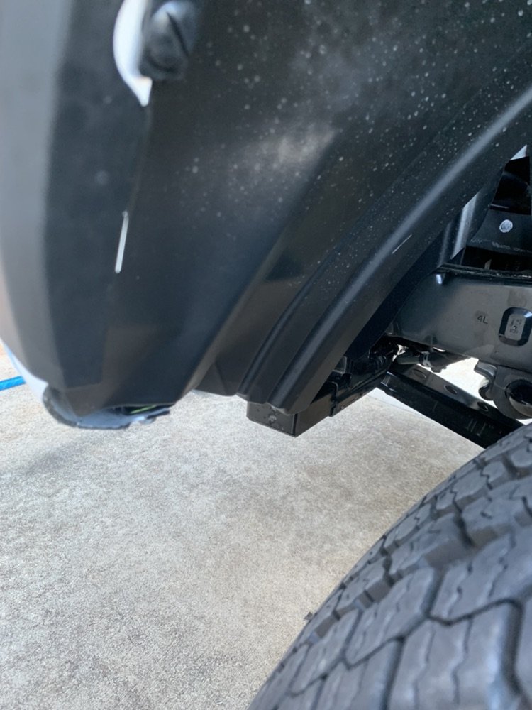

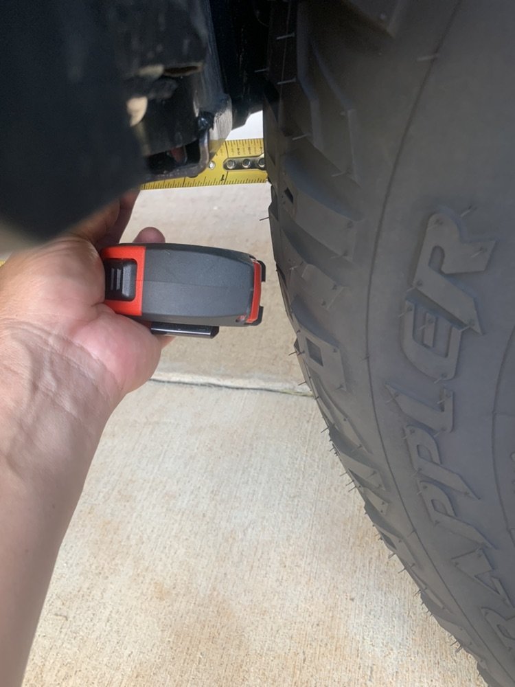

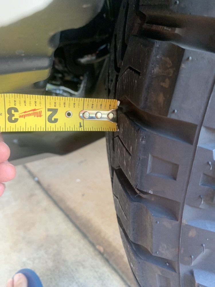

    At full lock I have about 1" of clearance from the cab mounts.
    Front has about 2" from the front fender liner.
    Half turn there is still adequate room for tire articulation.
    SPC UCA's.

    They shouldn't because that is measuring the furthest part of the tire. The 33" tires should have full articulation with out rub.
    Sorry I for got to post the adjustment sheet:
    .jpg
