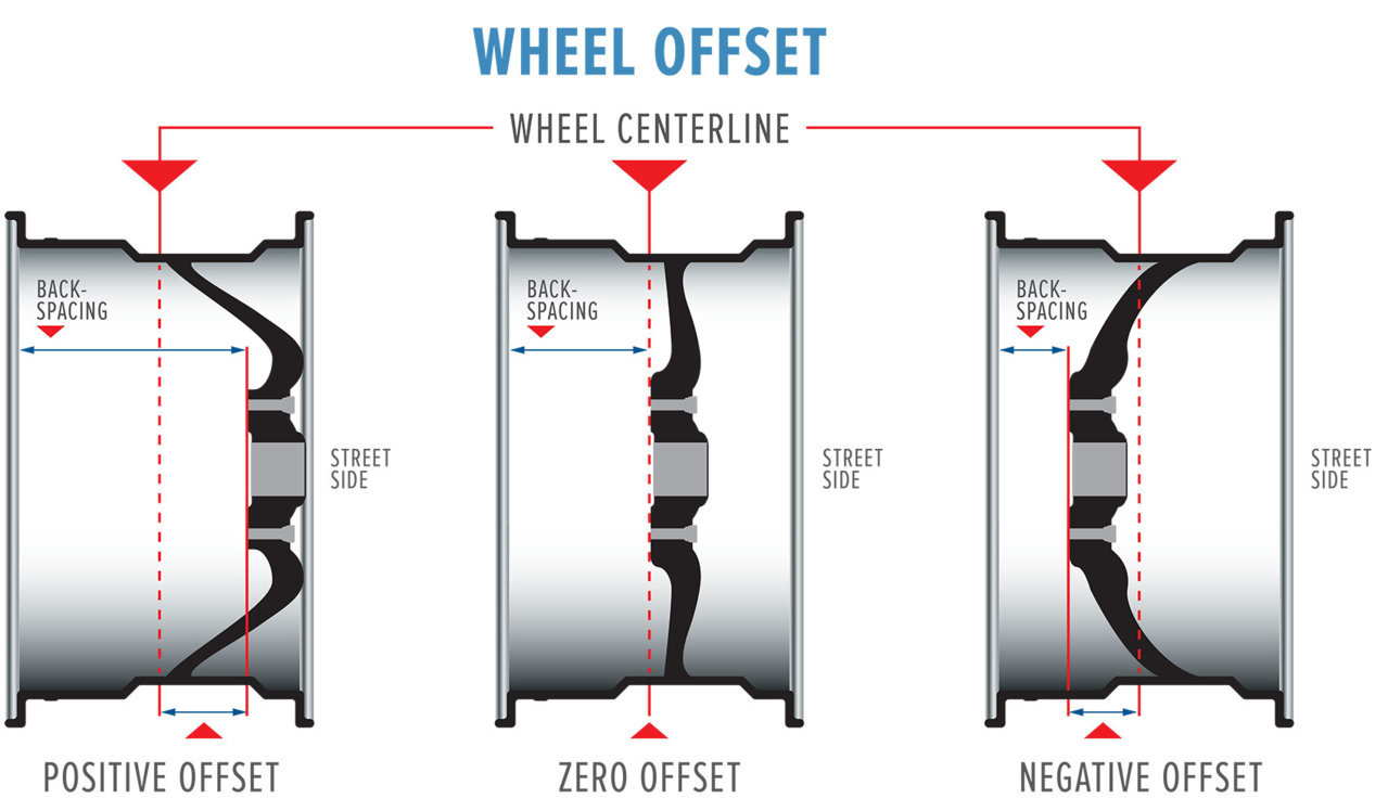

  9. Jul 29, 2021 at 12:05 PM
    #29
    skeletron
    skeletron Disgraced Member
    Dec 2, 2020
    #348476
    2,180
    Clark
    Sakerlina
    2020 TRD Broh
    Offset and backspacing are related but will change as the wheel is wider or narrower.
    HoytK9 likes this.
  10. Jul 29, 2021 at 12:18 PM
    #30
    HoytK9
    HoytK9 Well-Known Member
    Jul 6, 2020
    #333632
    205
    Voodoo Blue 2019 TRD Pro
    Snug Top Hi-Liner
    So if I understand this correctly- negative offset gives the appearance of a wider stance, but the trade off is rubbing issues. I opted for zero offset for this reason.
  11. Jul 29, 2021 at 12:26 PM
    #31
    skeletron
    Dec 2, 2020
    #348476
    2,180
    Clark
    Sakerlina
    2020 TRD Broh
    Zero offset is still .5" further out than your stock TRD Pro wheels which are +12
    HoytK9[QUOTED] likes this.
  12. Jul 29, 2021 at 12:26 PM

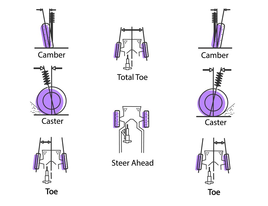

  18. Jul 29, 2021 at 12:54 PM
    #38
    skeletron
    Dec 2, 2020
    #348476
    2,180
    Clark
    Sakerlina
    2020 TRD Broh
    SPC UCAs (or other caster-correcting UCAs) could help your cause along with a good alignment that gets your caster maxed out and moves your wheels forward
    edit for clarity:F2AF391D-C17A-4477-9734-DEF22B91AE9A.jpg

    jdl1681
    jdl1681 Active Member
    Aug 21, 2020
    #338428
    25
    Its really gonna depend on your wheel offset with my pro wheels I didnt need a chop but when I moved to my trail lites I did.
