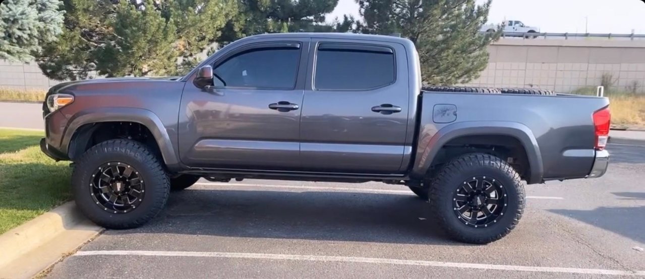

    HERE SHE IS!!!!!!!
    Had to do a BMC tho, but she looks good!

    Stance looks great
