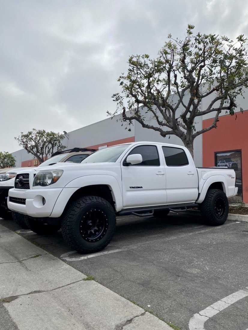

  6. Dec 2, 2021 at 7:34 AM
    #66
    Tac11
    Tac11 Well-Known Member
    Mar 15, 2016
    #181370
    301
    Luis
    2011 white Tacoma sport TRD
    3" Front lift OME/5100 set at 0, 1/4 spacer on driver side CMC, BFG 285's, SCS ray 10’s -38 offset 1 inch rear block N-Fab steps Bumper Cali Raised LED light bar Cali Raised LED fog lights After market exhaust, and muffler tip Redline hood struts Tacoma Bed-liner mat Tailgate lock Tinted windows 20% HID headlights Short antenna Clazzio Seat covers Joying head unit
    I have 285/70/17 on sport rims and just needed spacers to not hit UCA. I'm getting a CMC today to install my -38 scs today :cool:ill post pics
  7. Dec 4, 2021 at 1:13 PM
    #67
    Tac11
    Mar 15, 2016
    #181370
    301
    Luis
    285/70/17 -38 offset
