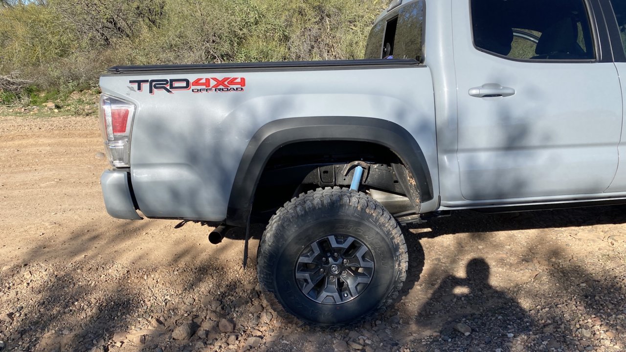

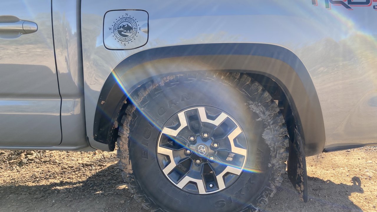

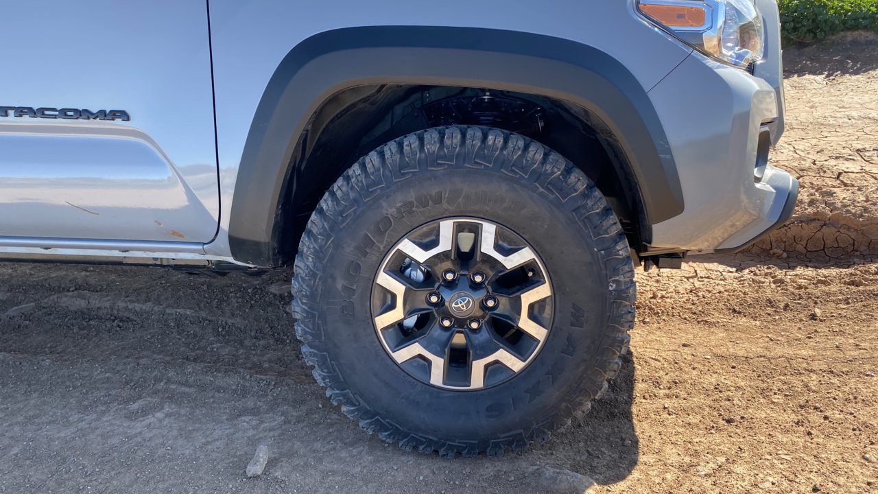

    I was able to fit 33s (255/85/16) on my stock OR with NO lift. Just had to trim the fender a bit as they did rub when fully articulated

    Do you have a pic of that? What brand/model of tire?

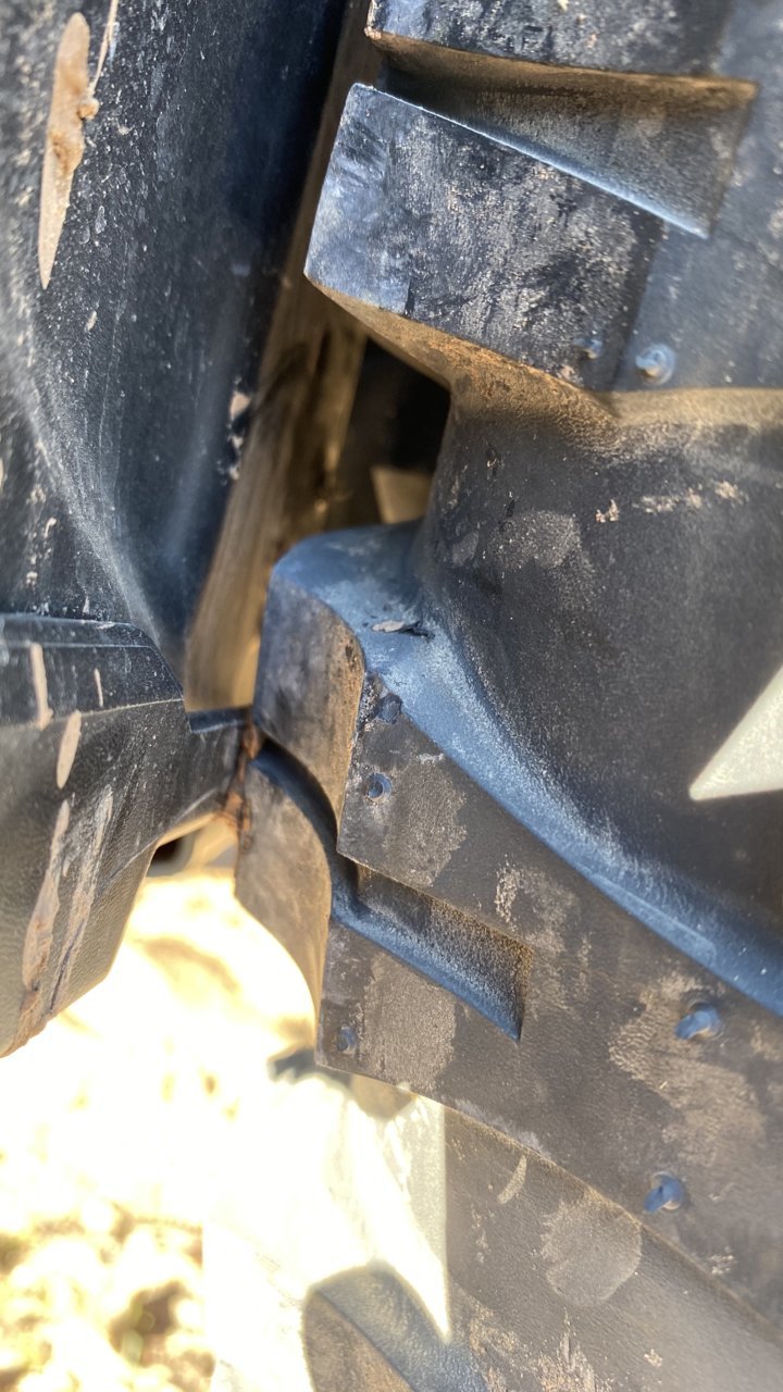

    Can you show where you had to trim? Or was it just remove the mudflaps?

    I just had to trim the small area in the red box. To determine if there was anymore rubbing i chalked the inside of the fender to see if it got worn off on the trail. So far no more rubbing

    What was your method of trimming ... Blade, sand paper, or dremel? I’ve got a slight rub on the front lt when turning rt after putting on 265/75/16s.

    I just turned the tire out of the way and used some metal snips to snip off that corner. Took like 2 mins each side
