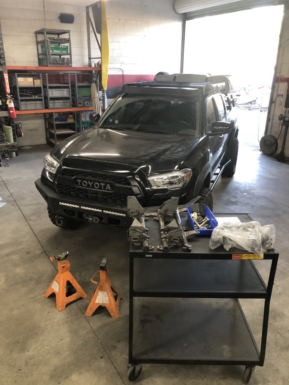

    Doing the first ever 3rd gen LCA kit today for a very patient customer

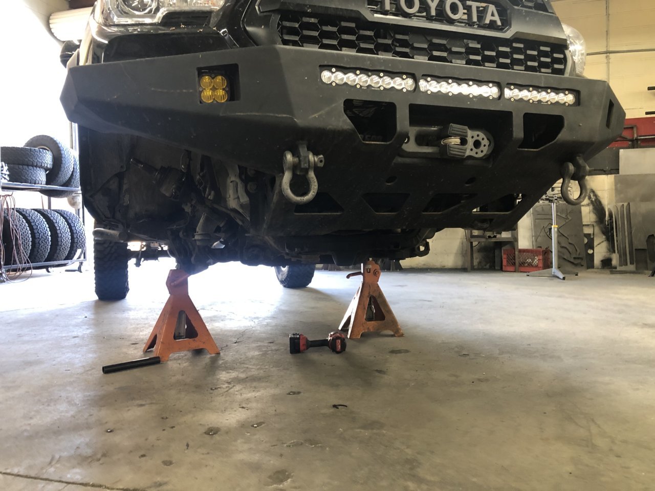

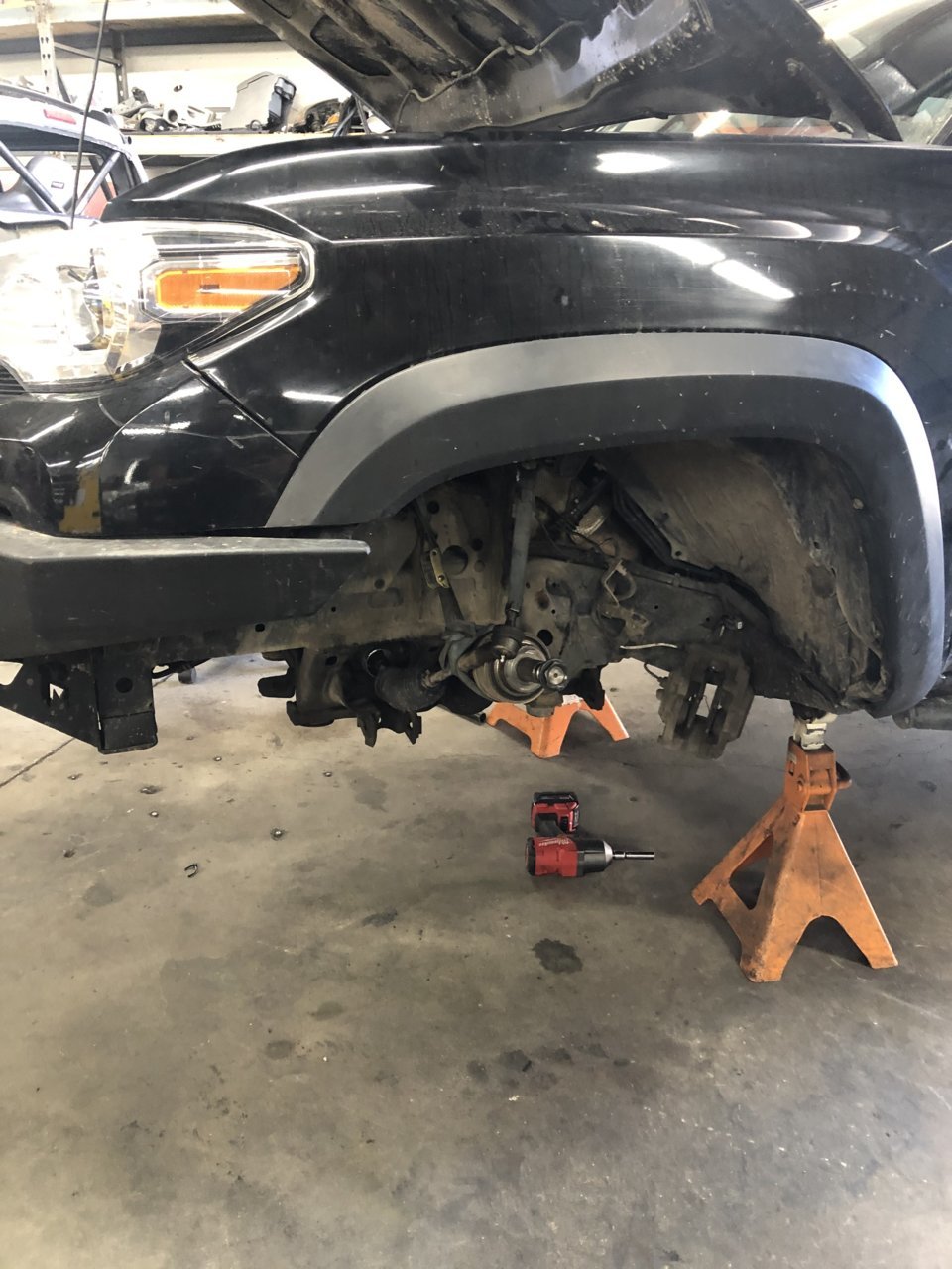

    I love how fast and easy these trucks come apart
    freddy2923 and DesertRatliff like this.
  5. Aug 12, 2020 at 9:32 AM
    #1985
    Dirk Diggler
    Dirk Diggler Under the Stun Gun
    May 30, 2017
    #220314
    3,550
    Columbus, GA
    2017 MGM OR DCSB
    Maybe you're just fast at it. Pretty sure I'd still be trying to get the tools needed together

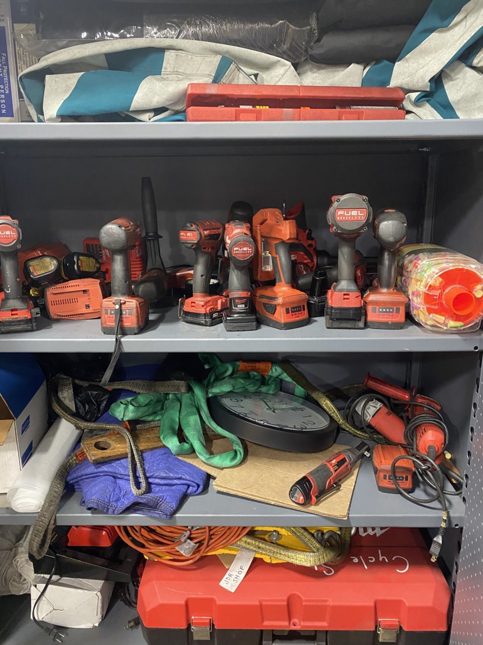

    This is the secret... 1/2 impact, stuff comes apart so fast

    that one, hackzall, and power ratchet (55lbft) are game changing for this kinda stuff. their cordless angle grinder is garbage, not enough ripums.

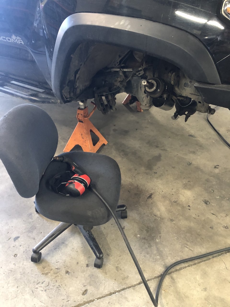

    Old office chairs are your friends too

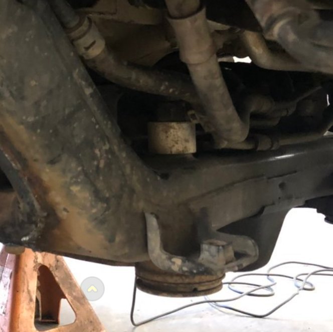

    Lol is this a diff drop spacer, but on the wrong side of the frame?

    I don’t know anything about it, showed up like this

    It typically gets sandwiched between the frame and the two front diff mounting legs to attempt to help with CV angles. It's ineffective, but this takes the cake.

    That’s my truck, previous owner had a diff drop kit on it with the longer bolts but I don’t find a need for it so I just put the spacer on the other side to get my clearance back.

    That's certainly one way to do it. I would've put the correct length bolts back in.
