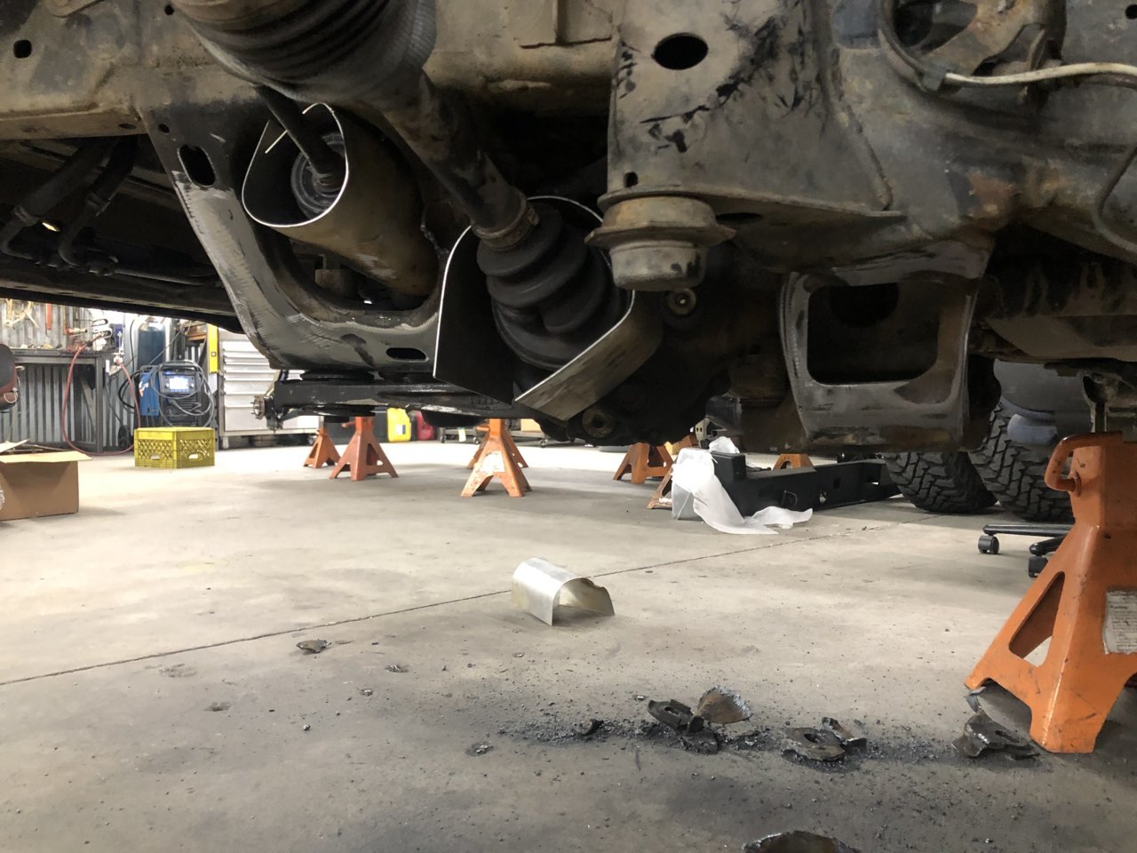

    All cleaned up, time to notch the bump stops and get the LCA installed

    What is that you wrapped around the cv/tie rod to protect the boots, just sheet metal?

    Yep just some thin sheet metal

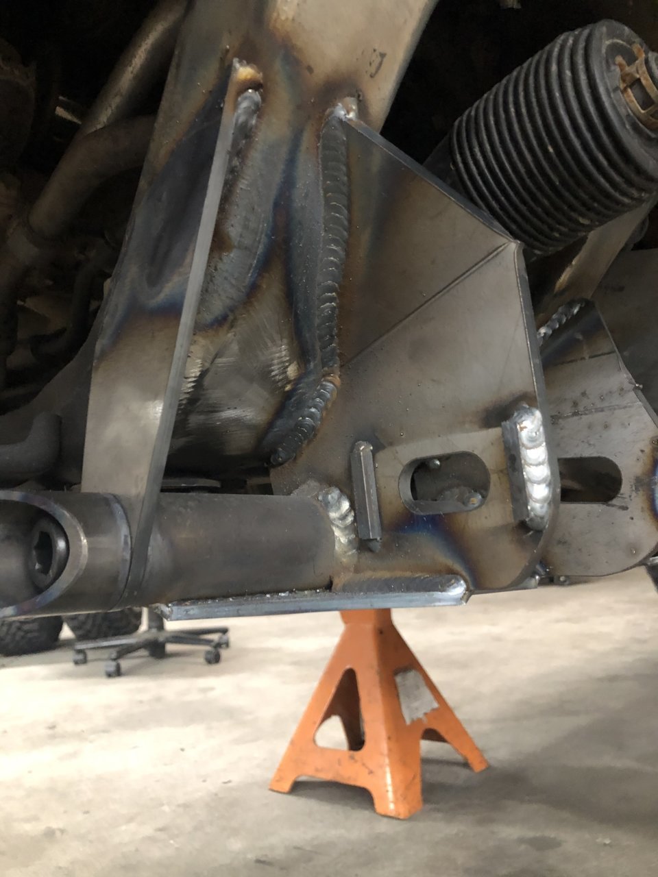

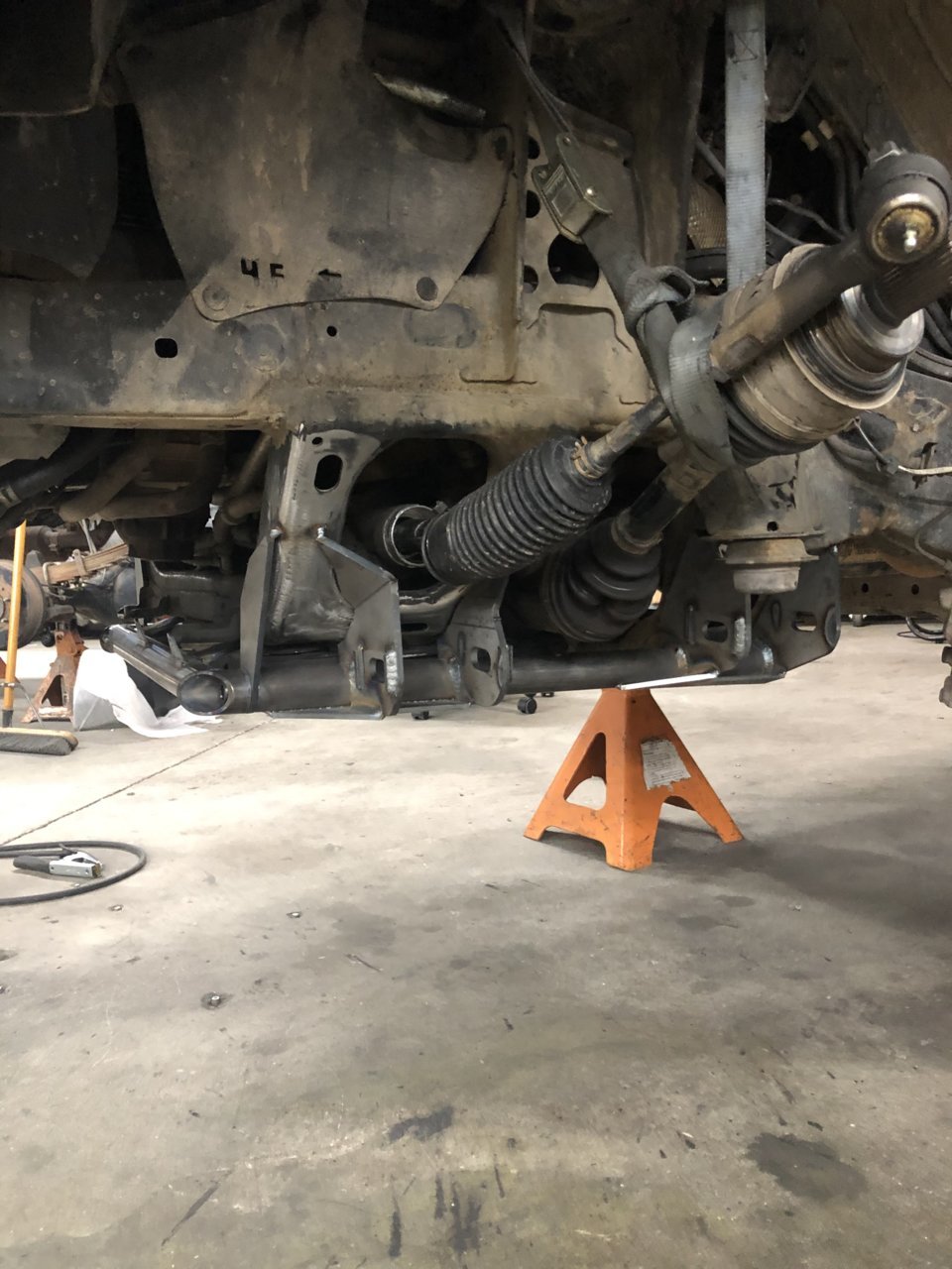

    Got the sub frame tacked in. Fit perfect... this kit is now 100% 3rd gen approves

    All burned in...

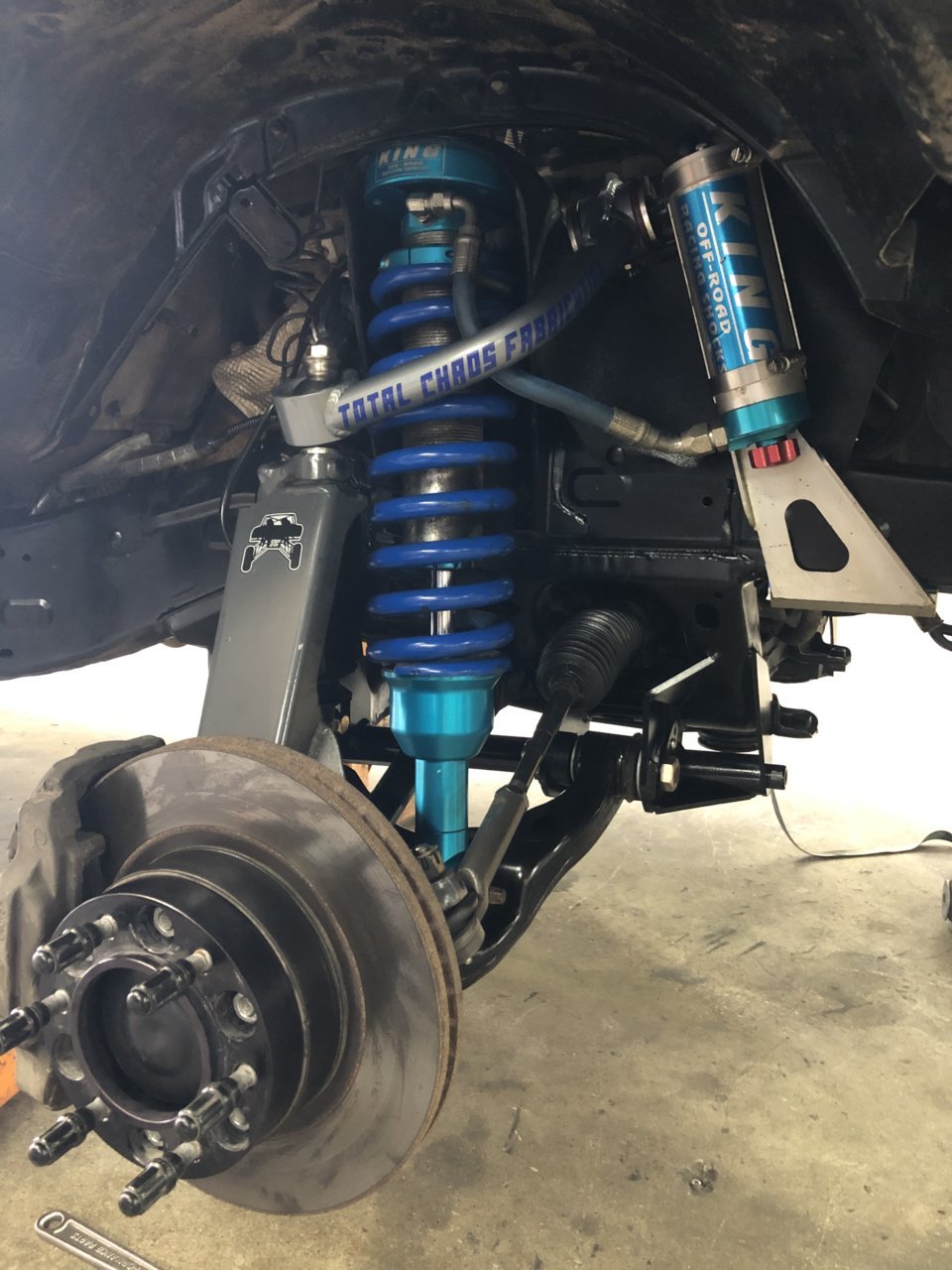

    Got one side all cleaned and buttoned up

    Does the spindle gusset not clear the rotor guard?
  17. Aug 13, 2020 at 11:02 AM
    #2017
    EatSleepTacos
    Mar 24, 2015
    #151688
    59,835
    Randy
    West Valley, AZ
    2017 4Runner
    Not the total chaos ones. You have to trim a little bit of it so it doesn't rub.

    Truck has chaos spindles and I have no idea about clearance. I will say i throw those things in the trash as they just cause issues off road

    I worry about hitting road debris or something to cause the outer boot to sling grease, then gets all over the unprotected rotor. There goes your brakes. That's the only reason I still have mine on.

    I have the chaos fab ones (sway bar version tho I don’t run one) and chucked my rotor guards because they interfered. I thought these here were the JDFab spindles, hence the question, so nevermind, I guess
